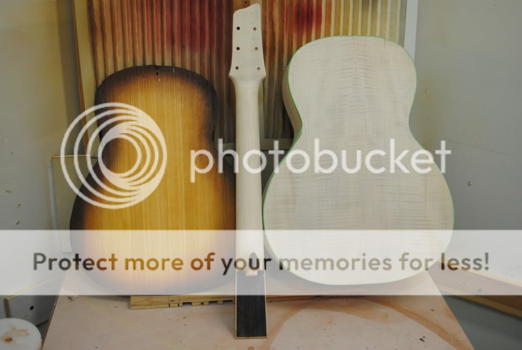

Getting closer
this is the practice board after four or five tries.
First tried with hvlp gun. Too cumbersome and couldn't control it.
Then went to air brush, figured out pressure and air-dye mix.
I kept adding black and going around the edge but I think it got too black. When I do the real thing, I'll just keep making it browner and browner.

I have only done one, & was pretty nervous about getting the colour on evenly. I did a bunch of playing around, spraying guitar shaped cardboard & wasn't happy with the results. Until... I screwed a lazy susan to the bottom of an old 24" dish & laid a cardboard "guitar top" on it. Spinning the "guitar" (slowly) & adjusting the angle of spray I got the feel of it pretty quickly.
When I finally tried the method on a real guitar, it worked great.
I thinned the nitro about 30%. It flashed off so quickly, I was able to keep turning & spraying for five or six full turns without stopping. I waited a couple of hours & did another similar application & it was done.
Scraping the bindings was way more stressful than the actual spraying.
It was actually fun & I've been looking forward to another customer wanting a burst.
Make sure to wipe the nozzle tip before starting to spray. If there is a drop of finish hanging on the tip, it will leave darker spots in your burst.
I like to start the spray pointing the gun away from the instrument to establish a clean spray pattern before the finish touches the workpiece.

Yo, Dave, it looks to me like you're doing pretty well there--just a matter of getting the width of your pattern and the depth of your colors down to your own satisfaction. Keep on keepin' on.

Looks like you did real good Dave! I like to have a little wider shade around the edge leaving a smaller golden center but it's all about personal preference. Mine usually more resemble a Gibson style burst and e upper bout is pretty much all shaded but very nice job. Next time you'll have greater confidence and experience. Bravo!

I agree, the shaded area needs to be wider.
What do you all prefer for the sides and neck? Do you leave the high spots (direct back of neck, outermost area of bouts) dark or light? or on the sides do you like to burst the center all the way around with dark nearest the binding all the way around?

You're trying to get a 3D effect with light/dark, so IMO I think highs (bout extremities, plate centers, back of neck on c'line) light and hollows (plate edges, heel, waist, tail, volute, neck sides) dark is proper.
