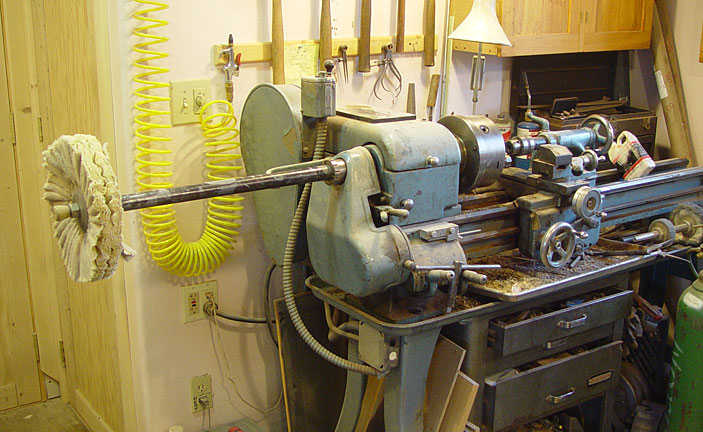

Here's mine. It's a bit unconventional but if you happen to have a large metal lathe hanging around the shop it's an easy way to make a buffer. The wheel is mounted on the end of a piece of 1 1/4" pipe. The other end of the pipe is clamped in the chuck. When I'm not using it, I just loosen the chuck and hang the pipe and wheel on the wall. The belts on the lathe give me a variety of speeds.
Mark
