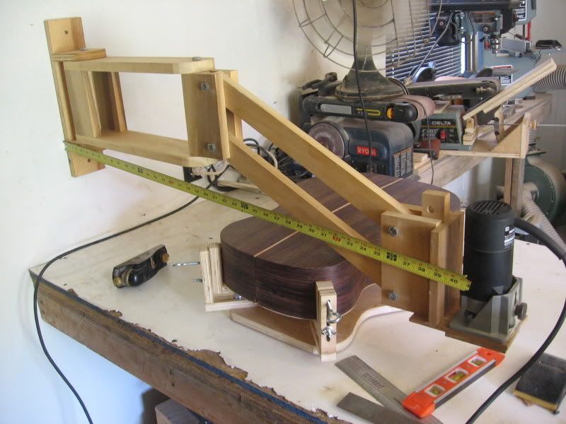

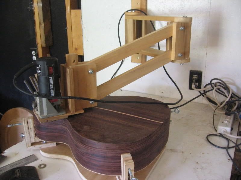

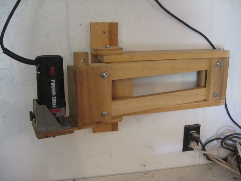

Actually I don't use either. This does the trick for me...
And it folds flat against the wall when not in use.
What the heck, one more pic.

PostPosted: Mon Aug 25, 2008 4:46 pm
Wes what wood did you use for the fixture. It kind of looks like white oak me
PostPosted: Mon Aug 25, 2008 4:49 pm
Posts: 622
Location: Santo, TX
Actually, that's just plain ol' HD poplar. Works plenty well.

wes, that is a cool binding jig. i just finished my williams jig or i might consider building that one. ive got over $100 in my williams jig with baltic birch ply (learned my lesson, total overkill) lazy susans, drawer slides, etc. this looks much more economical and quite easy to store. is the idea your own? good job bro.

And, yes, it's very economical, can be built for the price of a couple of boards and bolts from HD. Plenty stable and I like the fact that it locks into itself and stores against the wall.

Wes, That's a great idea for a binding machine thanks for the link. That will work perfect for me in my small shop. Do you know if there is a measured drawing available? I liked the Williams jig but was concerned about the space it took up and even storage space but this would go perfect above on the wall over my router table. Can you tell us if there is any min. and max. distances from the wall that the guitar needs to be?

Chris, if I remember right the LINT website has a full write up on instructions and the measurements he used. The range of distance from the wall could be variable based on the design and the lengths of the arms. I could try to get some measurements if you'd like. You can see in one of my pics the overall reach on mine is 42" from the wall. It will go all the way around the body in one pass, but I tend to slide the carriage around so I can see what's going on.
Mine is a little limited on how close to the wall it can work freely because of some interference points where the outer, vertically articulating arms hit the top and bottom supports on the swinging carriage that's attached to the wall, but this could be alleviated with some strategic whittling in those areas. Hasn't really posed a problem, though.
This one is also a touch tight in operation but, again, that hasn't really bothered me. Everything operates extremely smooth on it. If I were to build another one (or rebuild this one), though, I might try some low friction tape on all the joints. I've bound two guitars with it so far, and I'm plenty happy with it.

I did a quick scan of the artical and will give it a good read. But like you said about the arms hitting close to the wall was my concern being my table is only 32" X 48" I was wondering if it was deep enough. I'm also starting to wonder if I could use some of the Williams jig ideas along with some of this jig ideas. Well I got some time to think about it.

Chris, the interference problem could be easily remedied, I think, by simply making the swinging part that attaches to the wall a couple of inches taller so there is good clearance between the outer arms and wall supports. Leave the outer arms spaced about the same but on a taller tower that fits within the swinging section. Make sense? Viewing it closed like in one of the above pics, it would have an inch or so gap top and bottom. It could still lock into itself by putting a support block on the lower arm to hold the trimmer. For that matter, all the gap could be on the bottom, as that's where the interference is.
