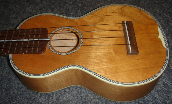

I have a cherry uke.... and it is astoundingly good sounding! In fact, I would even go so far as to say that I like the sound better than my vintage Martin ukes.
Its pretty cool looking wood too. This one "moves" like maple depending on the angle of view.
Cherry for the neck is lovely too.
