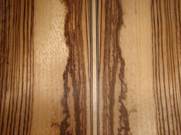

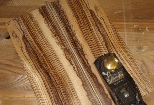

I am working with some right now for a ukulele that I am building.
The wood looks stunning, especially with the landcape figure, but it isn't without its problems.
I found that the large pale band here was fine, but it is the pale bands between the dark ones that cause the problem.
The pale bands are much softer than the dark ones....
1) A scraper will tear up that pale wood in places. So much so that I gave up with the scraper.
2) Sanding can make some of the pale lines look very soft and porus in places. Think balsa wood. I am wondering how they will take sealer and finish.
3) Jointing was a pain, because the pale bands were softer than the dark ones, and it was a sod to get a good joint with a plane. In the end I finished by sanding the edges for jointing after getting them close with a plane.
But it looks so stunningly "different". :D
Sound wise... I have no idea yet!
Rod

PostPosted: Wed Aug 20, 2008 10:01 pm
Rod, zounds that's pretty!
Keep us posted on this little guy as he develops.
Thanks for the pic!

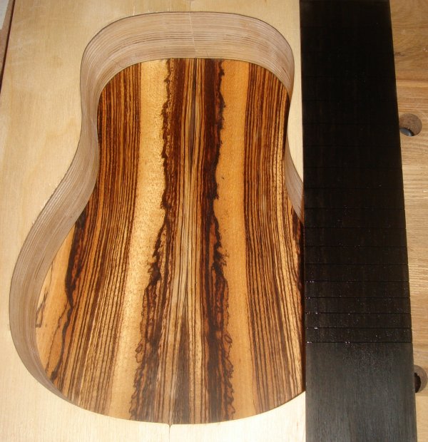

PostPosted: Wed Aug 20, 2008 10:40 pm
Joined: Wed Jul 16, 2008 9:19 am
Posts: 48
Yes... I just saw that wood and fell in love with it immediately!
I particularly like the landscape figuring in the back between the centre stripey parts and the broader pale band.
Being as it is a ukulele, I am using the zebrawood for the top (lower photo above) as well as the back and sides, and will use an ebony fingerboard and bridge as a contrast. I felt like having a back purfling instead of a straight butt joint, but I wanted something that was "toned back" in colour so as not to distract too much from the beauty of the wood itself. So I used fine b/w/b each side of a centre strip of maple. Everything "scaled down" to uke proportions.
As you can see from my mould (lower picture) it is going to be a soprano similar to a "Dreadnought" guitar shape.
Rod
