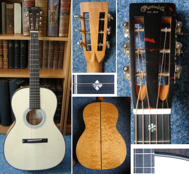

Rod, Nice wee 000 and the cosmetic combination in the right order (for me). What's the head stock fascia material, looks like a tortoise substitute - nice though.

Dave & Colin I am grateful for your advice, music is my FIRST consideration and in that music is conveyed to us in sound then that would be my second, as a player the physical proportions of the instrument ought to be a natural extension to me, once these have been fully met then I would consider the visual aesthetics.
With the classical as suggested spruce / maple wins.
With the OM as suggested cedar / maple wins.
I will act on that advice.
Should I “tint” the maple varnish on the OM to make it a “prettier” combination to me??? beehive
And coincidentally I’m of to Edinburgh soon (it’s festival time) and am meeting up with someone who has used P.orientalis and “sings it’s praises”. I’ll get to try his instruments out.
Colin as with your violin the guitar is exquisite work.
