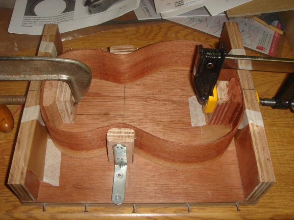

BIG HINT!
The Stewmac uke instructions tell you to build a simple jig. It does work pretty well indeed.
Here comes the BUT.... the instructions tell you to mount two 2"x2" angle brackets to the base board at the waist. I can tell you now that they WILL scar the wood on the sides of the uke. So much so that you dare not sand the scars right out, because the sides are so thin anyway.
So on my second one I added the simple variation of two small blocks of ply, filed and sanded into a curve, to the waist position, and fastened the angle brackets to those.
Problem solved.
Rod
