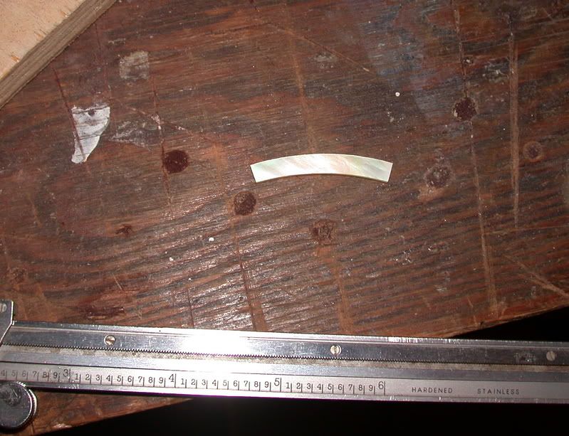

I filed and snapped and fit the individual pieces on my most recent guitar - the diameter's a little smaller than the outer ring, little bigger than the inner, no troubles:
http://www.xs4all.nl/~mvalente/guitarpi ... ette06.jpg
Finding the perfect pieces for an even colour match (I wanted predominant greens with a touch of blue - it's Paua, so it can be all over the map in terms of colour)

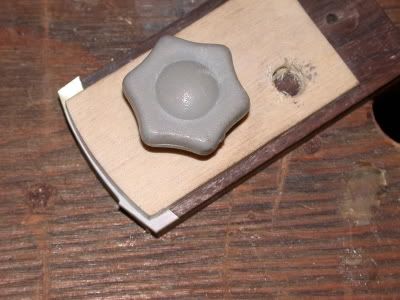

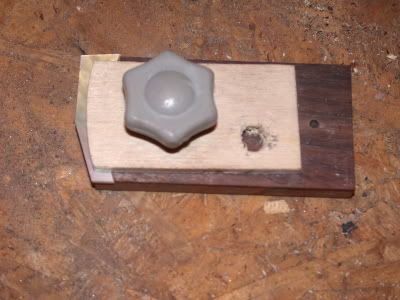

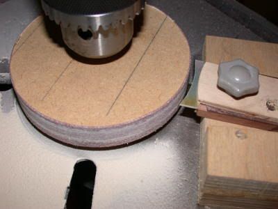

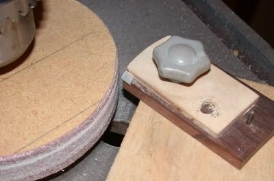

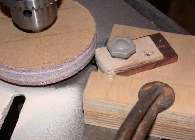

I start by grinding the inside diameter.

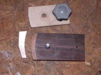

Here’s the jig I use for holding the shell.

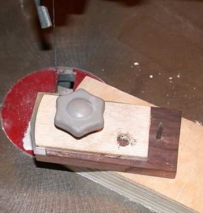

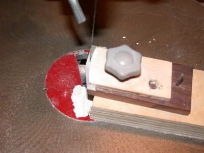

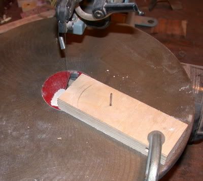

This is the only shell cutting operation that I find a scroll saw really good for. Here’s the basic setup.
Here’s the shell locked and loaded ready to go I cut a bit wide and clean-up on the sander.
Halfway through the cut.
Done. With a larger shell it cuts pretty clean all the way through. This one needs more than the usual amount of cleanup

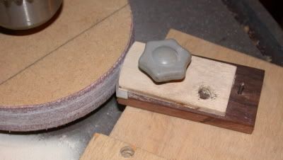

Here’s the setup for cleanup on the outside diameter.
Halfway through.
Done.

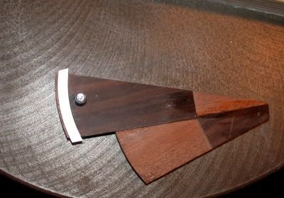

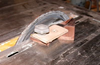

I used to go through a lot of saws mitering the ends. Now I use this jig and some sandpaper on an old wet saw. It makes short work of this job.
All done.

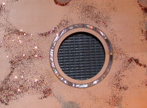

Inlaid and all decked out with glitter ready to party!
