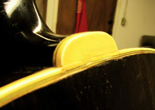

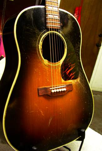

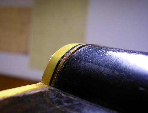

This one came in a few weeks ago, immediately after leaving another area repair shop. It's a '42 Gibson Southern(er) Jumbo. First year made, only year with the firestripe pickguard, maple neck reinforcement (war era, no truss rod), still had mahogany neck and neck block before they started using maple and poplar soon after. Low 2000's batch number (I think 2118), scalloped braces. This was the highest model Gibson made at the time, and were built by about a 10% skeleton crew during the war era, where Gibson kept only their best luthiers to build guitars. Phenomenal guitar, valuable guitar, and certainly worth preserving
When it entered the previous repair shop, it was certainly beaten and played, had it's share of scars, and had been refretted with jumbo wire, which appears to have been a good professional job. A fair amount of cleated cracks from years of use, replaced tuners, one replaced and a few cracked pearl fingerboard inlays, not sure about if the neck was ever previously reset (probably not), but the bridge was original. These guitars with the heavy radius tops are generally so stable that they don't often need neck resets, though at this point I have no way of really knowing if it really did here or not. In any case, the other shop did do a neck reset, and here are the results.
Heel cap fit - that's kind of shoddy
Looks like it got a bit hot during removal - ooh, that wasn't there before.
But at least they got the angle up. and after some touchup around the extension, they even threw in a beautiful new bridge.
A beautiful new cocobolo bridge. How nice... And just to make sure it wouldn't need another neck reset any time soon, they kicked the angle back a bit more, and made the bridge about .400" tall (way better than those old 1/4" Gibson bridges, right?). The old bridge appears to be gone now.
Let's get another look at that beauty - just look at those Gibsonesque lines.
Thankfully through all this work, they left the original bridgeplate intact - well, intact and still glued on in front of the pins anyway.
I'm quite thankful they didn't decide to pull the bridge plate, as there's no telling what damage that may have brought.
So that's how it came in. Now though they did reset the neck at too high an angle, thankfully it wasn't as bad as it originally looked. They greatly overcompensated in the replacement bridge height. The action was quite high, though there was still quite a bit of buzz at a decent size hump at the extension.
After discussing options with the customer, we decided that the neck angle and cosmetic damage is now what it is, and we weren't going to attempt to bring it back down. After leveling the frets, I felt I could get a bridge in the .300"-.320" range, with about .160" saddle clearance at the center, which I felt this top could handle just fine. So it's a new Brazilian bridge and saddle, new bridge plate, and fret leveling. I'll put an abbreviated summary of the repairs over a few more posts.
PostPosted: Mon Jul 14, 2008 11:43 pm
Posts: 2692
Hard to tell from the photos, David, but I'm wondering if you aren't looking at a head block reset rather than a neck reset. The separation of the heel cap and the sloppy back binding and purfling below the heel cap (which ought not to be touched by a neck reset) suggest it. Is the lacquer chipped along the heel/side junction, or is it otherwise clear that the neck has been out?
Bridge--too bad the original is lost, but it could be replaced by a good copy. It probably needs to come off for repairing or replacing the plate, anyway.

PostPosted: Mon Jul 14, 2008 11:56 pm
Posts: 2060
Hi Howard -
Good call - I hadn't thought of the head block / shoulder tuck, but actually there are a number of other details I didn't make obvious in the pictures. The finish is chipped away along the neck joint, the 15th fret was pulled and drilled for steam, and the binding / back joint is still original intact once you get immediately past the heel area. Of course none of that is in the photos I put up...
Actually I just finished the repair this weekend, and am just putting some photos together. I did make a replacement bridge and bridge plate, and am actually very happy with how it came out. I'll probably put in another post or two tonight about it.

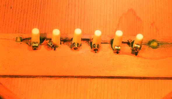

So now we're on the the bridge plate. First to make a template of the plate I pull out my trusty high-tech X-brace angle gauge.
Then I make a quick cardboard template, grab a sheet of 1/4" aluminum, and make a heater plate. For jobs like this I use heater cartridges, and have a system set up to make it very easy. The cartridges I have mounted in aluminum blocks, and a little template to drill clearance holes in any plate I make to screw these blocks on.
Here it is ready to go. From the time I took out the angle finder to this point where the heater is ready, took me maybe 10-15 minutes.
For bridge plates like the 70's Martins I will go inside with a small, short hand saw I made with a depth stop to cut the plate in half without hitting the top. Then I will heat one side at a time, and remove the sides at different angles depending on runout. A little plate like this though is certainly a one-heater job.
Notice in this pic that I do cut the plate short, so as not to touch the x-braces. I also go in with a damp rag and moisten the plate. I'm not sure if this small amount of water helps to soften hide glue, but I believe it at least aids in transferring heat to the joint.
I keep the top open and well cooled. No cauls or plates. My goal is to heat aggressively from the inside to heat the glue joint sufficiently before heat has chance to really migrate to the top, and keep a fan on the bench to cool the top just in case. Here is a thermocouple probe stuck in to a bridge pin hole to monitor temp (though my hand on the top still has the final say).
I use very high watt heater cartridges (600w if I remember), so 50-60 volts on the variac is pretty aggressive. I heat fast and heavy, hitting about 130℃-140℃ at the plate. On a plate this thin, it often takes less than a minute, but really heating the glue joint sufficiently makes all the difference in the world in pulling a bridge plate.
I didn't take pics of my pullers, but I basically use putty knives, bend over in a U, and ground to various edges, usually preferring cut to an outer bevel. this plate came off like butter.
Here's the inside.
Next post, installing the new plate.
PostPosted: Tue Jul 15, 2008 12:35 am
Posts: 2060
Clean the surface with yet another high tech gadget (plywood and sticky sandpaper).
And with a few strokes it's pretty much ready
Cut a new plate from good maple, about .090" thick, same as original.
I kept the front line pretty close to the same, but did extend the back about another .080" behind the pins. The original I think was pushing the limits, and showed in that crack.
Now a plywood caul and a few waxed plastic pins to hold it on the caul.
I get the hide glue ready
Warm the surfaces
And glue it up. Now I'm not trying to correct any major bellying in the top - I'm replacing a cracked and loose bridge plate. The top was pretty good, though you'll see I did wedge a block under the clamps to push the clamping angle up a bit. If I were trying to correct a bad belly, I would be using a much larger plate on top, and probably spend a few days coaxing it before gluing. You should notice though, that I have leather under the 1/4" plexiglass plate. With all the spruce removed from under the bridge, I want a caul that will conform to it's unevenness and ensure a good clamped joint on the inside of the top to the bridge plate.
And here it is with the clamps off. A small bit of squeeze out, one little glue smear, and a good new, appropriate sized bridge plate.
Now on to the new bridge.

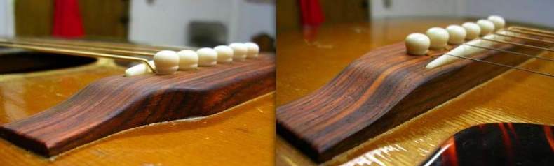

I won't get too much in to making bridges. I've always though of this as something you just "do". Here I cut the holes in a nice piece of brazilian on the milling machine because it's quickest and easiest for me, though it can just as simply be done on a drill press.
Now off to the band saw, belt sander, spindle sander - grab a set of dial calipers and use whatever works. I've always done this freehand, and unless you're making many of an identical style I see no reason to jig up for this job. Here it is in the rough off the sanders.
Glue in the pearl dots where Gibson's screws were, final shape, sand, and buff.
The bridge on the top matches 40's Gibson facets, curves and contours. The one on the bottom does not. :?
Then after cleaning and preparing the top, I route the ledge to match whatever recess there is in the top.
When dry clamping I will block and tape at least the first clamp in place - takes a lot of pressure out of using hide glue.
Then heat the surfaces with heat gun, lamp, hair dryer. Quick scrape on the bridge to clear any resins, apply glue, clamp, and cleanup.
Drill holes, fit pins, slot bridge, etc. String up with brass dummy saddle to set saddle line.
I also like to double check with actual measurements before cutting.
Then it's off to route the slot.
And the bridge and bridge plate are pretty much done.
