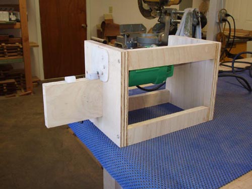

I made my own binding cutter, it was really easy to make and a couple of pictures will get you there no problem.
It's certainly not fancy but it works great.
First off I should mention that it's the type of cutter that you move the guitar body and not the cutter (router). Some folks don't like this method but it works fine for Larrivee and Taylor, and it works fine for me too.
Roy Ott made a better one than mine and here's the link to his in the archives.
Here's a picture to peak your interest.

Mike buddy here are some more choices for you:
Honda Civic: You can make a wedge shaped donut from MDF scrap and coat it with a few coats of shellac to stabilize the MDF. Attach it to a laminate trimmer and make a mark where the wedge is the thinest.
Using the binding bit set from Tracy, LMI, or Stew-Mac make climb cuts first and then do the entire guitar top or back. The wedge angle was determined by taking the two domes that I use, 15' and 25' respectively and computing the proper angle for the average of the two, 20'. I am forgetting what this angle is but you can compute your own angle for the domes that you use. If I was not so lazy I would have made two donuts, one for the back and one for the top.
It is held to the router base with double stick tape.
Downside: As Alain indicated the binding channels will not be perfectly uniform but they will be substantially better than using a laminate trimmer by hand and not using a donut.
Upside: Cost - it costs nothing to make.
Lexus: This jig from Luthier Tools is probably the nicest guitar making jig in terms of how well it is made that I have ever owned. And a number of OLFers like Arnt, Serge, and others have made their own as well. It registers on the sides and is also used in production by some of the factories.
Downside: If you do not make your own it is around $200 if I recall correctly. It is also possible to tip the router and jig inward toward the guitar and take a divot out of your top or back. Users report that once they get used to using it this is not an issue. Lastly you will need to make a jig to hold the guitar in place and the jig has to be low enough to clear the double bearing arm of this jig.
Upside: Perfect results can be obtained with this jig. In addition it uses a spiral down-cut bit which makes a cleaner cut, costs less, less filling..... Again you can make your own as well.
Bentley: The Williams jig available from John Hall at Blues Creek. This jig, like the Bentley, takes up more space but IMHO is the best solution going. It is so idiot proof, just what I need, that it is possible to route a binding channel blind folded although I would not recommend or try this........ The router is held perfectly vertical at all times taking the domes completely out of play.
Downside: Cost if you purchase one, around $275ish but don't quote me on this. It requires more space to set it up and use it.
Upside: Perfect results every time. Reduced fear factor from ease of use.
Aston Martin: Williams Jig with Dave White Modification. Although I don't have a picture of this and I hope that Dave or Colin will weigh-in here this is a version of the Williams jig with a turntable below the router so the router can rotate AND if I recall correctly you can also use a spiral down-cut bit as well.
Downside: Cost of the Williams jig but you can make this entire jig yourself too. Space requirements.
Upside: Cleanest cut, perfect results, and IMHO bragging rights as the best solution available.
