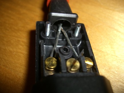

Hi All,
I checked with Lance before posting this and got his blessing, so please don't let this become a discussion of whether this kind of posting is relevant or not.

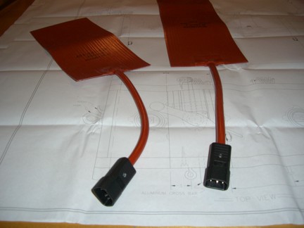

I just purchased a brand new set of side bending heater blankets (one long one and one short one for adding extra heat to cutaway bends) and found some safety issues with the wiring that I need to bring to everyone's attention.
I tested the smaller blanket first - plugged it into a normal AC outlet - and it worked just fine. When I plugged the large blanket in, there was instant arcing and a loud bang as one of my AC circuit breakers tripped. I reset the breaker and tried it on another circuit, with a higher current rating. The same thing happened, immediate arcing and the breaker tripped instantly.

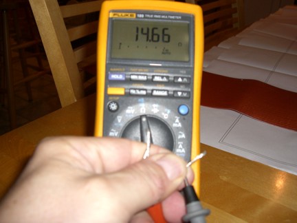

I got my multimeter out and measured the two heating elements. The smaller one measured fine, but the larger one was a dead short. It would have to go back. However, being an inquisitive sort, I decided to open up the in-line AC socket to see if the problem was in there and perhaps fixable. Here's what I saw inside:
The wires were bare for about 1.25" and were crossed over and shorted! eek
The insulation wasn't just "pulled back a little", the wires were stripped right back like this. The wiring was obviously never done properly at the factory. It's a good job I had good circuit breakers - this kind of fault can start fires! When I separated the wires and measured the DC resistance of the heating element, it appeared to be fine, coming in just under 15 Ohms:

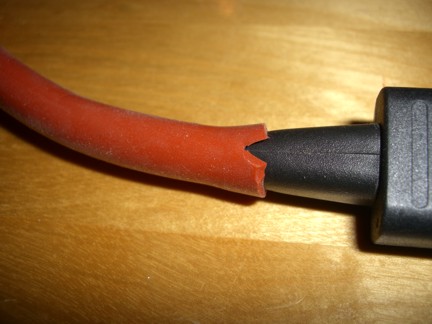

I cut back the orange outer insulation tube and remade the wire ends properly. I dispensed with the black rubbery cable entry grommet (it really isn't necessary - the wiring is actually safer without it, as it is held tightly so it can't twist or rotate) and reassembled the in-line socket safely, like this:
While I was at it, I decided to inspect the wiring on the inside of the small heater. The screws on both wires were loose (hard to show in a photo), and the outer orange insulation was already splitting on the black rubbery cable entry grommet, allowing it to freely rotate which, of course, will lead to eventual twisting and shorting of the wires inside the in-line socket:
After I remade the end on the small blanket heater, I tested them both again - this time they were fully working with no problems, and should be good for quite a few guitar side bendings to come! :D
In my opinion, EVERYBODY who has/uses these types of heating blankets should immediately do the following safety checks:
1. The internal wiring of the in-line socket should be inspected to make sure the wires are not over-stripped and potentially shorting (if so, the wiring should be re-made)
2. All screws should be checked for tightness
3. Check to see if the in-line socket can rotate on the end of the orange outer insulation. If it does, then you really need to remake the wiring/cable grip properly, without the black rubbery cable entry grommet in place.
If you are competent and can do this yourself, then, entirely at your own risk, have a go. However, if you are in the slightest bit hesitant about your abilities to re-wire things, please have a qualified electrician do this work for you.
I bring this to everyone's attention purely in the interest of public safety. I'm not going to say where I purchased the heaters. No finger pointing is necessary. I just want y'all to stay safe out there!
