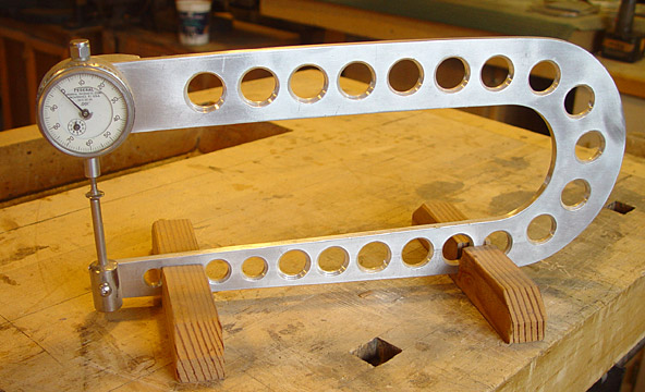

This one isn't wood but aluminum is not really that hard to work with. It cuts easily on the bandsaw and can even be cut with a table saw and milled with a router if you use carbide tipped blades and bits.
I made this out of 7075 T6 alloy which is the hardest and stiffest commonly available alloy. Often it can be found at metal recycle yards for about $1 per pound. I bandsawed the body from 1/4" plate.
