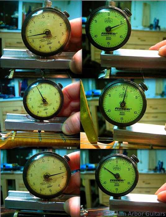

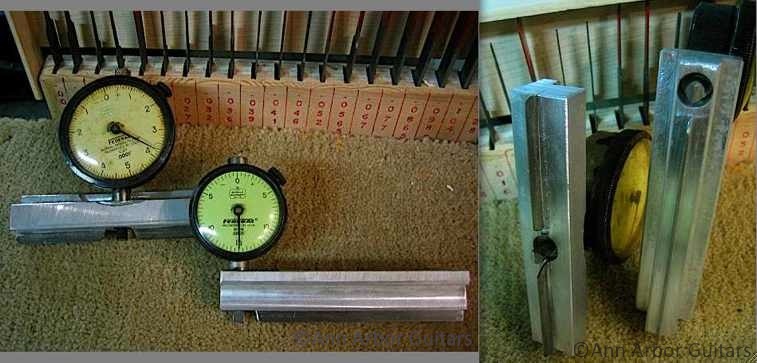

I recently posted on setting nut height on another forum, and since I'm too lazy to type it again I'm just going to copy and paste my posts from there to here. The topic is close, but if there are points that don't apply to your case in particular forgive me - it may have been originally written for a slightly different audience. Here it is ---
- Adjusting the height is such a hard thing to communicate without being able to point at the right height in person and say "make it just like this". There just aren't any tools readily available to reliably quantify the measurement. It's one of those things that when you know, you know, but learning what you're looking for and even how to look at it can be the hard part. It can be difficult to know when you've got it right without at least having someone more experienced to revue your work. Many people have learned on their own, but it generally takes a while.
Measuring is so difficult because it pretty much has to be done by eye. I strongly dislike the idea of measuring the height above the first fret with the string wide open, as in doing that you are including so many other variables that will make the measurements crude at best, and often quite misleading if something else is out of adjustment. Fretting the string past the second and checking clearance above the first is more the reliable standard method, but the distance traditionally has to be checked by eye, and describing the distance without seeing it can often be a challenge. Trying to use a feeler gauge under a string is not very reliable, as it's hard not to disturb a string out of position as you're trying to slip a .001" feeler gauge under it. I'm not saying it's quantum mechanics, but it is a case where the act of measuring will often affect a change greater than the tolerances you aim to hold in what you are trying to measure.
For teaching and demonstration purposes I made a some gauges a while back to try to quantify and better communicate accurate measurements. The first one I made measures the clearance above the 1st fret when referencing from the nut to 2nd fret, or the measurement you are usually viewing. The second version references off the first 2-3 frets and measures the height of the slot above the plane of the frets. This one is more sensitive, as the geometry of it will make it register almost 2x the distance that the first one does. Of course these measurements rely on the frets being perfectly level, and to some degree to the neck being adjusted straight.
One measures below the nut-2nd fret plane, so reads negative when the string is high. The other measures the nut slot above the fret plane, reading positive. In this photo the top row demonstrates a nut I would consider very high, middle row shows an ideal height (for this particular instrument anyway), and the bottom showing a slot far too low.
On the average Strat or LP I will generally end up with the high E in the .001" to even <.0005" range, and the low E in the .001" to .002" (I'm referring to height of slot above fret plane, or the gauge on the right). It all depends on the player and the individual instrument of course though. A heavy flat picker's D-28 may end up at .002" and >.003", and of course rules are different for classicals, banjos, etc.
I know Don at StewMac was working on a similar tool as of maybe 6 months or so ago, so there's a possibility something similar will be available on the market some time soon, though I really don't know. In any case, it's not a tool I would advocate for full time use, but would be great for learning, teaching, and documenting. Relying on it too much would be a crutch in my opinion, and there's no replacement for learning how to look and gauge by eye.
I don't know if any of this helps at all in your particular case - this is one small factor. Doesn't touch on spacing, backfiled angle, tool choices, fitting and shaping, etc. Perhaps it will help you understand goals and perspective on tolerances though, how to reference height, and what to be looking for. -
-Now the "half-in, half-out" thing gets brought up quite often, but I always stress to people that it is only an aesthetic and doesn't serve any real functional purpose. It certainly speaks of fine craftsmanship, which is why I typically aim for something similar (though I typically aim for only 1/4 to 1/3 exposed. The string itself is oblivious to anything above it's midpoint, making the material above irrelevant in most cases - could be a quarter inch above the string and it would still work the same.
The exception to the rule of course is if the break over angle is shallow, in which case the string should never be more than 1/3 exposed. Go to half exposed and many players would be popping strings out of the nut with bends and pull-offs. String trees obviously help this on a Fender. Since it's only an aesthetic I personally prefer to leave no more that 1/3 exposed as a general rule. -
Sorry if those posts seem a bit disconnected, but they're pieced together from another discussion. Perhaps it can offer some insight to goals though. Some other notes not mentioned above - I never loosen strings while cutting a slot. Just lift it out (I use a little brass hook I made), take a few passes with a file, pop it back in and check it. Many people use the half-pencil line trick (including myself) to rough in the height, but it is only really useful for roughing it in. Even a fine .010" pencil line is about 10x the width of the tolerances I aim to hold.
And again, that gauge idea was just for a method to accurately communicate and document height. I don't personally use them when making a nut, but they could be useful for people learning without a mentor for hands-on critique. If Stew Mac or someone can make them for a reasonable price they could be a useful training tool. Still, it's all just going to come down to practice.
