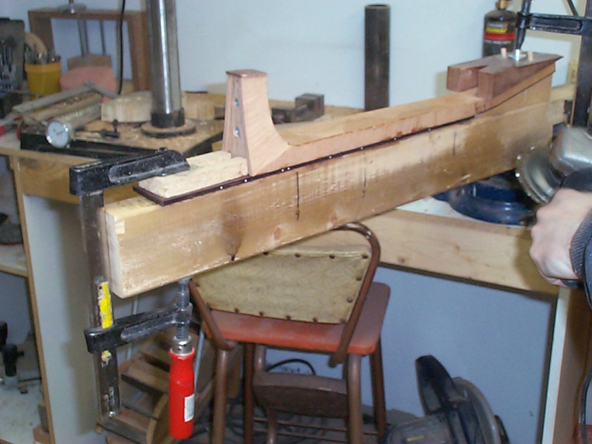

Here is a link from my website that shows how to carve a neck. This video is from Edward Dick's Guitar Building class. It is just a 2x4 screwed to the workbench with a router pad. Very simple.

I used to just stick them vertically in a vise by the tenon end before the Fadal (well, and before I used the belt sander)
If I were committed to carving necks by hand, I'd make something analogous to what was shown. A piece of 2x4, cut thinner than your neck width, and just double-stick-tape the blank down onto it and carve away. This doesn't work so well for those that carve the neck after fretting, though.
If you're going all the way, then use vacuum instead of the DST to hold the blank down. I don't tend to stick necks on it, but I have such a fixture on my bench I use to hold fretboards while I install and level inlay.

I modeled my jig off of Mario's. Here's a link to his: Mario Proulx neck construction
PostPosted: Tue Feb 12, 2008 9:40 pm
Mine looks like a lot like Marios...except I have holes drilled in the center of the board for clamps.
PostPosted: Tue Feb 12, 2008 10:20 pm
Posts: 1667
As simple and crude as that 2x4 appears, it's vintage '90s(it may actually be my very first ever '"jig") and to this day, I can't fault it. At no point have I ever thought "gee, I need to do -this- better".
Is that an angle grinder I see in that photo?!?! :o
Yep, Mario likes to live on the edge!
Actually, I use one myself, but with one of these. With a 40 grit, it hogs off lots of material, and QUICK, but still leaves a decent finish...
