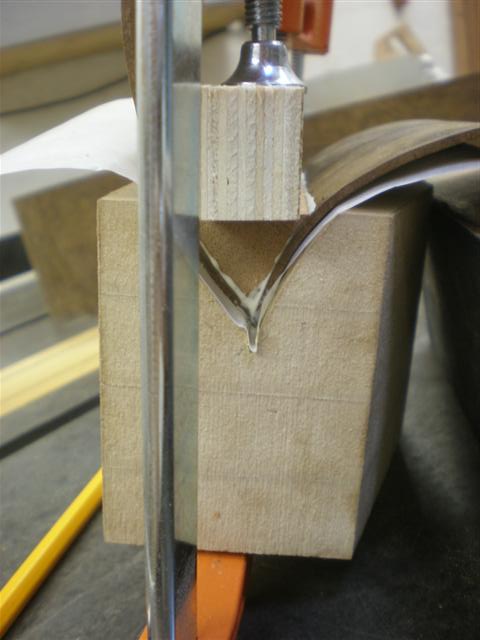

[img][/img
I'm trying to figure out the purpose of what looks to be a step in Rod's clamping caul as shown with the added arrow.
Looks like it acts as a stop for the short side but not sure why.
Would appreciate any clarification.
Nelson
 Post subject: Re: florentine cutaway
PostPosted: Tue Feb 12, 2008 2:43 am
Nelson good question. I was wondering the same thing :lol:
Actually, there shouldn't be a step there, it should be smooth into the recess slot, I'll have to check that out. When I put the side pieces in, I make sure that they just join in the recess slot (which is a little bit big I think, might have to make a new clamping caul soon). What I'm trying to do is force the two pieces of side wood together at the point to try and make as seamless of a joint as possible as my goal with my florentines is to make them seamless without binding. If the tip does not close up all the way, I'll have to bind it, but that's ok too.
take a look at this picture, you can see the paper goes down into the recess slot as well as the squeeze out and actually if you look closely you'll see both side pieces extend down into the recess slot.
Hope that makes sense.
PostPosted: Tue Feb 12, 2008 11:03 am
Posts: 1534
First name: Nelson
Last Name: Palen
Thanks for clarifying that, Rod.
I thought I was missing something but was really just seeing too much.
Nelson
