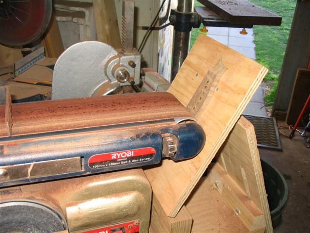

We use a belt sander.
The pic below is a bridge but the headstock works the same way and makes a great volute as Tony says.
Bob

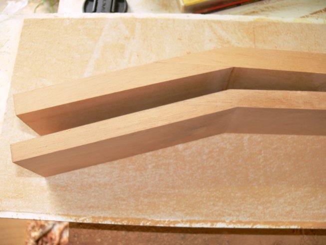

This could be fun (just fer roughin' in...)

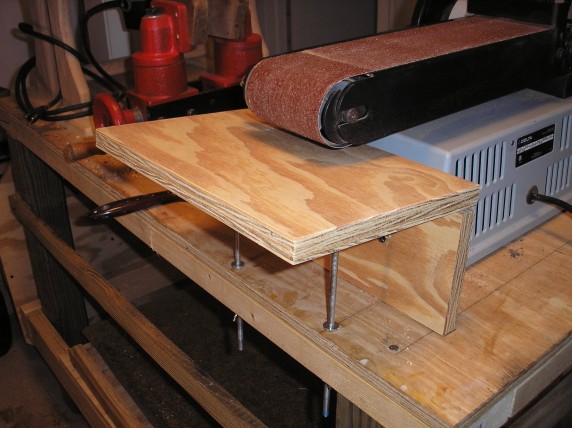

I found a pic in the archives showing a small delta sander tabletop type with a plywood adjusable wing.
Problem with mine is it's quite worn and the bed will raise about a 1/2 inch when wiggled up and down. I may be able to tighten the allen head screw at the motorized end which holds it all?
Time to bring in my big floor model. My shop just keeps getting smaller. Rod.... help!

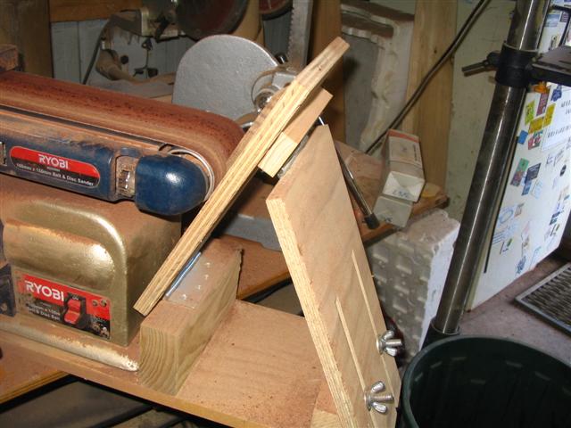

hey bob,
your system looks like it makes a lot of sense - and even leaves room to tuck the end of a shop vac in somewhere. could you show us another picture or two of how you make adjustments?
phil
PostPosted: Tue Jan 08, 2008 1:21 pm
Posts: 698
Just a couple of wing-nuts Phil

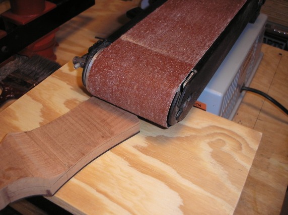

Bruce, I made this simple jig that works well for
headstocks and other things like brace ends and bridge wings.It makes a nice volute too.

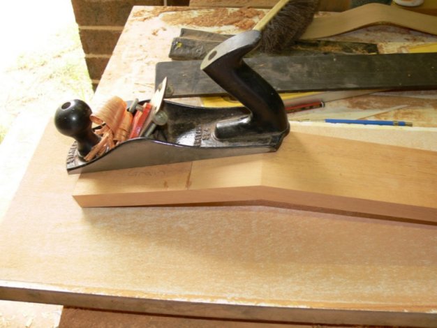

Posts: 97
I use a scarfe joint.
I thin it with a jack plane.
I taper the neck in the same way.
Select the grain direction before glueing the headstock on.
Mark it out carefully and double check your progress at regular intervals.
Plane away from the centre of the joint
Clean it up on a large sanding block.
Gets nice results
Takes about 15 minutes with care.
