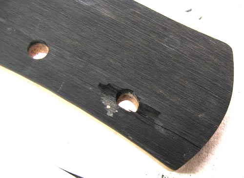

While drilling holes in a peghead for tuning machines, I drilled one hole too fast at the end. My drill press bit into the denser material when the bit broke through and sent an ebony splinter right down the grain of the head, splitting it.
Even though I had a supporting board under it and was holding on tight, it ripped it right out of my hand. I think I'll go buy a forstner bit for next time .

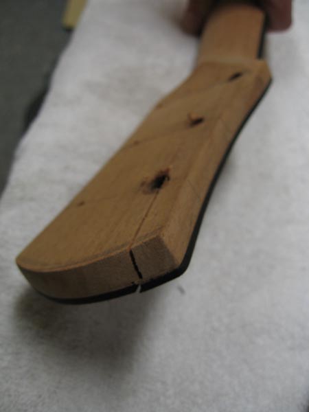

But I think you can still glue it up and be ok. Just need to do a little on the headstock and maybe use a back veneer and you'll be good as new! :D

Glue up the headstock, replace the veneer, and always use forstner or brad point bits for any through-hole over 1/8".

I agree witht he glue up and replacement of the veneer. Should be an invisible repair

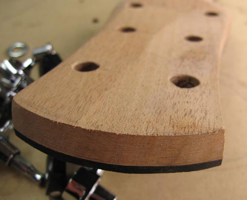

I was able to use a metal rod as a lever to open up the split to where I could get in with tweezers and an exacto knife to remove all the splinters inside the split. I then used the ebony splinters like puzzle pieces and glued them back in their original spots the best I could and filled the rest with epoxy and ebony dust after gluing up the split. Thankfully the repair is invisible:
