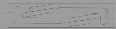

Waste is always a factor in woodworking, I suppose. Every time I've tried to set up a process to be as material-economical as possible it has cost me dearly in time, though. Your constraints may differ, of course. I set up my laminates like this:
That gives about 35% waste. The traditional two-blank to a block setup gives about 42% waste in ideal setups. Note that the shapes of the outlines give enough room to saw around the 'actual' blank shapes, so the waste % would actually be higher if we were calculating to the end-profile.
Coincidentally, if you put two more blanks on either side of the tiling I use to make it six to a block, you end up with a waste of about 41% (sort of back where you started)

I see now. Thanks for the pic and the web sight. Charlie makes it look easy,
The widths of the laminates can be just about any size as long as you end up
with a blank that is big enough. Probably 3x4. It appears that one can take
plain saw material and by flipping the other way it ends up with the proper
grain orientation. Is this what you where referring to on "grain orientation?
