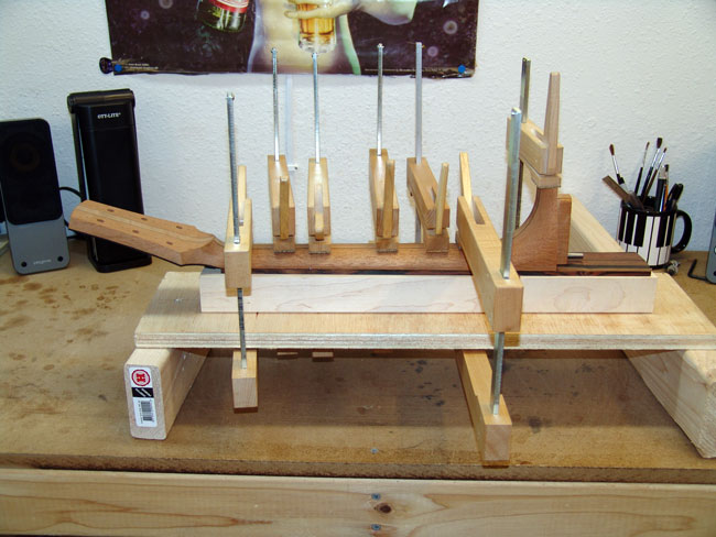

Here is the picture that I think Alain may have been talking about.  This is a commercially available fret board gluing caul from John Watkins.  It is hard maple, dead straight, pre-radiused to 16", and relieved in the center, truss-rod area.  I used West Systems epoxy and received great results.

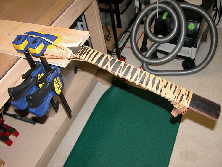

If your neck is perfectly straight you could get away without a caul if your clamps and procedure are correct.  What kinds of clamps do you have available to you?  There are clamps that are like bands that will conform to the shape of the fret board.  Also, I have glued on many a fret board using 2 64" rubber bands wrapped around and around the neck.  It's not the best way to do this but requires very little in the way of tools or cauls and is recommended by Stew-Mac with their kits.
