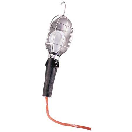

One of these with a 100-Watt bulb will do the trick with the added value of being able to find the pieces when you drop them. Cage removal maybe required.
Michael Lloyd
