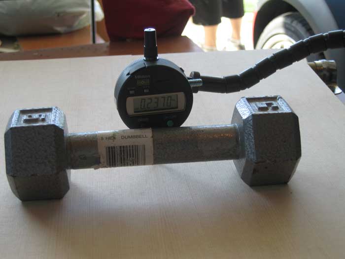

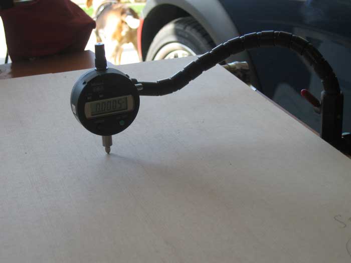

PostPosted: Mon Jan 07, 2008 2:25 pm
Here are the only picts I could find. It would be better if my weight was a bar to evenly distribute the weight, but I have been using this so far and my results are fine.
Numbers for the deflection are kind of meaningless taken out of context of the entire system and bracing etc. For what it is worth, here is some data on my L-OO
Lutz L-OO Lutz/AAA 64     0.153     ; 360     6.68
Lutz L-OO Lutz/AAA 75     0.143     ; 348     6.91
Lutz L-OO Lutz/AAA 120     0.127   &nbs p; 303     6.77
Lutz L-OO Lutz/AAA 169     0.11     ; 268     6.92
Lutz L-OO Lutz/AAA 241     0.096   &nbs p; 234     6.92
Lutz L-OO Lutz/AAA 275     0.091   &nbs p; 223     6.96
Lutz L-OO Lutz/AAA 290     0.087   &nbs p; 215     7.02
Lutz L-OO Lutz/AAA 330     0.083   &nbs p; 205     7.01
The last 2 columns are weight and density measurements

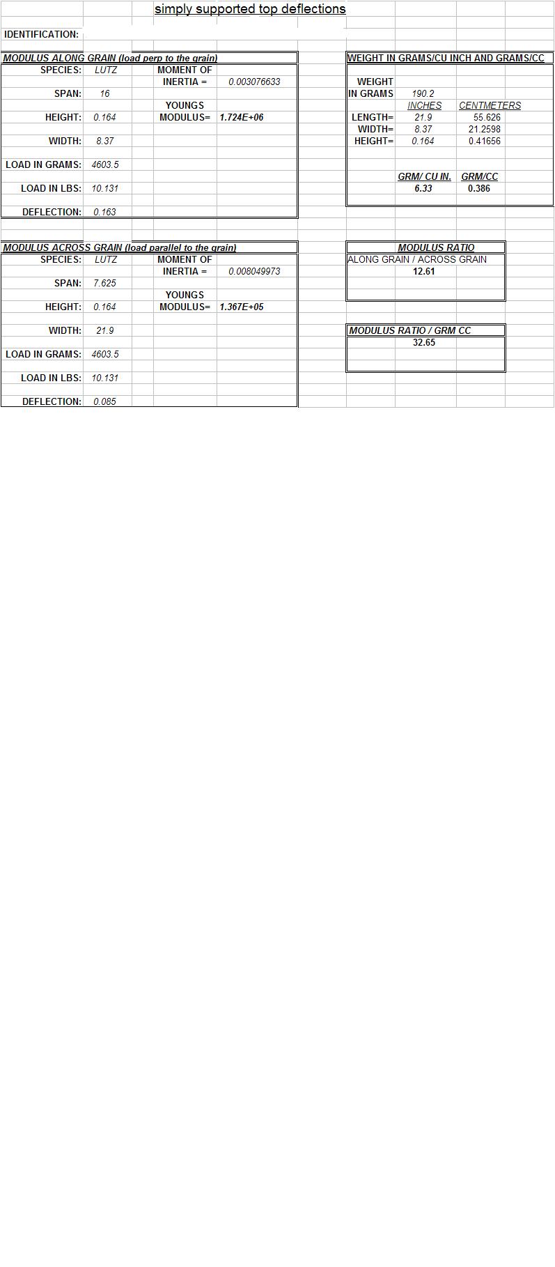

Here's a sample of the way I keep my data and what I check.
My weights a little heavy in this sample. I think about half of it is about right.
As you can see I just set up a standard spread sheet and track my data that way.
PostPosted: Mon Jan 07, 2008 4:20 pm

JIm, I assume you have the formulas embedded in that spreadsheet, right?   Can you display that?

Jim my friend I really like your record keeping and spread sheet - any chance of sharing the spread sheet (without your data or course)?
