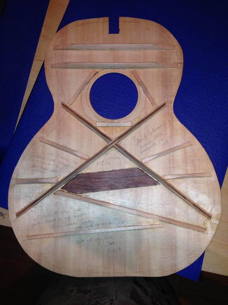

Do you have the sides bent yet? Typically, the top and back don't get braced until just before they are glued to the sides. Less time braced and unattached means less chance of humidity problems. As long as your shop RH is constant, you should be OK, but it is something to keep an eye on.

Thx, Rodger. No, I haven't yet. My brother is shipping me his bender this week. Since I braced the top and back three or four weeks ago and my loft is fairly constant 45% I think I'll be ok. Hopefully.

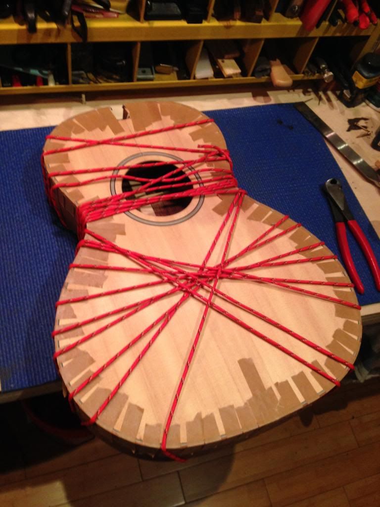

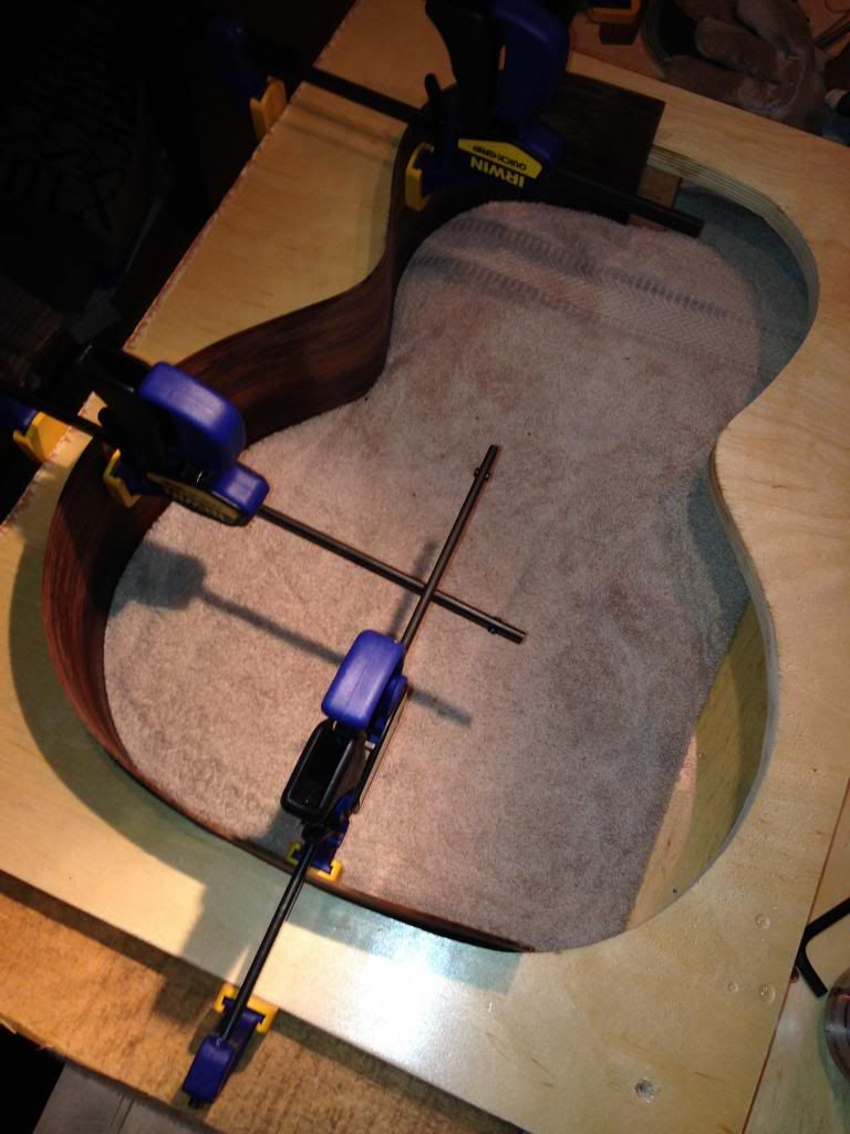

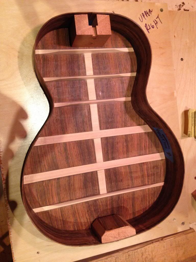

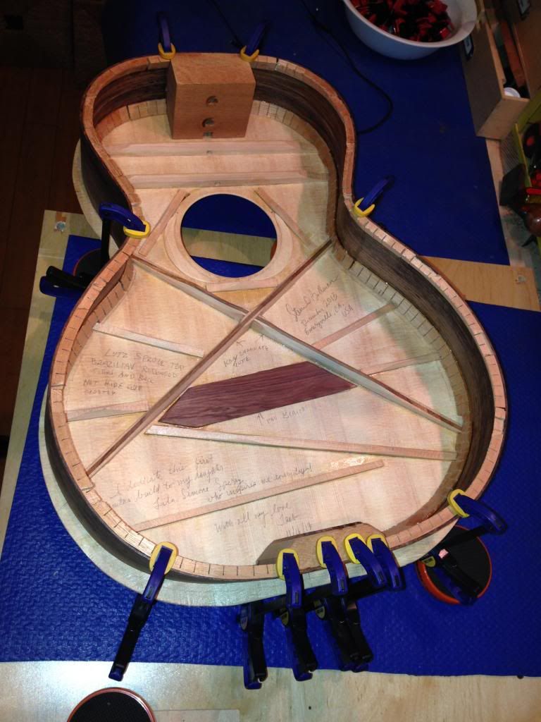

Dry fitting the top and back to the rims. I'll glue up on the weekend. I think I'm chickening out about using hot hide glue for this particular glue up. I just can't imagine working quickly enough without drizzling the glue everywhere to get a good glue joint.

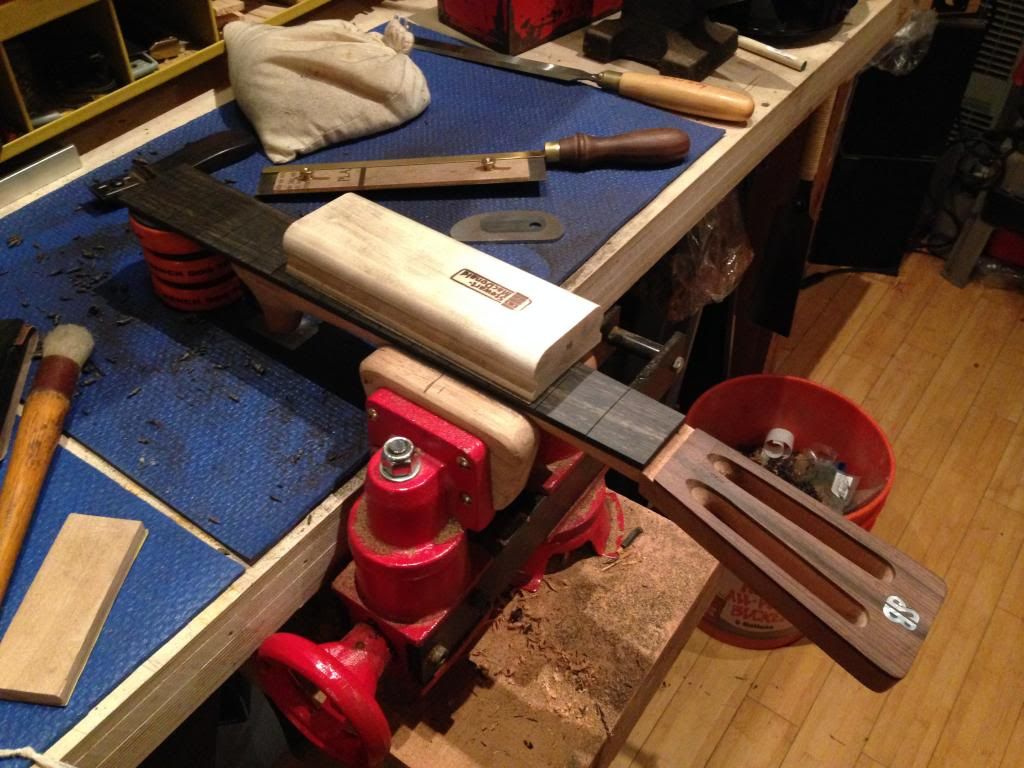

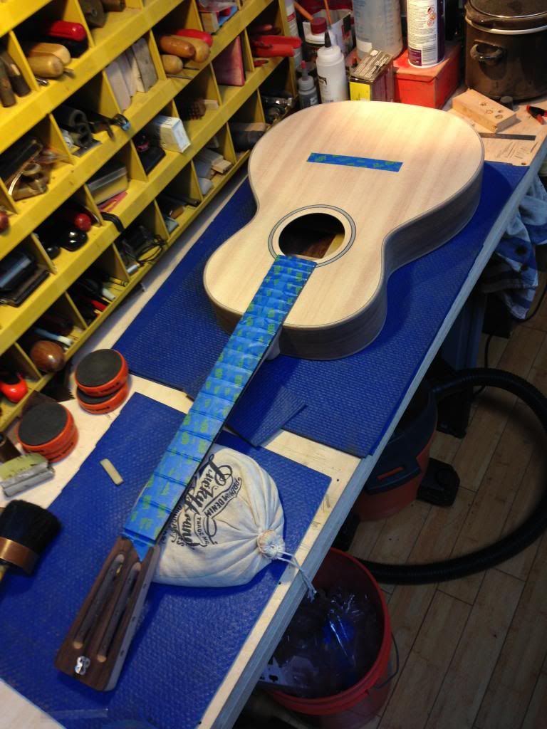

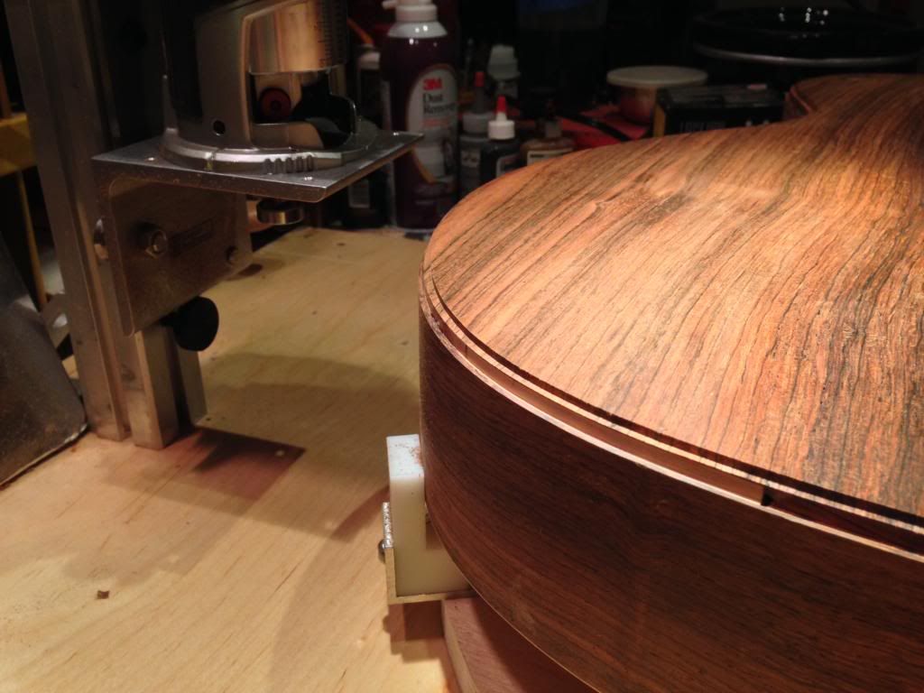

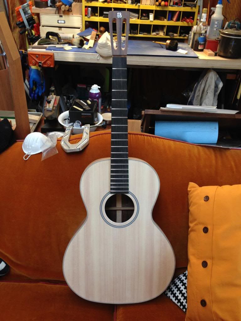

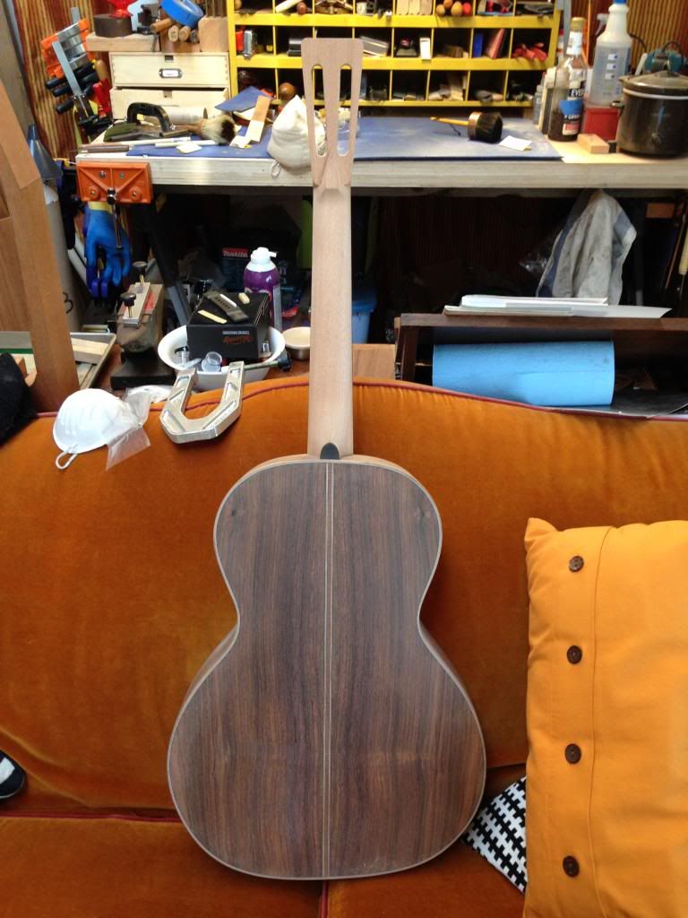

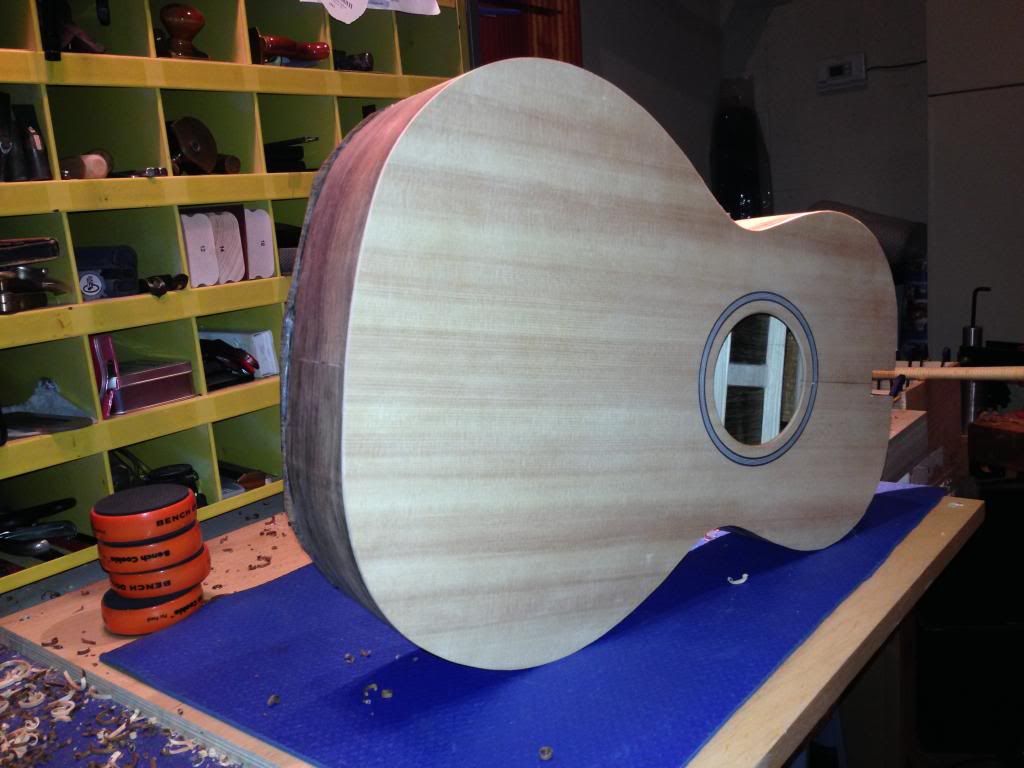

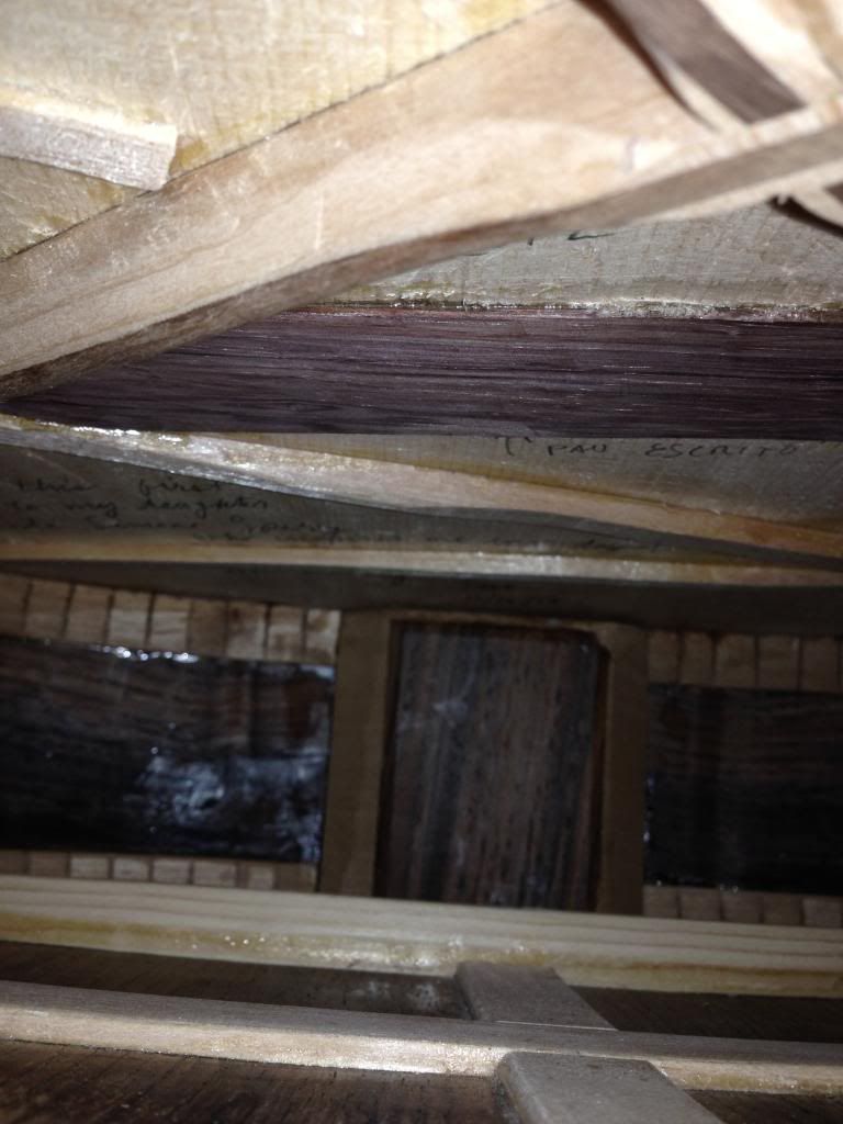

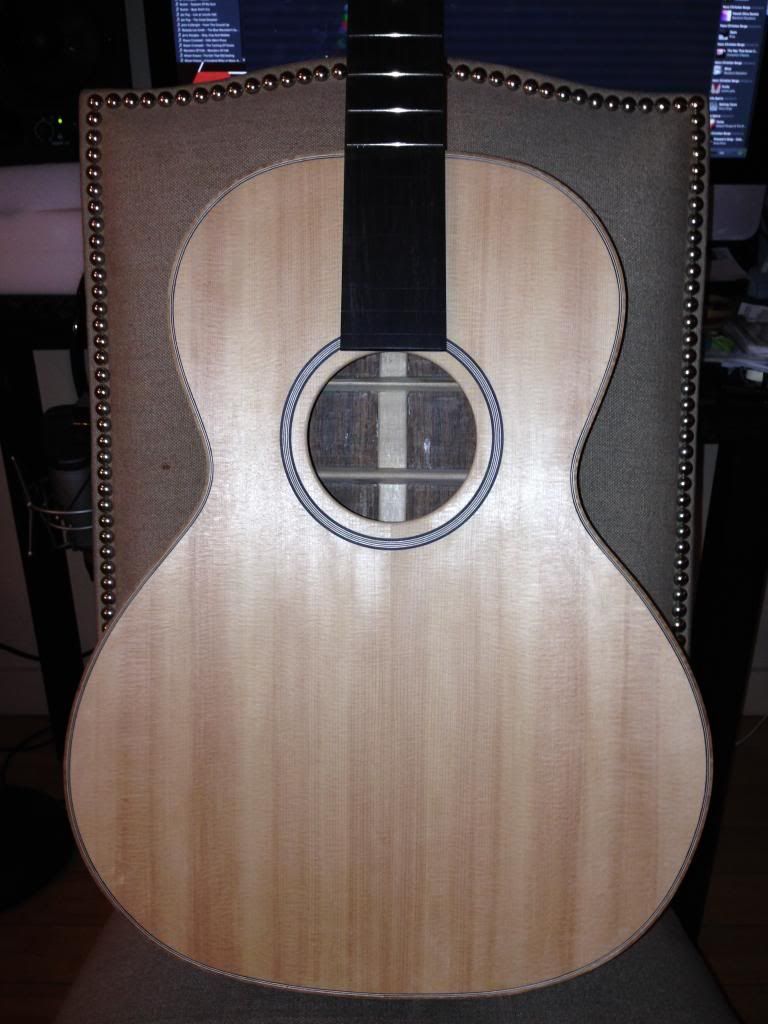

I've been busy even though I haven't posted photos lately. So, here's a bunch. I'm pretty excited about progress. When I tap on the closed box, it rings and sustains really nicely. We shall see how that translates once there are strings on it. Probably 2-3 weeks away. I'm still sorting out how to finish it. Probably a French polish.
Some more photos.
The bilge…
Even more photos…
More to come...

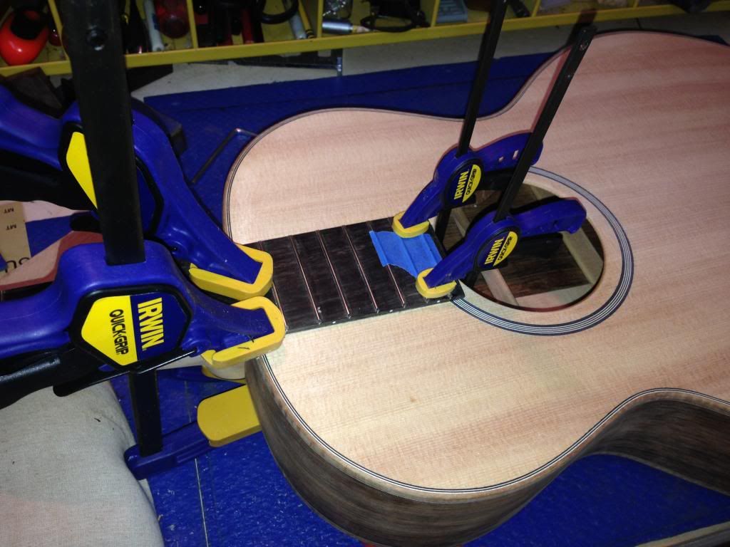

Back on your first page, you use a coping saw to make the cut at the back of the head. I nice 7 ppi ripsaw would make short and accurate work of that cut (no coping required) and a good one would set you back 10 bucks and an hour of your time with an easy sharpening.
Also, how did you ensure that the fretboard was at the right level with respect to the bridge when you glued the top on on? Did you jimmy things while you clamped it? And did things change when glued the back on??
Great looking wood, design, tools, workmanship and end product.

Hi Ed, Thx for your comments. Since this build has a bolt-on mortise and tenon neck, It's not all glued together yet. I'm still working on the bridge and saddle. Hopefully I will get the angle right.

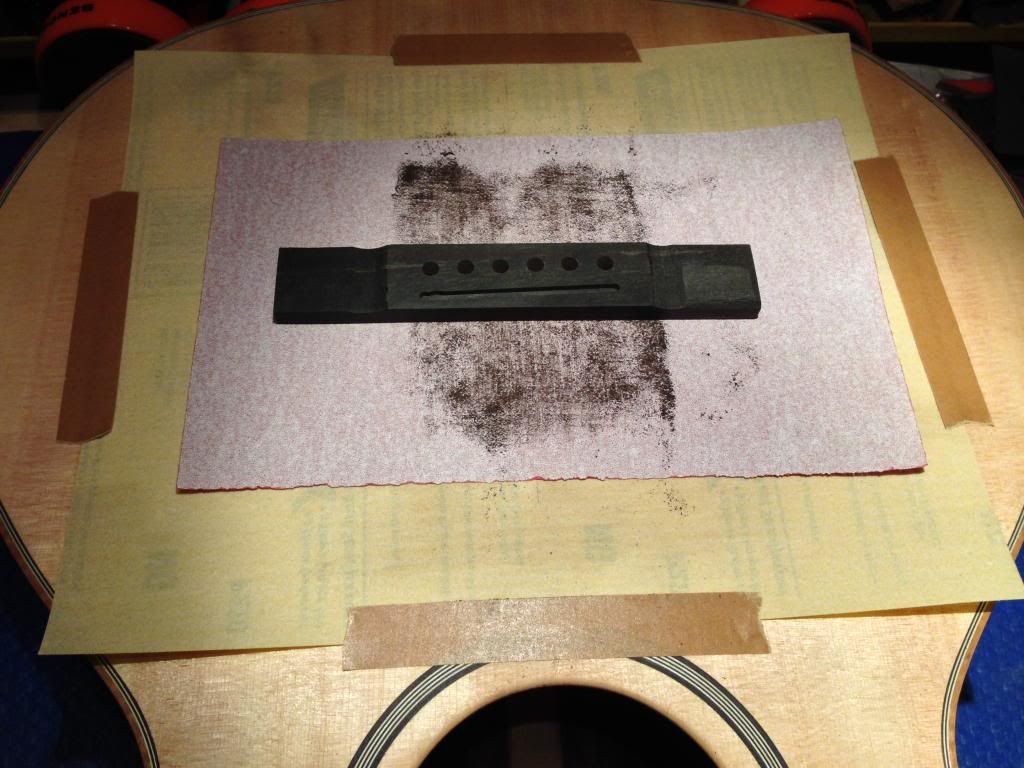

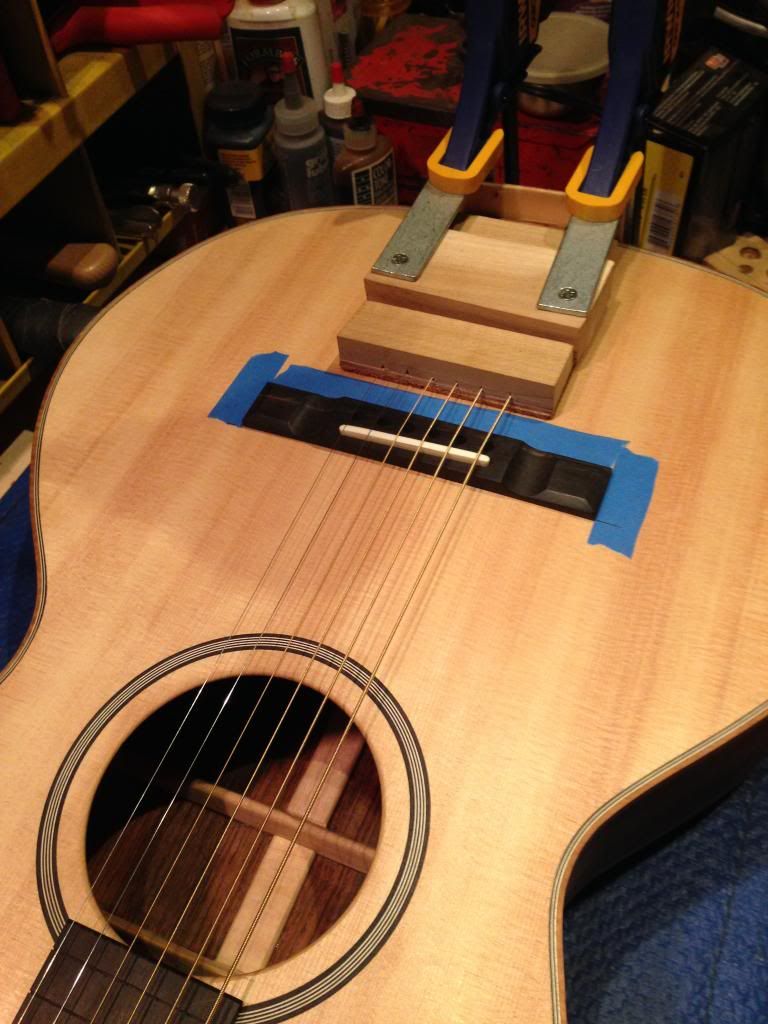

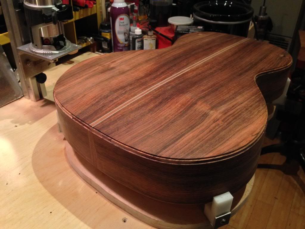

Status update: Working hard on the guitar, not as diligent on the thread uploads. Here's the latest stream of photos. Today I finished sanding the whole guitar and applied several sealer coats of shellac. Tomorrow I will pore fill. It's very exciting. It starting to really look like a warm, juicy guitar!
Sanding the bridge/belly contour.
A good joint.
Laying out the nut.
A jig to get an idea of what it might sound like. I think it's going to be good… Hoping, hoping, hoping…
Gluing the fretboard overhang with HHG.
The last naked mug shots.
Getting ready to apply seal coats.

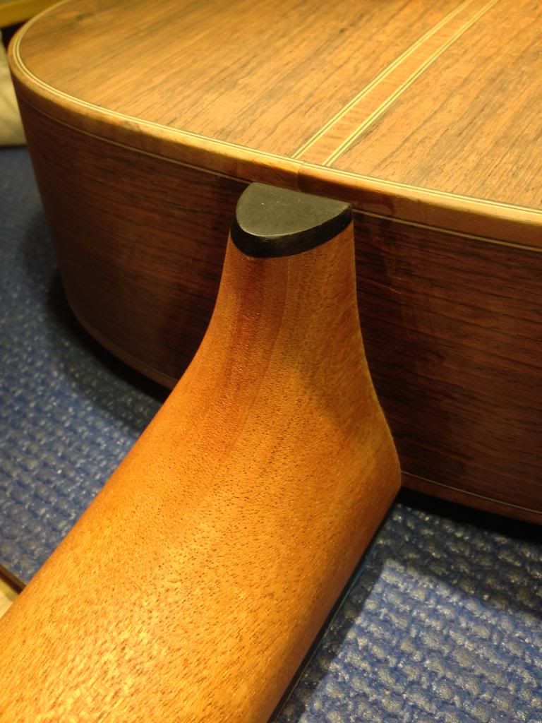

Some more:
My pad.
Sealer coat on neck, back stripe and bindings.
My volute.
Stay tuned...

Pores filled on body. Now on to the neck. She sure is a purdy color.

I gather by those dirty fingered rubber gloves that you went with the old school pumice pore fill method?

Thanks, Greg! I used a medium brown can of pore filler from Lmi. Pretty messy hence the gloves.
