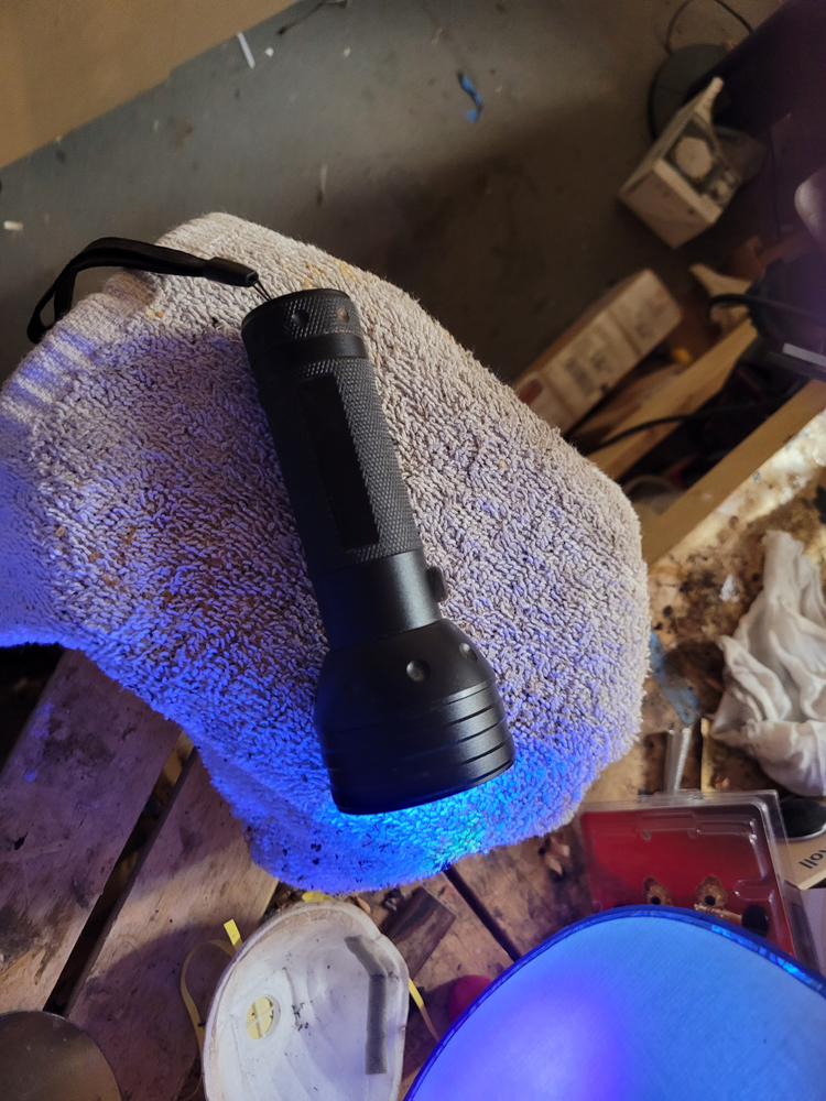

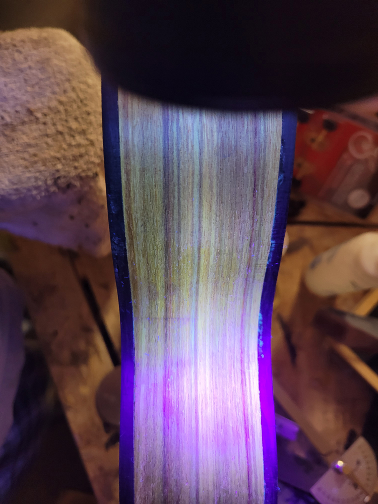

Before applying any finish or sealer check the instrument with a Cat Pee UV Flashlight Black Light. They are really handy and show up glue smears from most glues and a lot of other contaminates. Better still you could buy one for under $13.
I took a picture on an instrument I just bound for demonstration.
[img]$13%20at%20amazon,%20I%20am%20sure%20pet%20mart%20sells%20these%20as%20well.[/img]
