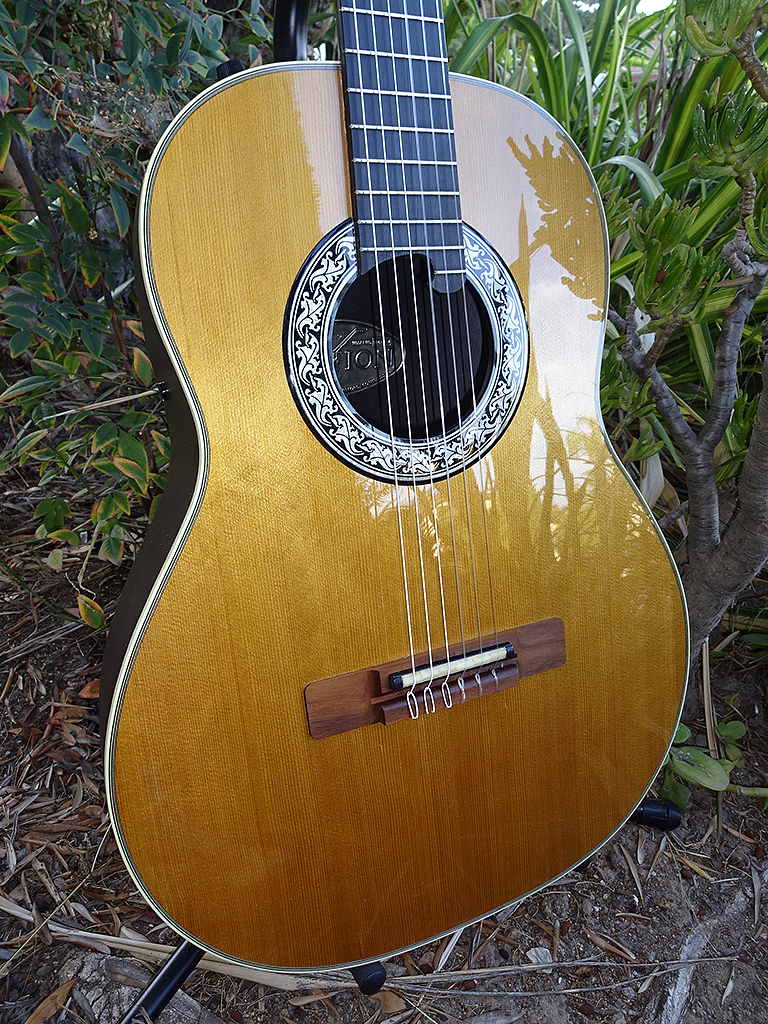

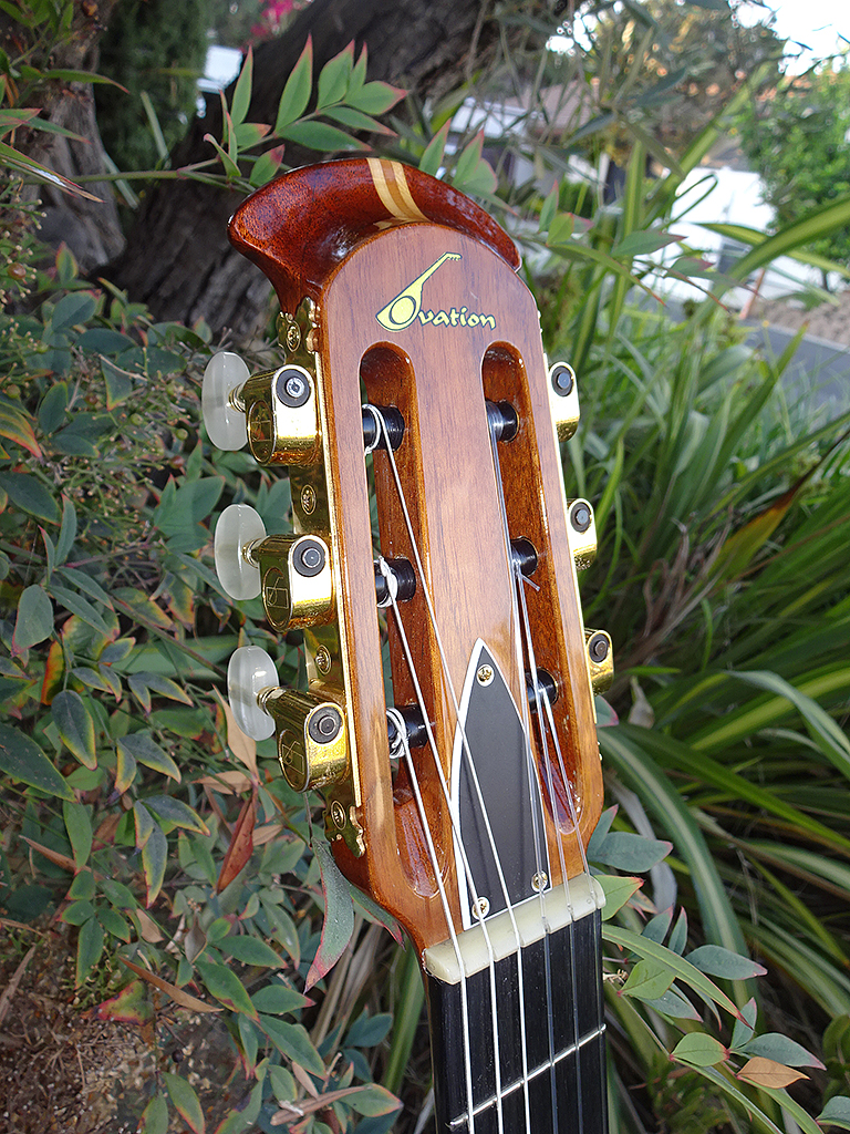

WRT the question about why someone would want to repair/restore an Ovation, sometimes it's for sentimental reasons. For example, Jen Chapin inherited her dad, Harry's Ovation 1613. It can be seen/heard in the YT video of him playing "Taxi" for a recorded show.
Long-story short, she was taking it to a gig and slipped on the icy sidewalk and landed on the guitar, completely busting/crushing the top and snapping the head stock off the neck. Over the years, it had also lost a couple of 'ears' on the headstock. Because I've worked on/re-topped Ovations, I volunteered to completely restore it for her. It got a torrefied Engleman spruce top with torrefied Adi braces and head stock repaired. FWIW, the top is jointed and braces glued with OBG.
What she got back was basically, a brand-new 50-year-old guitar.
Before:
After:
WRT dissimilar materials, mating a thin fiberglass shell to a wooden top isn't all that problematic. In a former life, I was an RC model airplane designer and manufacturer. Modelers have been joining fiberglass and wood for many years without issue.
The bigger problem with Ovations is their use of thick polyester resin for the finish on the top. The problem is that polyester resin continues to shrink over its lifetime and the shrinkage is exacerbated when exposed to heat and/or UV. The cracking you see on Jen's 1613 is due to finish shrinking, not because the wood top was joined to a thin fiberglass shell.
Before:
After:
Here's the top from an Ovation 1113 that I re-topped several years ago for a friend. I've removed the bridge and braces to allow the top to curl for the photo to illustrate the shrinkage.
On all Ovation re-tops/restores I've done (~15 and counting) I use epoxy (EA 0151) to glue the bridges. I do this to duplicate Ovation's method of construction. I used to use Hysol EA 9462, but it's grey in color and has a Tg of ~250° F which makes it unsuitable to luthery.
On the whole, with the exception of Ovations, I agree with you and everyone else, that epoxy should not be used on a guitar.
