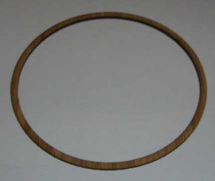

I've been experimenting with cutting solid wood rosette rings using my laser.
Pro: Apart from saving a whole bunch of time, I end up with a nice coaster with no hole in the middle 8-)
Con: The edges are always slightly singed from the laser cutting process, however, once the piece is inlayed and sanded level, you don't see the edges.
Here's a 1/8" bamboo rosette ring I did recently:

Dave your rosette looks great [:Y:]
I would be very interested in learning more about your "laser Lutherie" so would you consider starting a thread showing us your rig and how you use it?
