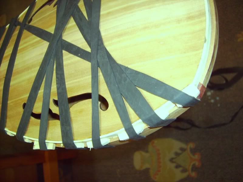

Break the inside edge of binding.
Wrap with long approximately 1/4 inch wide rubber strips cut from truck tire inner tubes, installing little wooden sq blocks 1/4 inch x 1/2 to 3/4 inches long that have been waxed to prevent sticking to any glue.
This method will help in closing up the top gaps. Sometime me haz to wrap the same block 2 or 3 times
Small clamps will help close up the sides gaps.
This is a slower process and therefor suggest a white glue because of its longer open time.
In this pic of you can see the blocks holden the 1/8 inch holly purfeling up snug while the glue sets. Actually it was right after these blocks stuck to the purfeling that me made and waxed the ones me first described. Then the rabbit and the purfeling will be cleaned with a chisel scraper and sanding blocks like the one below before process is repeated for the outer banding.
Be happy you are only binding a simple S curved rabbit.
In my work the binding edge is a compound curve ~ as much as 1 1/2 inches rise or fall along the face of the rib, which causes the banding to twist leaving gaps. Then my top and bottom plates are not flat nor are the ribs...translates to a real hassle cutting that rabbit and in getting the binding to snug up on both the sides and the edge...the little blocks applied under the rubber and the clamps help.
Sometimes the banding me using is 3/16 thick and up to 2 inches wide which is prebent to one profile curve and then scribed cut and fit to the other curve to avoid gapping from twisting.
Hope this helps.
blessings
duh ?adma
