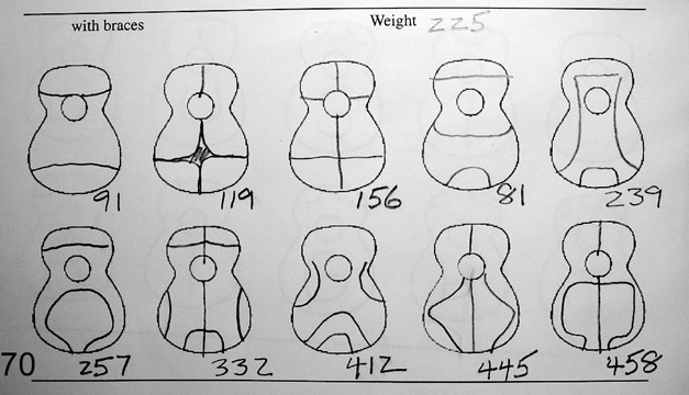

Posts: 332
Here's a sample set of fairly typical looking modes for one of my braced tops. The bracing is symmetrical and similar to the Larrivee pattern. Sometimes it is easier to find the modes if you have an idea of what shapes you are looking for.
It's a OO size spruce top, 14 1/4" lower bout.

PostPosted: Sun Mar 09, 2008 2:21 pm
Posts: 332
First of all a correction.... the mode at 81 Hz should be 181 Hz.
Those shapes are what the modes looked like when I finished carving the braces. During the carving process I routinely check them to see how things are shaping up. I don't look at all of them every time but I do look at all of them now and then through the carving process just to make sure none of them are getting out of line.
Mostly I monitor the fifth one (239), the sixth one (257) and the tenth one (458). 6 and 10 are the only ones that really have the potential to form "closed" shapes. The others are more of a concern to me in terms of their frequencies. The frequencies can help me get a handle on how stiff the plate is in the areas that are the most active in each of the modes. There is also a directional aspect to each mode. The first mode (91) mostly indicates stiffness in the same direction as the grain. The fifth one (239) mostly tells me about the stiffness across the grain in the lower bout, especially the area below the soundhole.
The trick, of course is to know what distribution of mode shapes and frequencies will indicate a mass and stiffness distribution that will in turn produce a guitar that sounds the way you want it to. There is no universally "correct" mode set. But there can be a set that tends to produce guitars that you will like.
What I try to do is correlate what I see in the modes with what I hear in my guitars and then use that information to help keep me on track to building in the good stuff and avoiding the bad stuff. The only way I know of to figure out which is which is to build a bunch of guitars, keep records and look at he data to see what the great guitars had in common and what the not so great ones had in common.

PostPosted: Sun Mar 09, 2008 4:40 pm
Posts: 332
Alain Lambert wrote:
Mark, this is very interesting.
Can we relate some of these frequencies to the different modes of the guitar. Like cross dipole, monopole, etc.?
Sure. Generally speaking a free plate that shows cross grain modes that have frequencies that are higher than usual relative to the long grain modes, will tend to produce a guitar that has a cross dipole that is higher than usual compared to the long dipole. The opposite is true as well. If the cross grain mode frequencies are low relative to the others on the free plate , then the cross dipole on the finished guitar will tend to be lower relative to the other modes.
I have found that lengthwise to crosswise stiffness ratio that is intrinsic to the top wood itself will tend to telegraph right on through to the modes of the finished guitar. It is possible to shift the ratio somewhat with the bracing, but only so much. The properties on the wood itself tend to dominate. You have to do fairly drastic things with the bracing to overcome the inherent properties of the top plate itself. At least in terms of what shows up in the modes.
Mark
