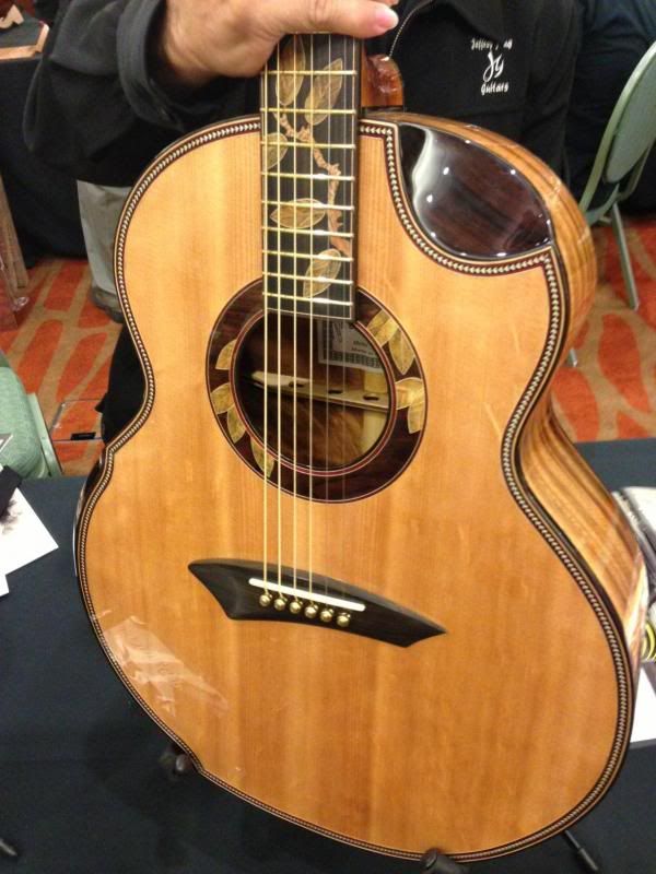

I have been asked to include a partial cutaway on my next commission and I have never made one. Any help would be appreciated.
I have included a pict of an example.

There's a tutorial in a recent 'American Lutherie' on how to do that. He starts with a block and carves it to shape. I prefer to bend a piece of wood a little thinner than the usual side thickness, and put in liners on the top and side to support it. My sequence is to bend the piece, make the cut to fit pretty closely, put in the liners, and chalk fit from there to get it just right. Burton LeGeyt, the maker Ipicked uyp the idea from, makes the cut and bends the piece to fit. To each his own.
The main issue with this is getting the purfling in around it. So far I have not been able to think of any way to do it other than hand cutting it in, which calls for some serious tool chops. I suppose you could jig up for it if you had really tight control over the side and cutaway shape, but that's beyond me.
I like to make a 'recurve bevel'. I bend the piece for the cutaway into an S-curve, so that the outer end round off and ties in with the binding. It looks a little more 'finished' to me. There should be some pics of one of those guitars in the article about Ken Bonfield in the January 'Acoustic Guitar'. I haven't seen it yet, but he's using one in the tutorial on their web site.
