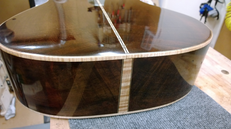

I really like the stuff.
Here is an example of the kind of gloss you can get:

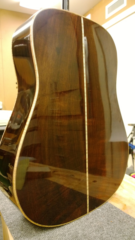

I did the pore fill with zpoxy. I sprayed 15 coats of EM6000 at 3 mils a coat, I did no level sanding in between any of the coats. It only took about 45 minutes to sand level and buff.

All these examples look wonderful but my experience has been other wise. Well, I could show a pic of one that came out stellar but then for each one of those was another one that was less then par. I can't be consistent using water base and I have tried several. I love it because it's non toxic yadda yadda but I can not control it so I gave up using it.
