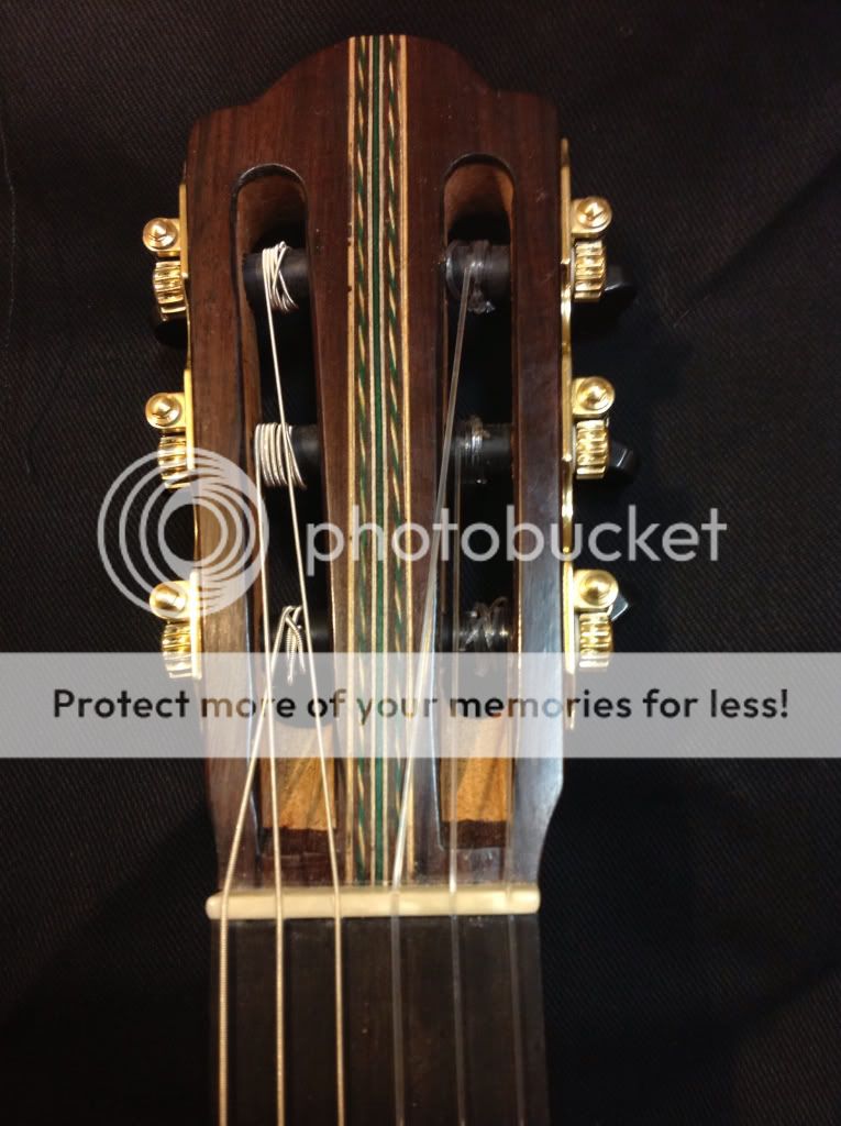

This guitar barks like a mad dog, but in an angelic songlike sort of way.
The client wanted a guitar that sounded "as good as" my daily go-to classical.
I promised him that if I had known what I know when I built the first one, it would sound even better.
And I followed through.
Big, deep bass. Balanced, rich trebles. Throaty top end, all the way to the high b.
Every detail came from the Brune' plan (except the sideport, which I believe to be an upgrade from the original). The rosette was purchased from David Schramm. The rest was made in my shop.
All binding, purfling and the headstock inlay were made from scratch.
The top is Engelmann Spruce, Back and sides are EIR, neck is Spanish Cedar.
Here are a few photos
Hope you enjoy,
Dave

Looks great, cool headstock inlay!
Still trying to get my head around:
"barks like a mad dog, but in an angelic songlike sort of way" ....
I am going to keep that in mind as a design goal when I build my next one... :-)

Dave, I have a couple of questions as I build that type of guitar as well.
1) Did you use Brune's soundboard thickness dimensions or go closer to David Schramm"s recommendation of .090 for Englemann.
2) What is your string height at the bridge saddle? It looks like a lot of saddle exposed over the bridge, but that might be an illusion,
thanks, Mike
PostPosted: Wed Sep 04, 2013 4:13 pm
Joined: Sun Sep 16, 2007 1:27 pm
Posts: 716
Last Name: Livermore
State: Minnesota
The top thickness was pretty thin as I recall. I dimension it quite intuitively with my drum sander and tend to stop when it feels about right.
I stopped a little later than I wanted to on this one. Right after the cross grain stiffness started to get a little flimsier than I like. But it rang like it should have and I went with it.
The saddle height is right at 12mm above the top.
DL
