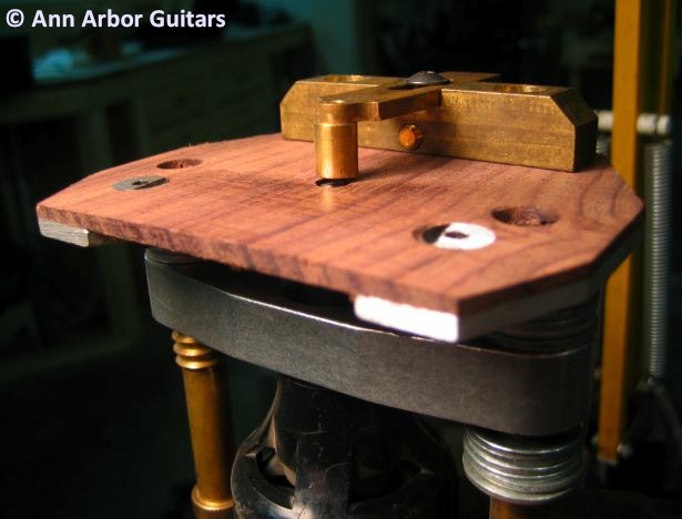

Did you leave the bottom of the bridge flat, i.e. not shaped to match the belly of the soundboard?

Thanks Todd. Though I didn't get in to showing it, I do curve the bottom of the bridge to fit the top best as possible.

Sometime I'd like to see how you route that little ledge around the bottom edge of the bridge. It seems like it would be a bit tricky with the bottom of the bridge not being flat.

This is about the only thing I use a Dremel for anymore. I radiused a rosewood cap for the base and keep this setup as a dedicated ledge router, clamp the dremel in a vise and treat it like a mini router table. The curve is exaggerated to fit the most extreme radius, so an average bridge can wobble on the center and you do have to make sure it's held firmly against the base right over the cutter. It's set up so that it can't cut too deep though, only too shallow, so I usually just go around 2 or 3 times to clean it all up and make it even.

David, one more question about the dremel set up, if you don't mind. Did you fabricate the brass guide from scratch yourself, or is that an existing guide (modified, perhaps)?

If one doesn't like power tools, I guess the bridge ledge can be made simply by clamping a scraper to the bottom of the bridge then cut the ledge with a sharp 2mm chisel. I just tried it and it goes well if the chisel is well sharpened and you take it light and slow.

Todd, no I didn't make the brass guide myself. It's an old StewMac guide fro binding slots (not sure if they still make it) and a StewMac Dremel base. The one before this was much simpler - a cheap laminate trimmer screwed to a piece of plywood and mounted on four legs. For the guide I just used a chunk of wood with a notch cut out, and basically a rod anchored in it come down over the cutter as guide. For adjustments, I just cut the two clearance holes on the guide block a bit oversized, and would loosen, reposition, and tighten to set the cutting width. Same radius cut in the top on that, but it also had a spring-loaded guard/guide to hold it down directly on the cutter - didn't really work that well, so I dropped that feature on this one.
