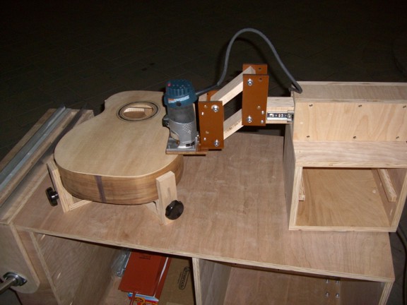

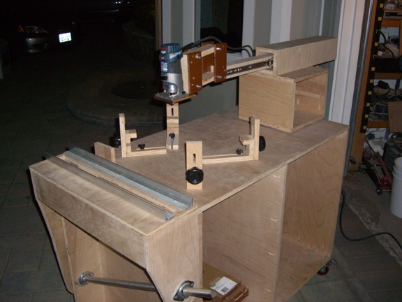

I finally found time to finish my version of the Fleischman/Williams binding jig - Yay! [:Y:] I built it onto one end of a mobile work unit with a compound fretboard radius routing jig at the other (I posted a thread previously showing the fretboard routing jig). I decided to do the tower/drawers different from what I have seen other people do. I made the tower larger (width wise) and set the open side at 90 deg to the binding jig "jib" so that I would have unfettered access to the drawers, and so the drawers would be larger to hold more junk, while still providing a very stury base for the binding jig. Here's some pictures I took just now - it's dark outside, so the photos aren't very good, sorry. I'll post some more when I've built the drawers for the lower unit and the tower unit and have actually routed my first guitar.

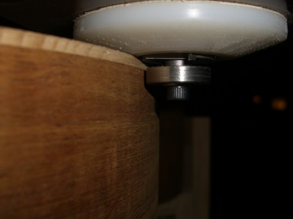

I turned a UHMW ring on my lathe using a small bowl gouge:
It's mounted on a new phenolic router base using double-sided turner's tape - should be strong enough to hold it (we'll see!):
Operators view:
Offered up to my first guitar body mounted in the cork-lined holders:
The 1/8" wide lip on the edge of the UHMW ring rides nicely on the edge of the guitar:

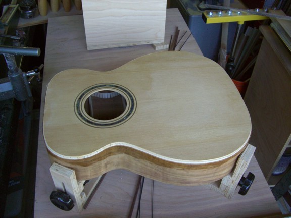

I spent most of the day at a Wood Turners and Carvers Show - I was manning a booth for the Northern California Marquetarians (we were invited to show off our stuff). When I got back, I got stuck into doing the routing for the binding/purfling for the top of my first guitar. The routing went easily - I believe it when people claim they could do the routing blindfolded using this jig now!
I remembered not to route the binding by the end graft (just in time!!!). Then I very carefully used a very sharp chisel to trim the miters at 45 deg so the b-w-b strip at the bottom of the binding would look right on the end graft. That bit went well too.
However, when I got to bending the EIRW binding strips to shape using my StewMac electic pipe heater, I ran in to trouble. I snapped 3 EIRW strips trying to bend them very very slowly to the right curve gaah . I gave up on the pipe heater and switched to trying to heat the whole strip at once using a heating blanket between thin stainless steel sheets. The wood got a bit bendier, but it still snapped as soon as I tried to coerce it into shape. [headinwall]
At this point, I realized I wasn't going to be able to do the binding until I knuckled under and built my Fox style bending machine. I have all the parts. I just need to cut the wood and build it. Seems like it's just one jig/machine after another needed right now. At least when I'm done, I'll have all the jigs and machines ready to make #2 and subsequent guitars MUCH faster!! 8-)
