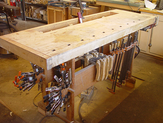

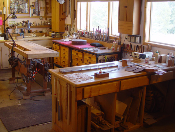

Here are some of my thoughts on work benches....
I have four benches in a cluster in one corner of my shop. I spend most of my time in the middle, surrounded by benches. This allows me easy access to all of them without having to put in a lot of mileage every day in the shop. Each of the benches is unique in design and serves a specific purpose.
The central bench is a classic cabinetmaker's style bench. It is nice to be able to walk all the way around it. The trestle stand serves as clamp rack and makes it easy to reach them form any of the other benches.

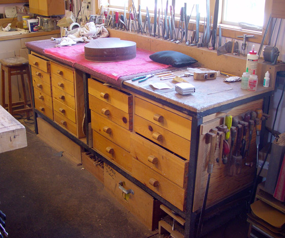

The bench under the window is made of thick angle iron. I think the framework alone weighs about 200 pounds. It is very solid !! I built two banks of drawers to fit it. Having a large number of drawers within easy reach is great for organization and a real time saver.

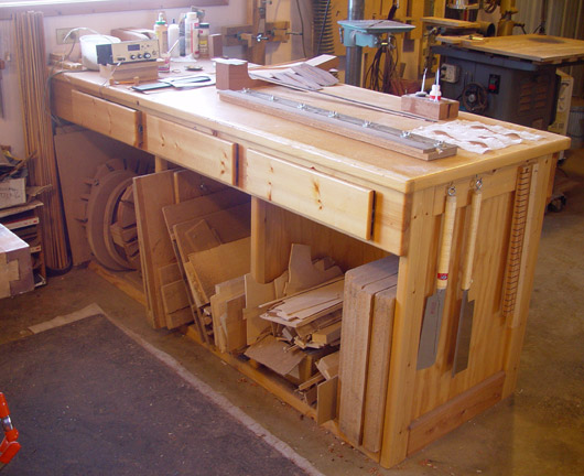

The third bench I made to provide storage for, and easy access to, my stash of radius dishes and other workboards and molds. It is open on both sides. A few drawers on each side provide additional storage for small things. The top is two layers of 3/4" particle board. It is solid and quite flat, a good reference surface. There is a large shelf unit about four feet above it so the entire bench is a go deck !

Perhaps these examples will give you some ideas....

excellent work shop Mark!!
Thanks for sharing. This gives me alot of ideas.

Mark, you've gotta have one of the nicest shops out there - great light, lots of room, traditional "feel" - love it!!
