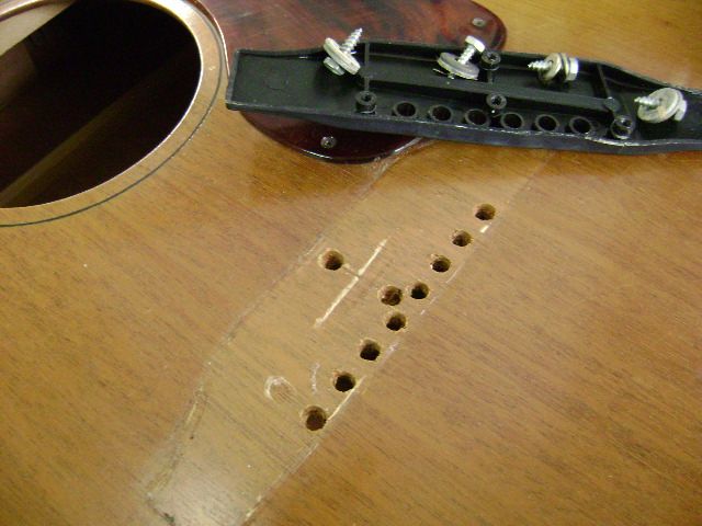

PostPosted: Thu Jan 21, 2016 1:11 pm
Joined: Tue Nov 11, 2008 9:13 pm
Posts: 835
Location: Durango CO
Last Name: Farmer
City: Durango
State: CO
Got one on the bench in front of me this very am Ken. Let's not forget the horror when combined w/ a Spruce plate. wow7-eyes
4 bolts wasn't enough. Maybe a 5th would do it.

PostPosted: Thu Jan 21, 2016 3:00 pm
Posts: 1737
Location: Litchfield MI
Quote:
What were they thinking.....
No doubt seeking superior tone!
These users thanked the author david farmer for the post: Hesh (Sun Jan 24, 2016 6:33 am)
