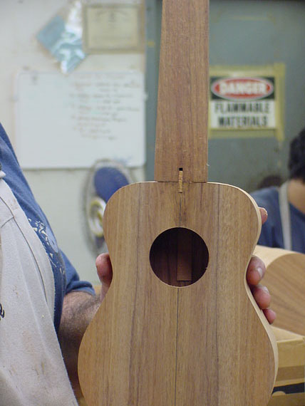

Here's a picture of a Kamaka neck joint (date unknown) from frets.com. I've read that for a period dowels were used, but I believe the spline is most common.
If the joint feels sound I'd be tempted to set the neck angle when glueing the back on again (and those loose seams might well explain why the action is low, as they'd allow the neck to pull forward). In any event make a jig to hold the neck and top in alignment when refitting the back- once it is off you will find the body can flex quite a bit!
Players seem to like 2 to 3mm action at the 12th fret (2mm is distinctly low, 3mm a touch high but good for heavy strummers). Lower than 2mm is likely to buzz. On my own, light, builds the bridge tends to pull up about 0.5mm, so I aim at 3mm action before string tension and adjust down to 2.5mm at the saddle.
