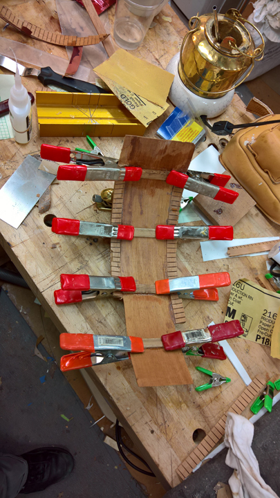

I made an insert that included a tongue to reinforced the intact but cracked area in the sides and kerfed linings to replace the missing linings and assure a good glue joint to the top and back. I was going to use a 1 mm cross grain strip, but could not find one long enough. Instead I thinned an orphaned side to 1 mm, bent it to shape, installed the kerfed linings then I fitted and glued it into the guitar. It is recessed in about 1.5-2.0 mm to allow me to inlay a mahogany veneer.
A couple of orphaned sides to work with. I pick these up in the sale bins on the various tonewood sites. Often they sell a batch of unlabeled sides cheap

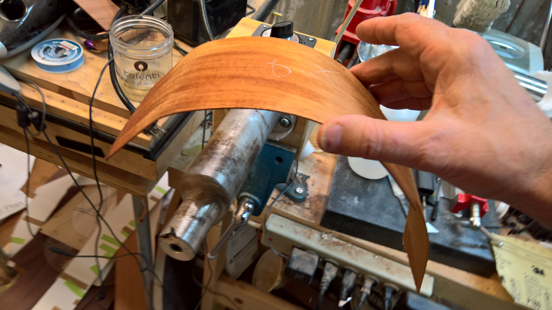

I made a cardboard template for the insert.
I bent the insert to the correct shape. It took a bit to get it to fit in the guitar. Once fitted I installed the linings and some reinforcement strips.

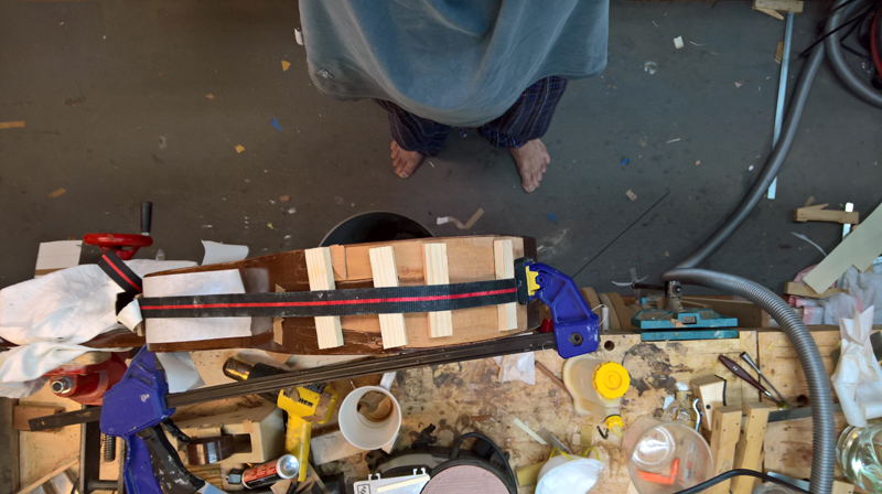

Instead of gluing all at once. I used hot hide glue to glue the tongue inside the cracked area. I made special shaped cauls attached to a spreader clamp to some what gently provide an internal backing. (sorry no pictures). I installed a few small cleats on the top and back to help me set the depth on the insert.
With all of the in place I was able to use hot hide glue to glue the insert onto place.
The small gap is where the back brace comes in. The kerfing was inset to the accommodate the brace.

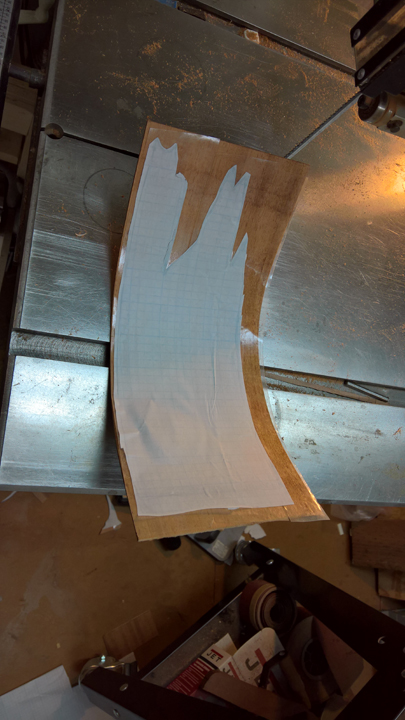

The neck step is to make the veneer. I traced the shape onto some paper using a pencil to highlight the edge.
I cut out the pattern and spend a bit of time getting it to fit by fitting it to the guitar. When ready I taped the pattern to the inside of the side patch and cut close with a band saw.
