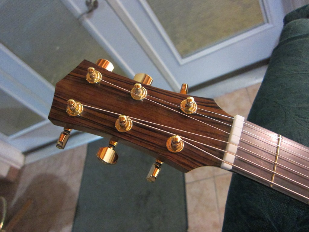

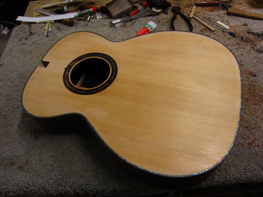

I actually started this one several months ago, and decided to let it wait while I finished some less expensive guitars. This is the first one I paid much money for the materials. Usually I use cedar and mahogany from Menards. :D

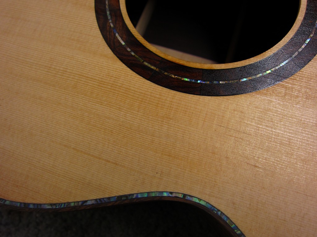

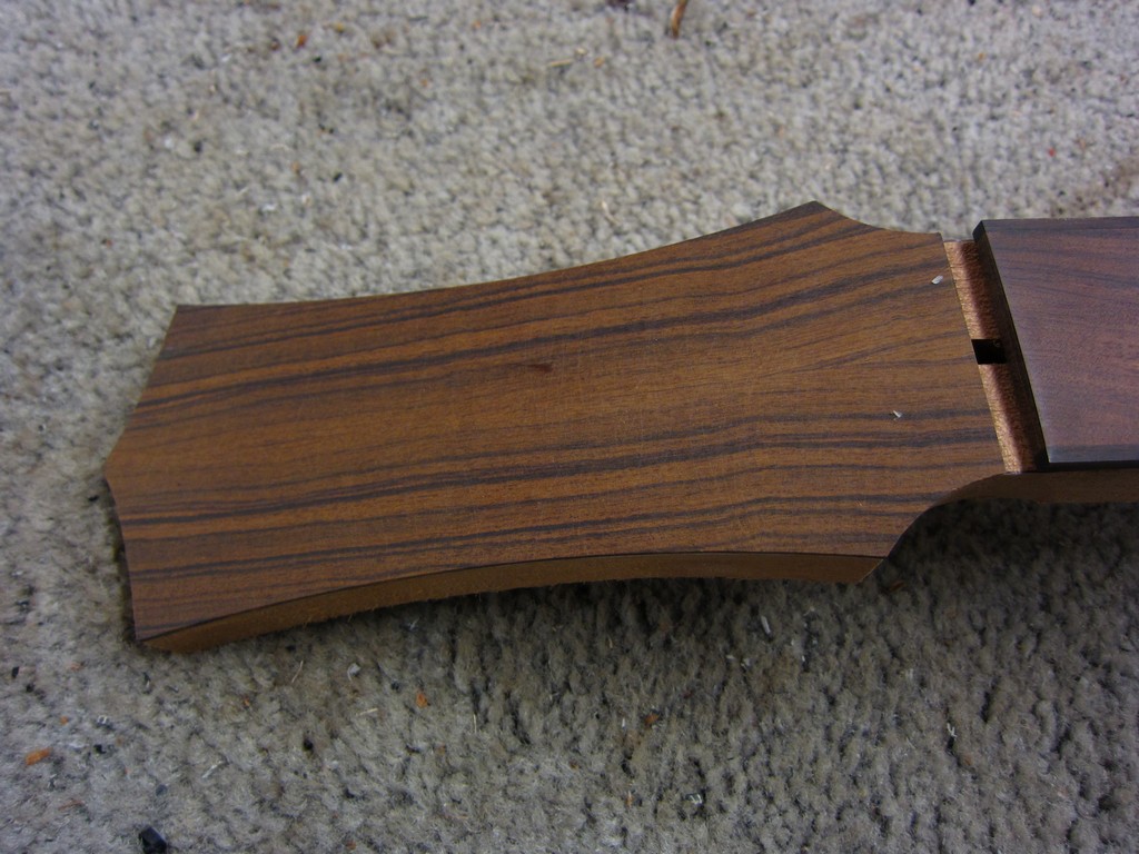

This one is EIR from Grizzly, Sitka top, desert ironwood bindings, headstock veneer, fingerboard, end graft, and bridge. Zipflex purfling, front and back.

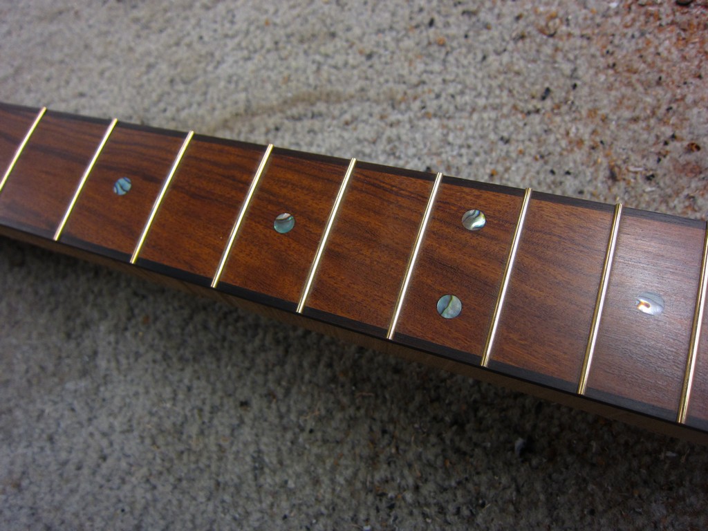

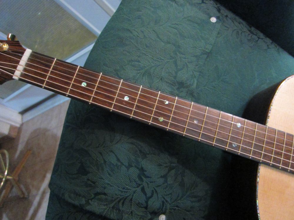

The fingerboard is bound with rosewood. My first bound fingerboard.
Gold fret wire. The tuners will be gold.

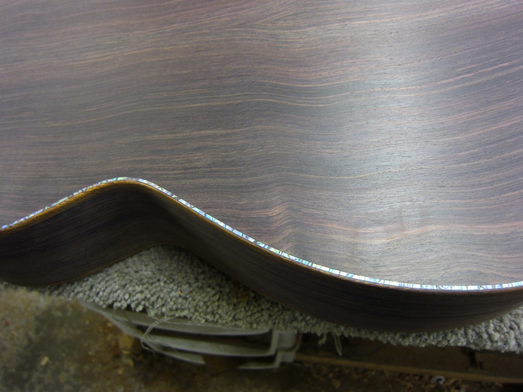

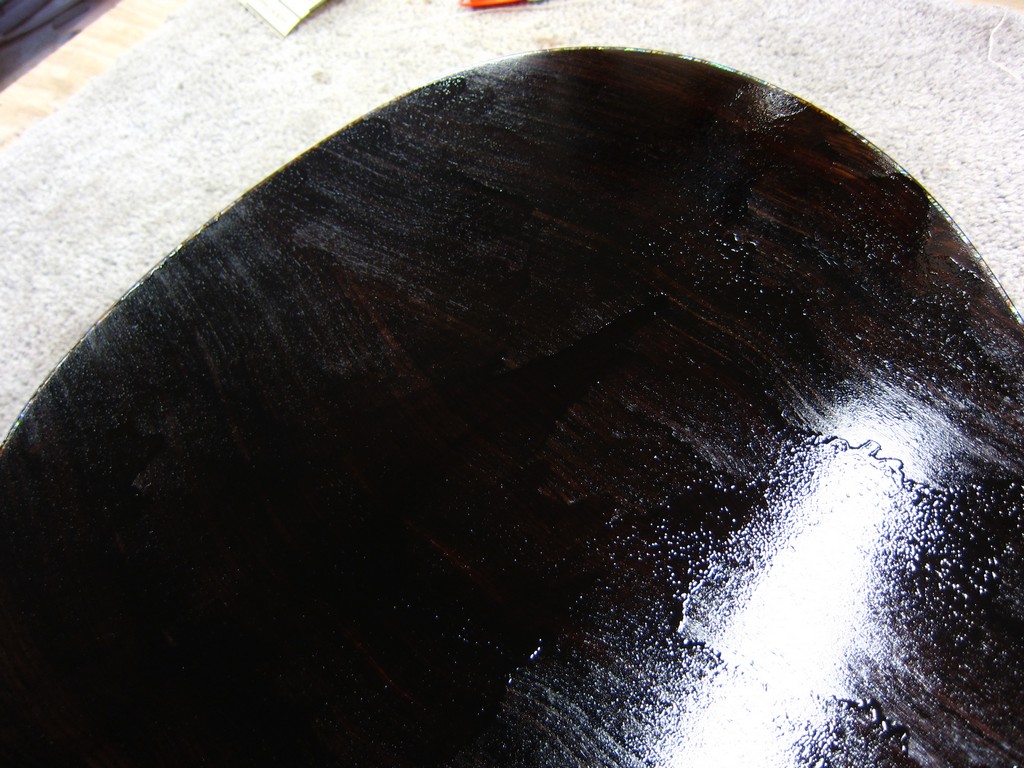

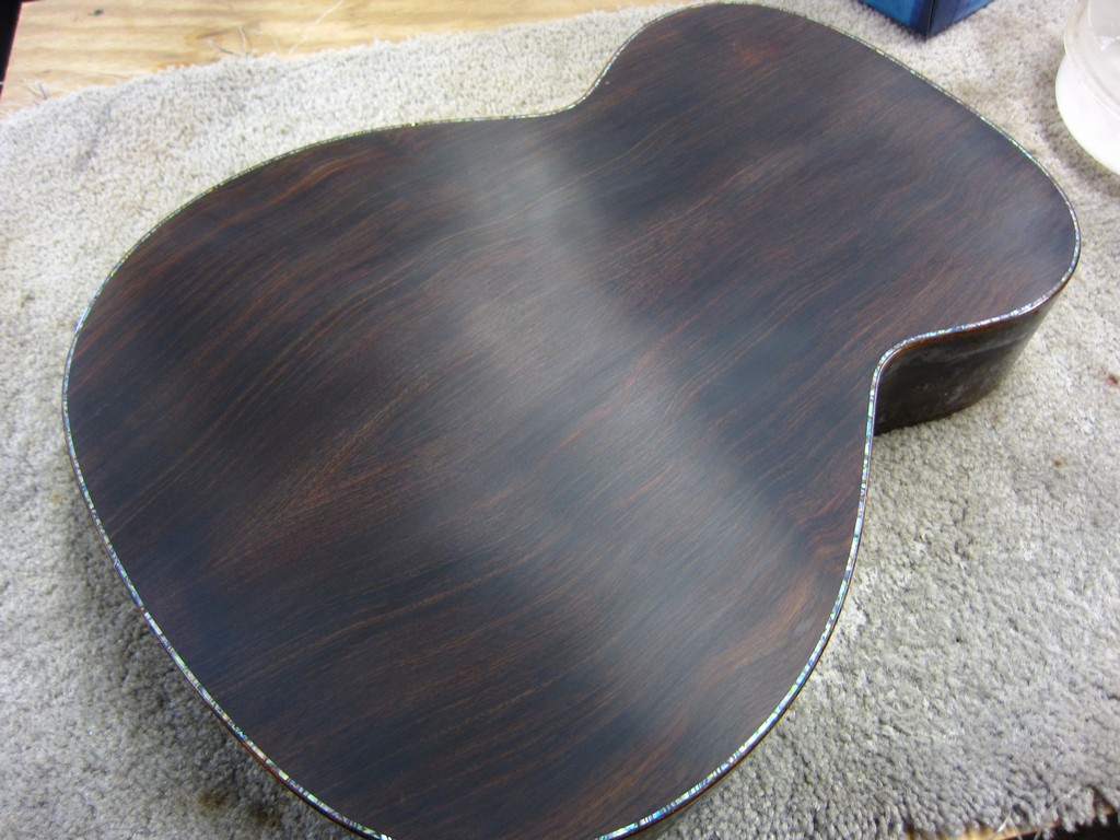

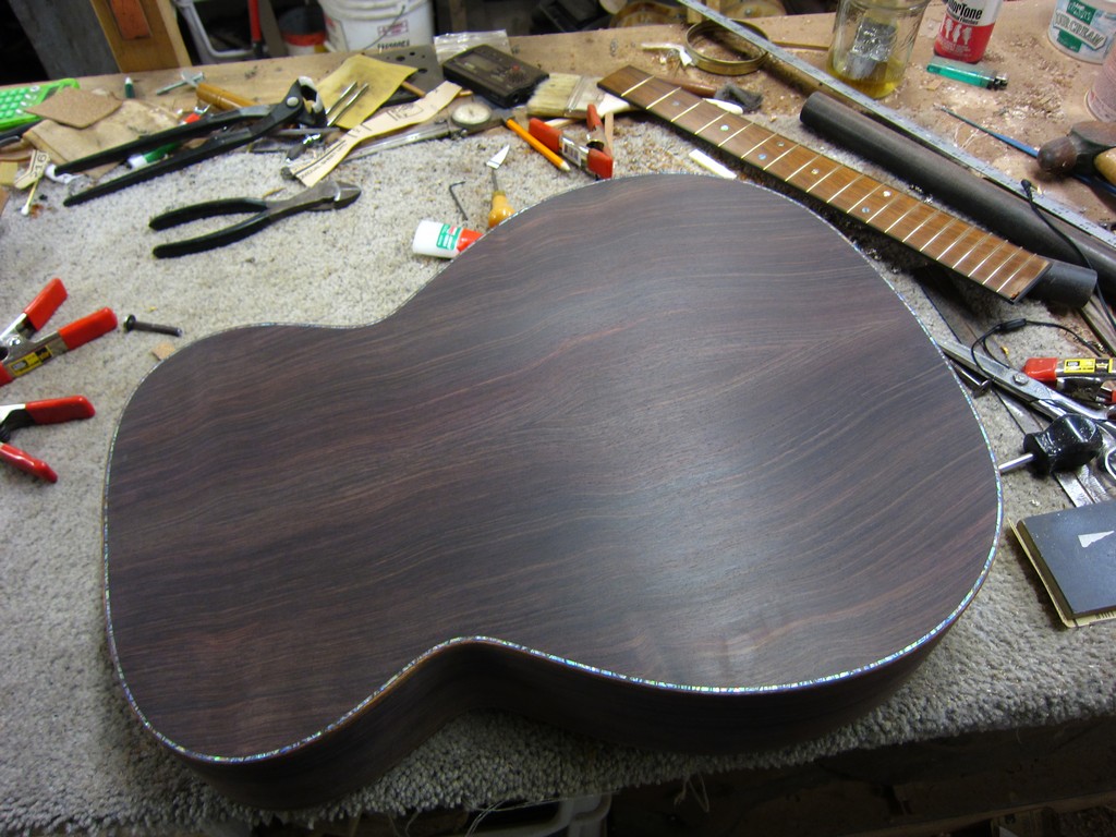

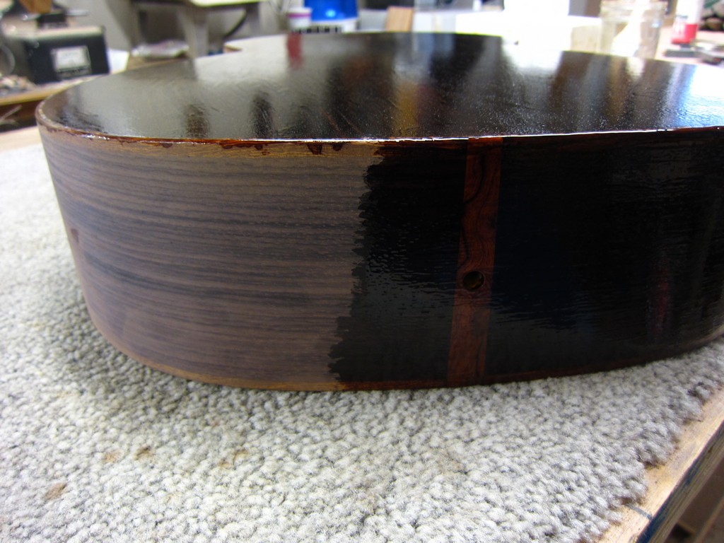

Today I finished sanding the back and sides. Now I'm going to try using shellac to pore fill.

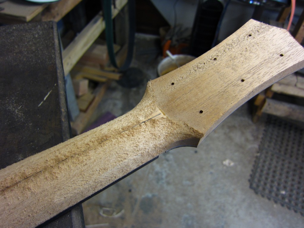

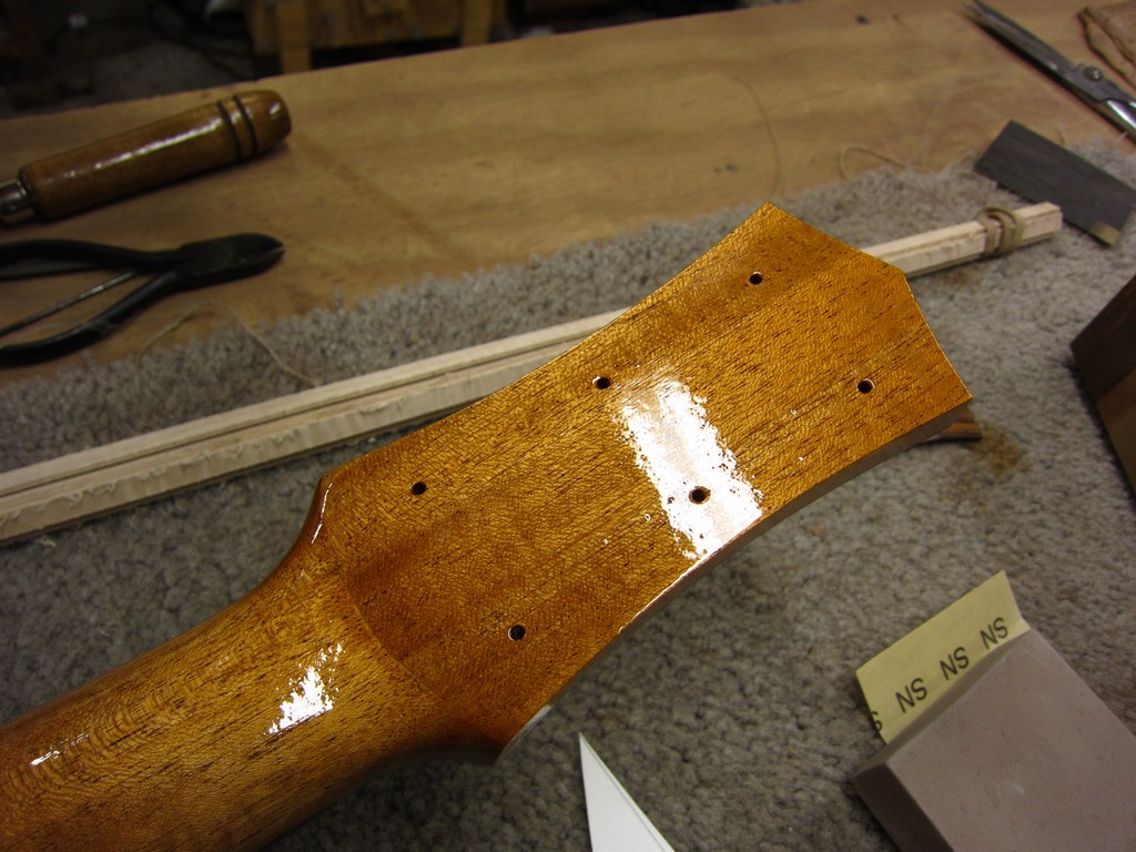

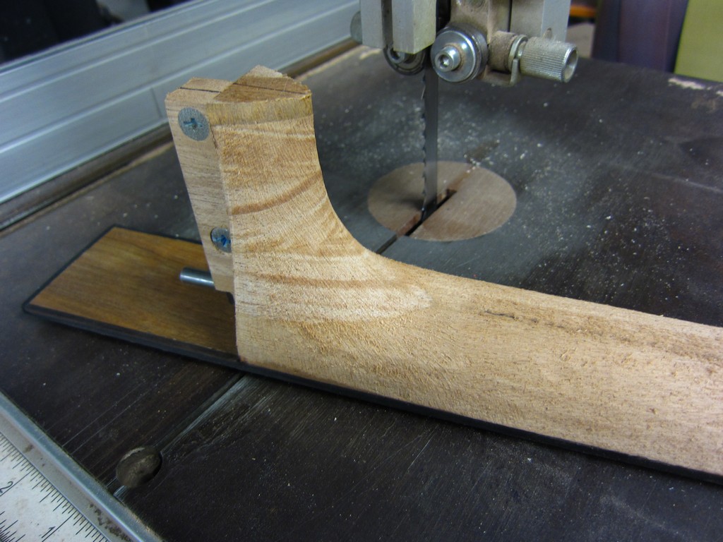

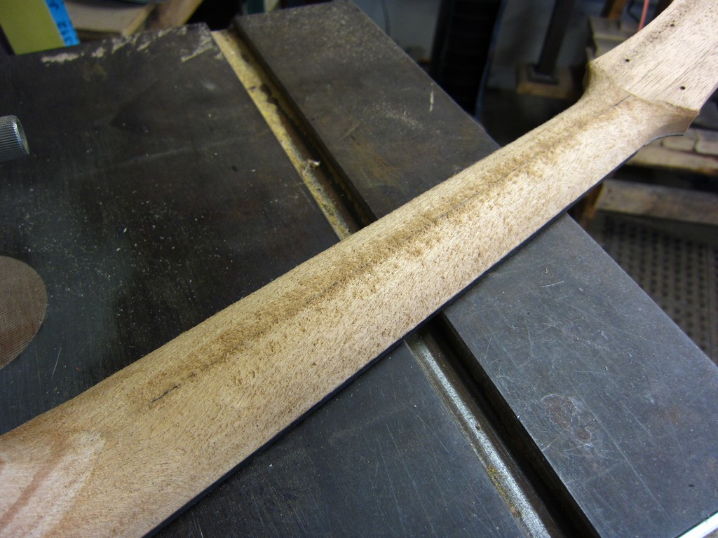

Also shaped the neck:

Beautiful!! Can't wait to see it finished. Really like your use of the shell, big fan of the small ring in the rosette. Tell me how you liked working with Zipflex. I'm thinking about ordering some to use on a future guitar I'm designing.
Keep up the good work.

Thanks Jeremy!
I love working with the Zipflex. It is expensive, but worth it in the time saved. My only complaint is the engineered breaks every 1/8". Not too noticeable though if you're more than a foot or so away.

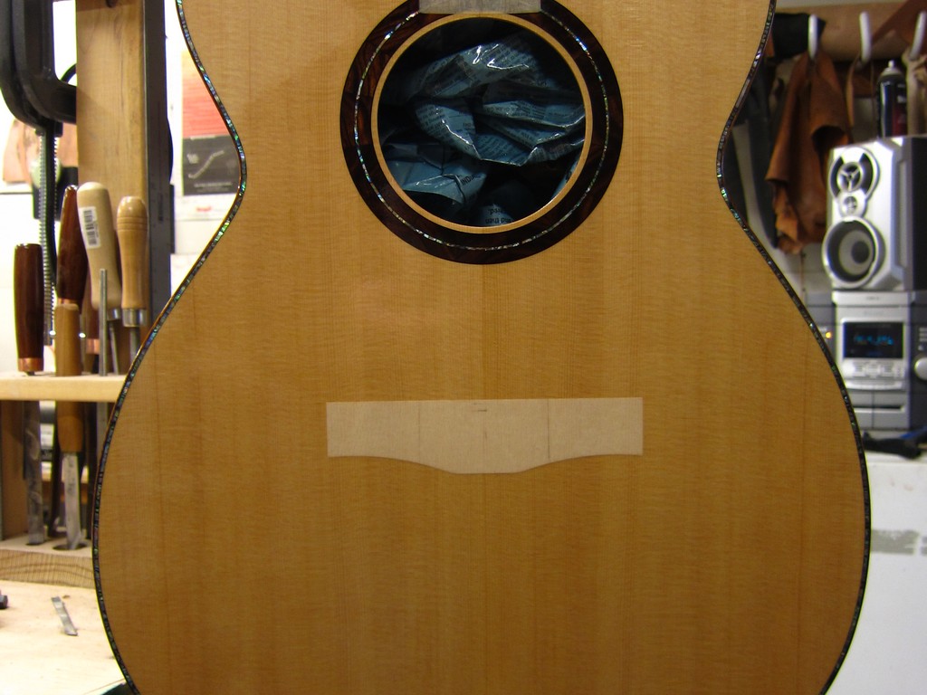

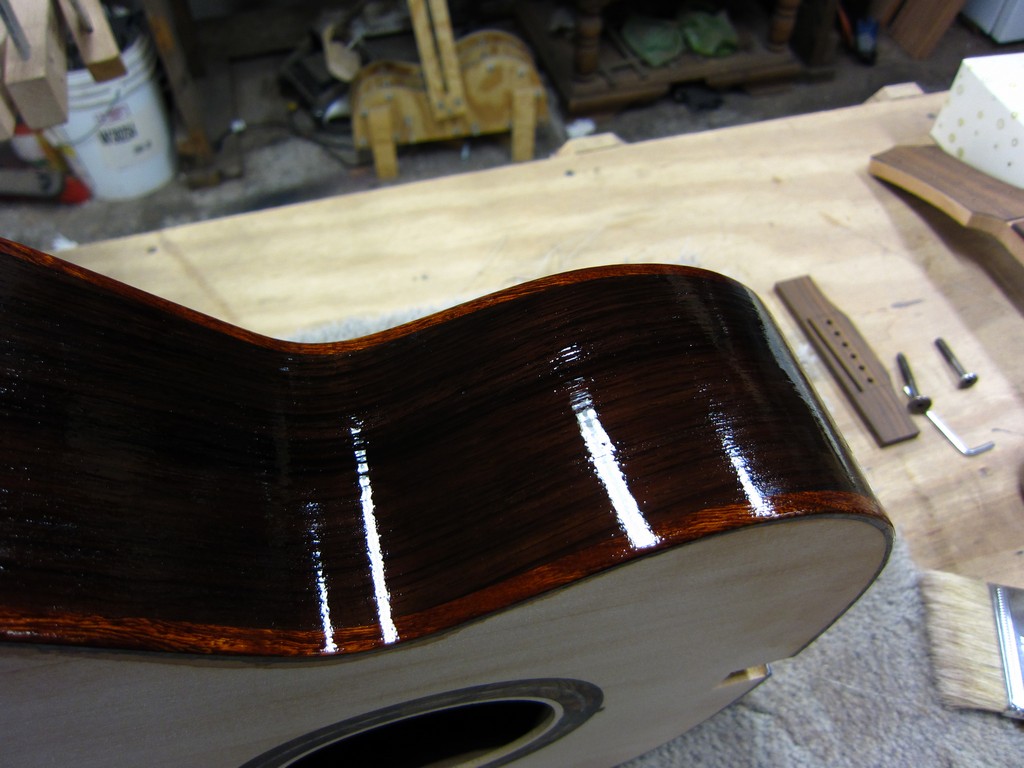

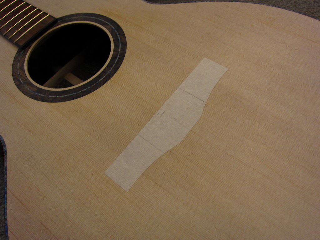

Today I located and masked the bridge, masked the fingerboard, and started spraying. [:Y:]

Thanks! It's all sprayed now and hanging in my closet. Should have finished pictures in a few weeks. bliss

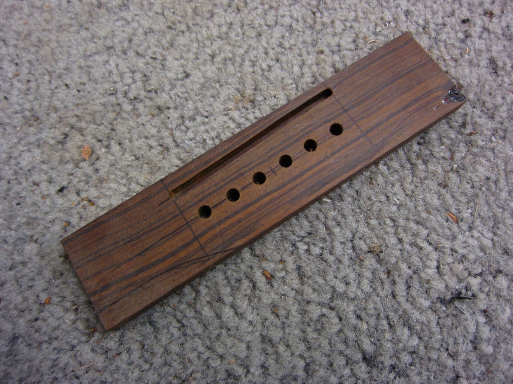

That looks flawless to me, and mighty tasty wood choices throughout, too. I'll be lined up with everyone else to see pics after it's polished out and strung up. Congratulations.

Wow, looks great!
Nice proportions in the upper bout.
I really, really, love the shape of the bridge. Oh ya. I gonna steal that fer sure!

Love that flared bridge

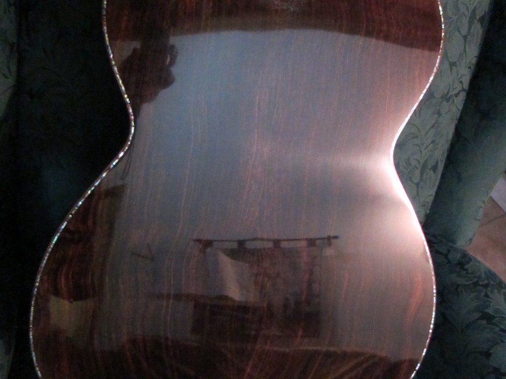

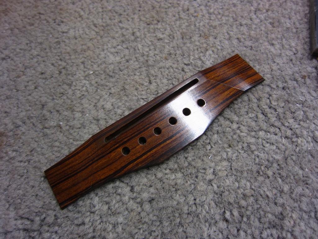

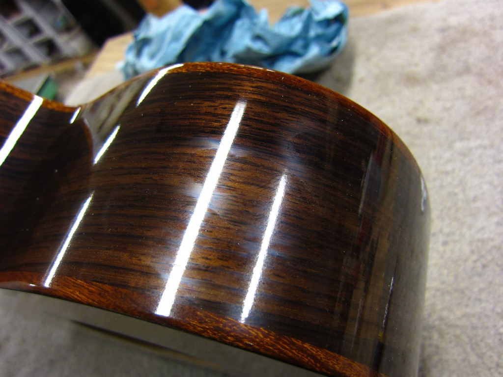

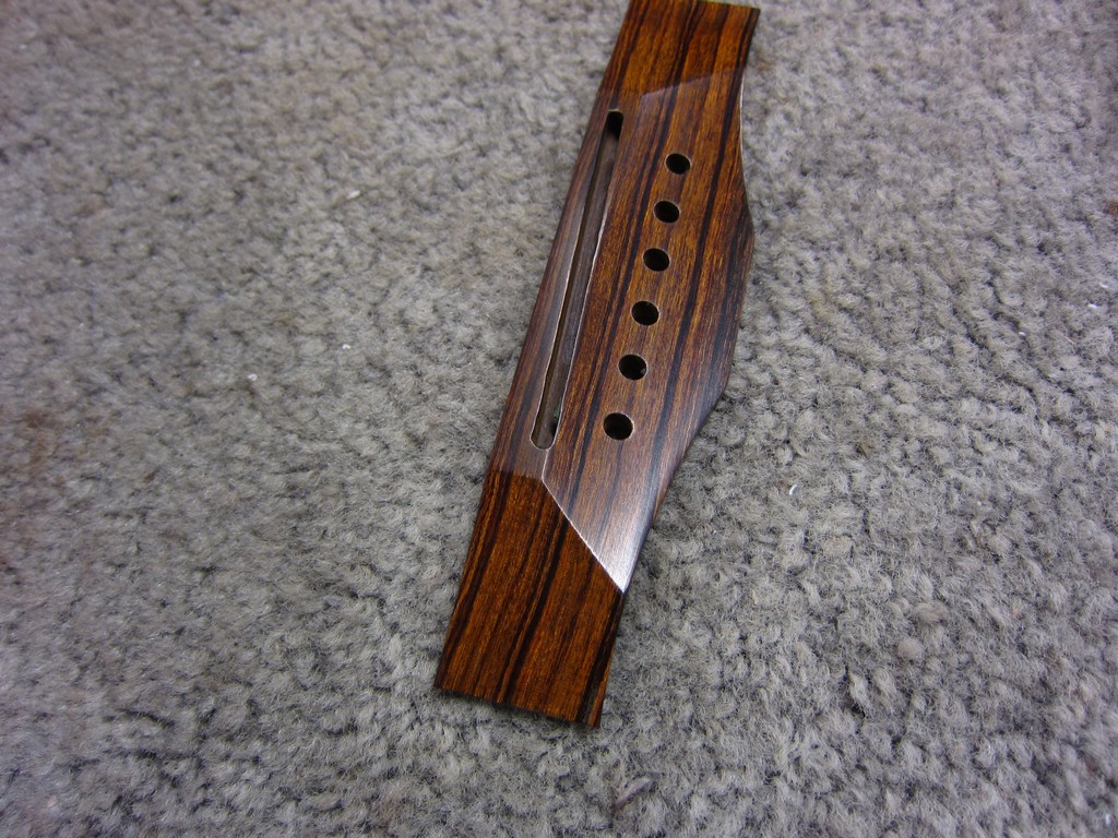

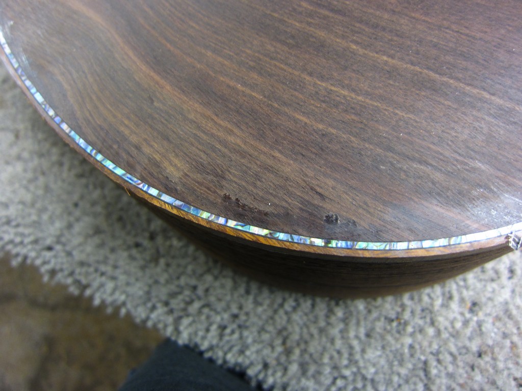

Thursday I wet sanded this one. I'm not real happy with the finish, though it probably is the best so far.
Before sanding:
Part way through:
The bridge after buffing:

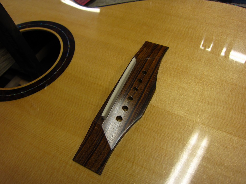

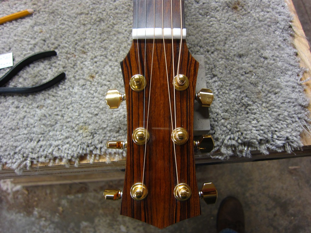

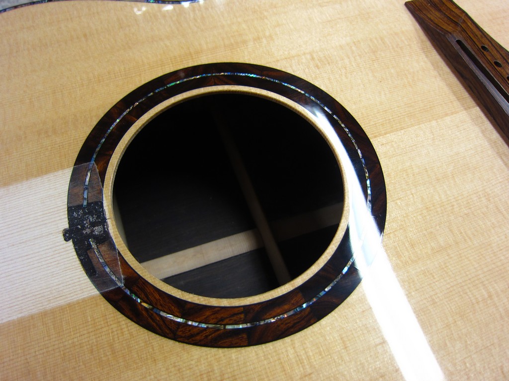

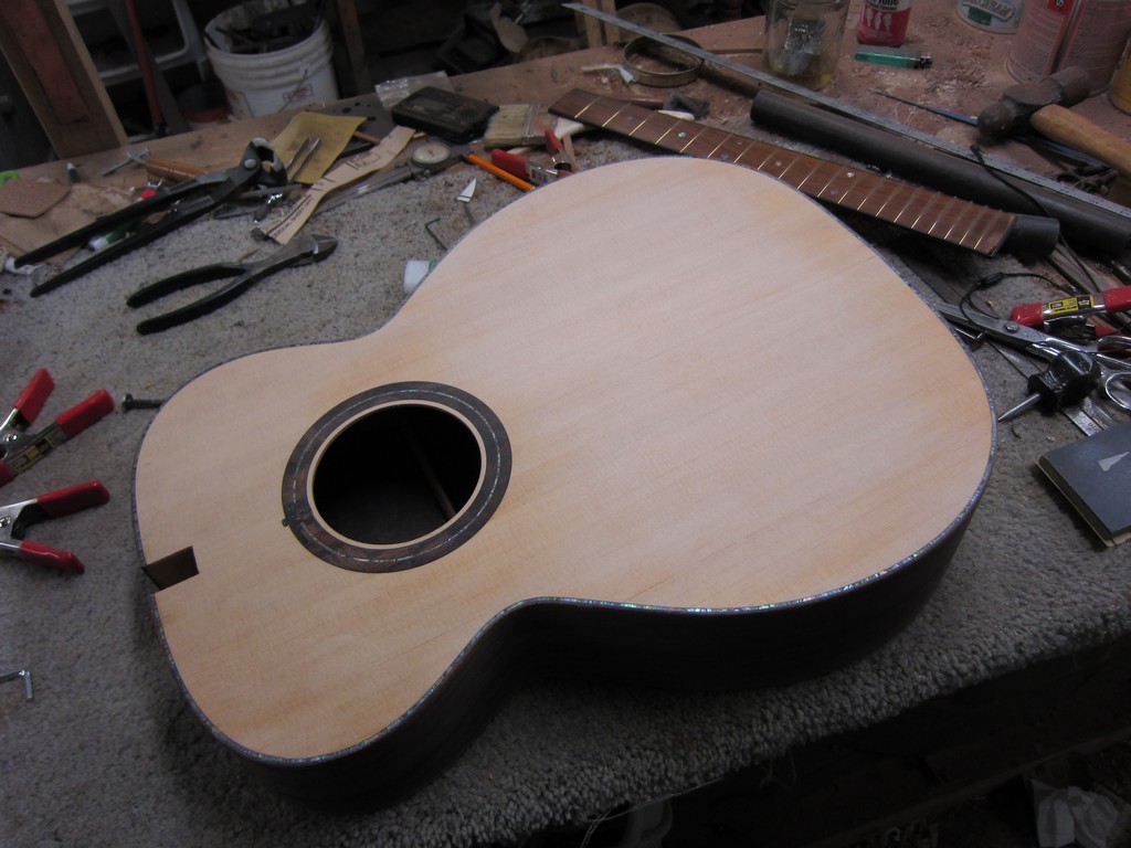

Got the bridge glued on today:
The rosette:
Also glued the fingerboard/neck on:

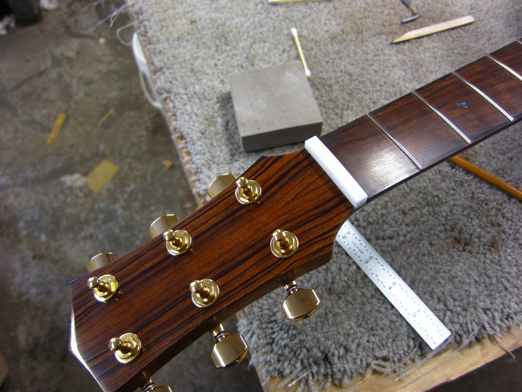

The tuners installed:
And while the glue is curing, I got the saddle and nut ready to start setting the action:

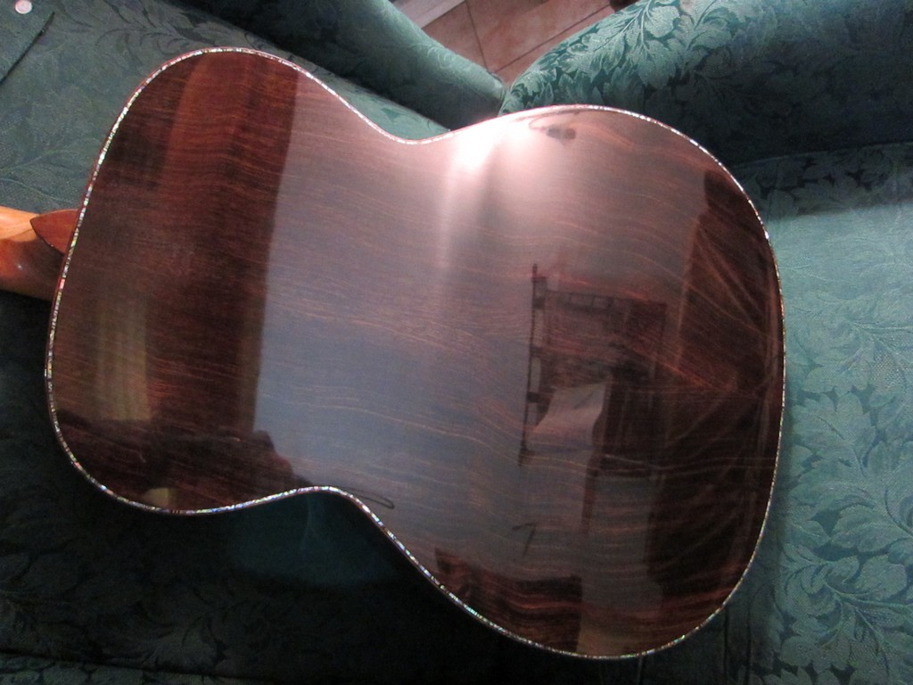

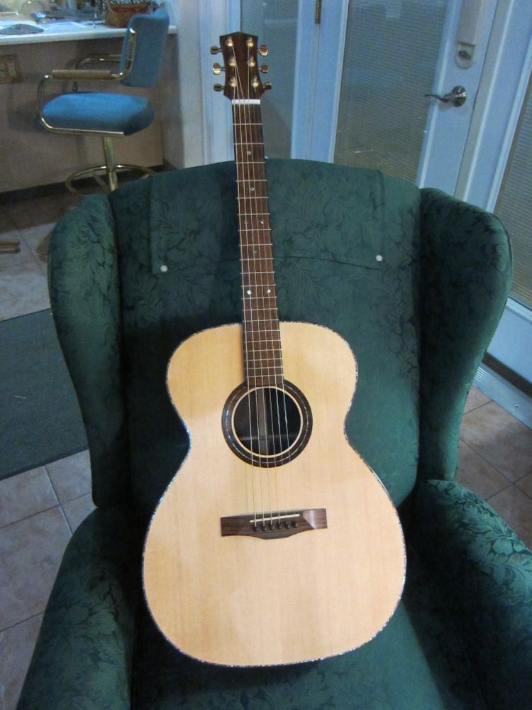

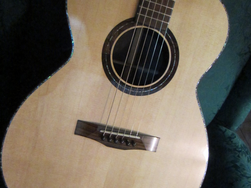

The finish looks good in the photos, but in person, there are some definite flaws. Hopefully nothing I can't fix though.
Here's the last of the in-process pics, and some finished pictures, but I'll try to take some more in better lighting:
It's not 100% done, I have to finish the nut, fine tune the action, and fix those cosmetic blemishes, but it is playable, and sounds great!

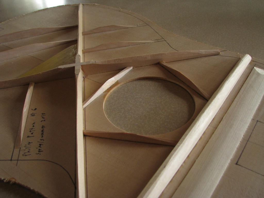

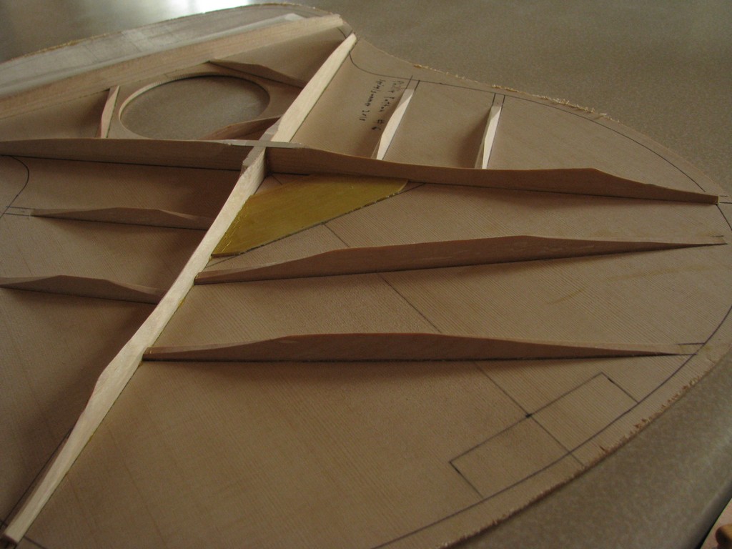

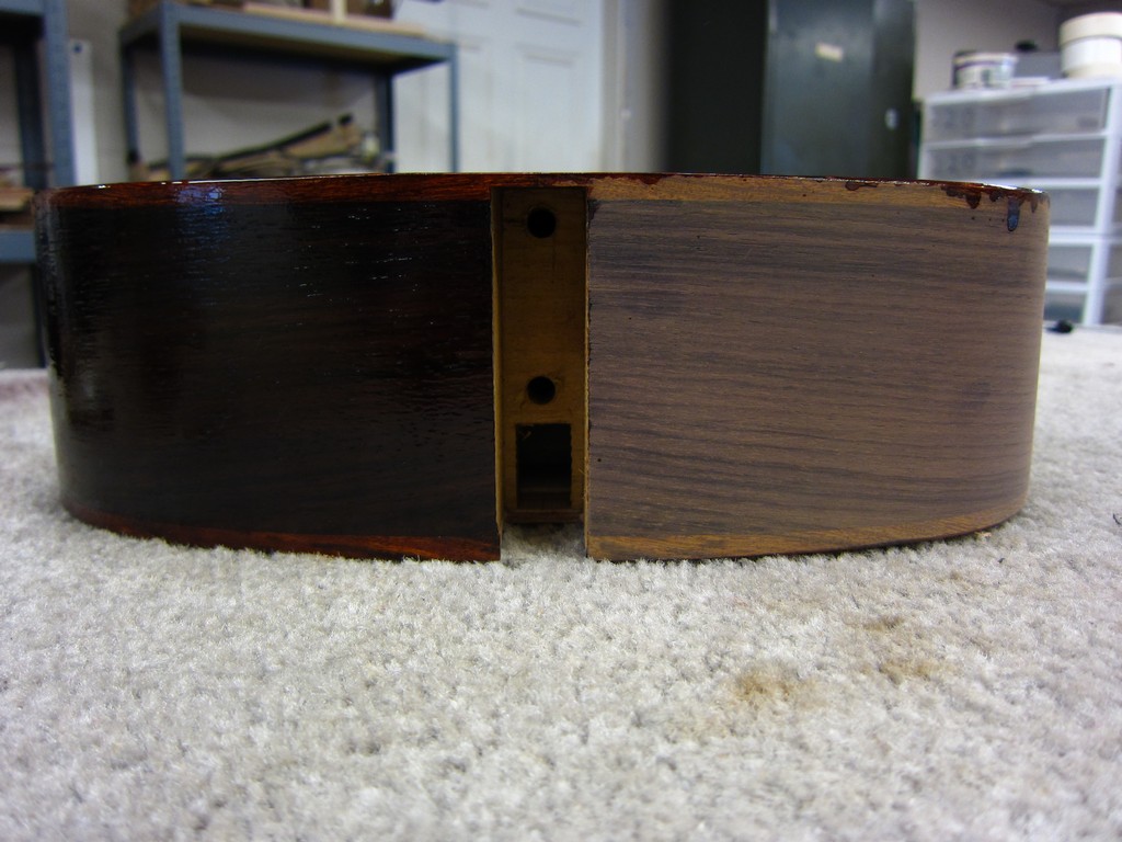

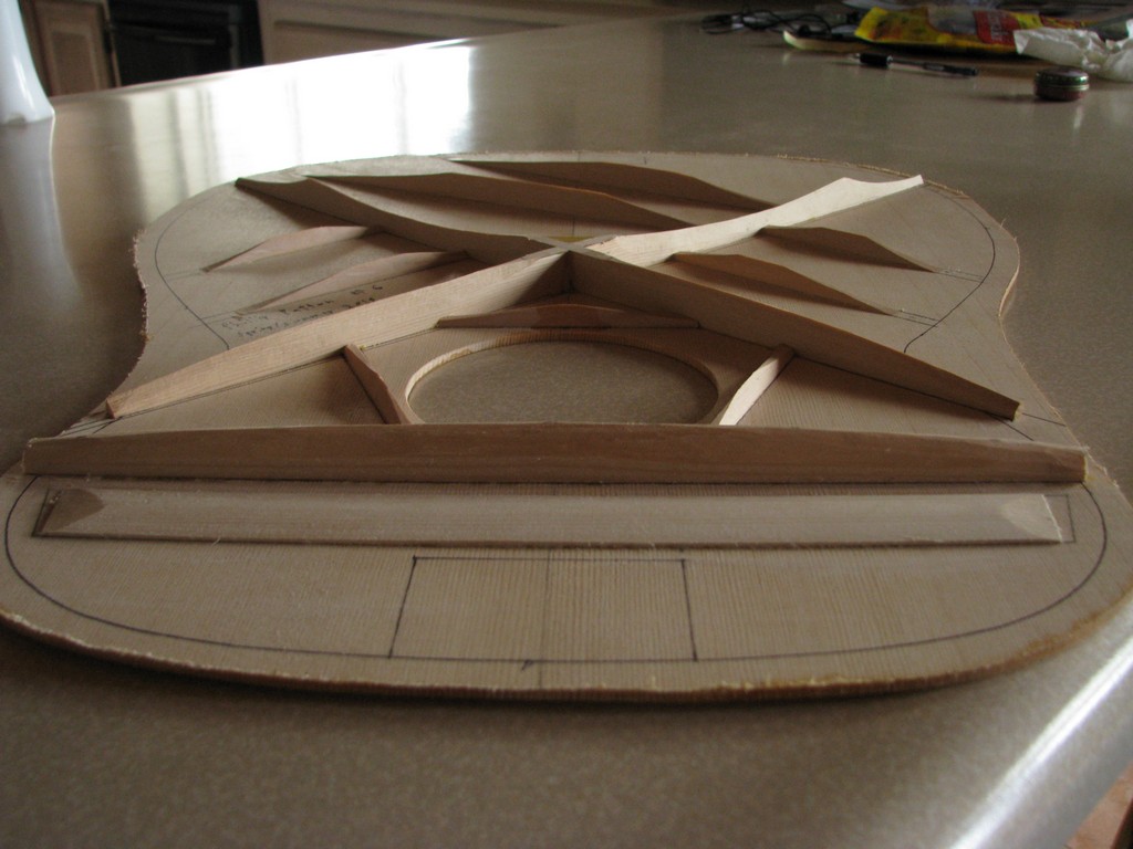

Well, I was just going through some folders on my computer, and found some pics of the bracing I forgot I had. So here they are:
And yes, I did cap the the X before closing the box. ;)
This is by far the best sounding guitar I've made. I hope I can duplicate it. :mrgreen:

Beautiful guitar! What kind of Zipflex is that and what size? Paua Blue?
Scott
Thanks!
Yes, this is the blue paua, and I think it's the .064" size.

It looks thicker than the Rossette so you are probably correct on the 0.064" size.
Thanks.
Thanks.
Yep, I've checked, and it was the .064". I wouldn't go wider with Zipflex because of the really tight bend at the waist.
