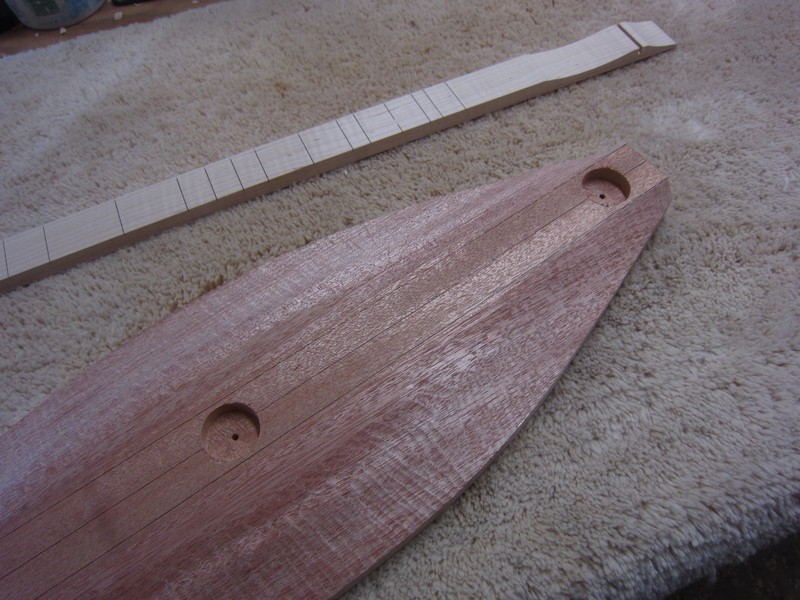

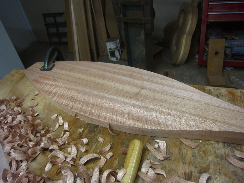

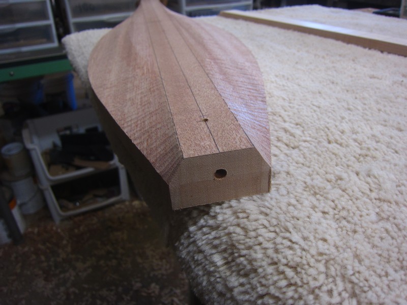

Because I didn't have any mahogany big enough, I glued up multiple pieces.

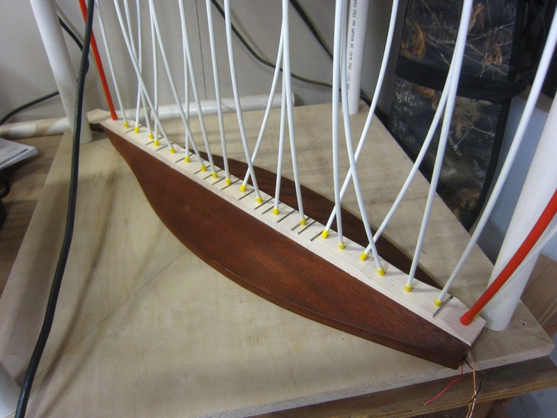

Most of the electric dulcimers I came across while researching this, were made by taking a board and attaching the components. I wanted mine to be a little more elegant than that, so I carved the top:
Then I drilled some of the holes that will be needed for wiring:

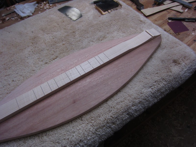

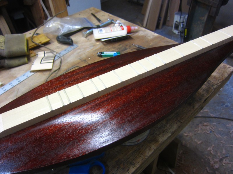

Here it is with the fingerboard in place and after sanding the gouge marks off:

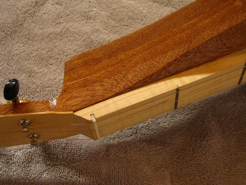

Here's some more pics.
After the fretboard is glued on, I'll be able to shoot lacquer. I just got some analine dyes from LMI, and decided to use them on this project.

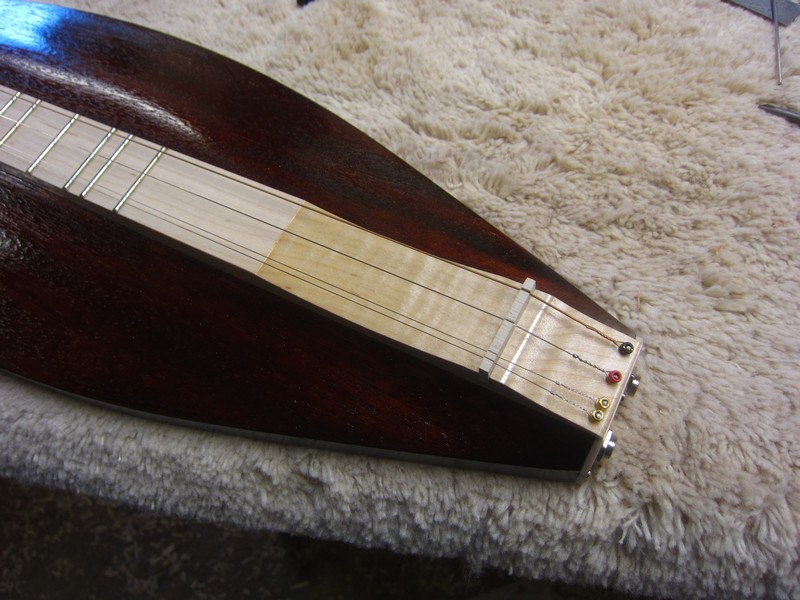

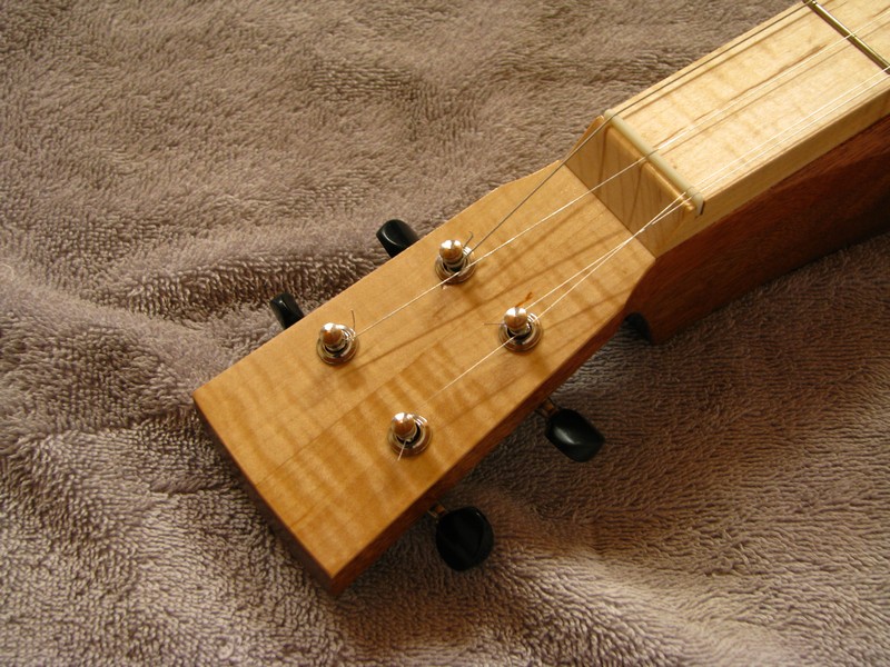

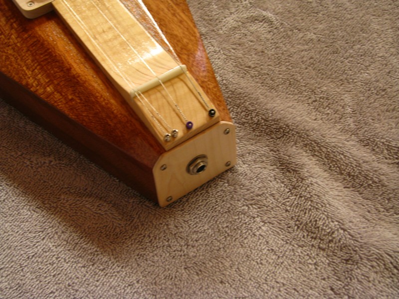

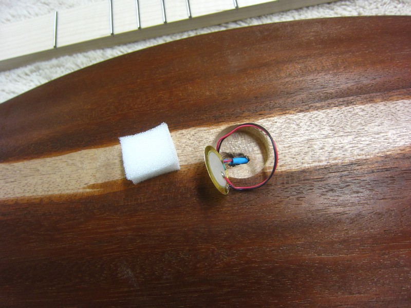

I guess I forgot to say, that the pickups I'm using are actually piezo buzzers from Radio Shack. http://www.radioshack.com/product/index ... d=2062402#
The price is right, and, now that I've got the thing finished enough to try it out, I know that they work just fine. bliss More on that later.
I removed the piezo elements from their plastic cases.
I used a 25" scale length, because I wanted a more compact dulcimer. The acoustics I've made had 28" scale lengths.

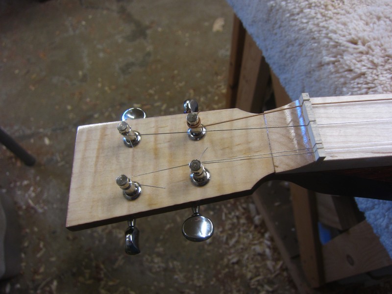

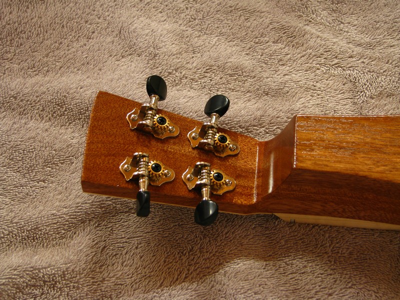

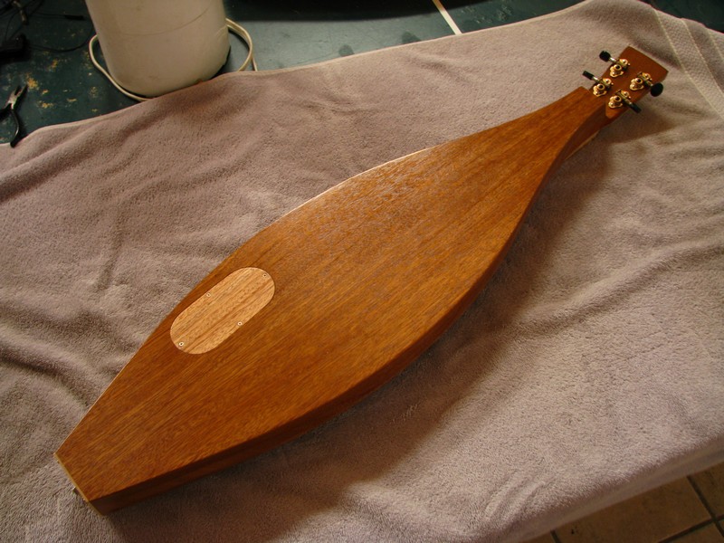

Final round of pics:
I ended up not using the switch because there was not enough room for it. Instead I just used two jacks, one for each pickup.
Turns out both pickups work equally well. The only difference I can detect is that the pickup under the saddle picks up more of the higher frequencies than the other. Which was predictable. Both sound good though. I will try to record some clips.

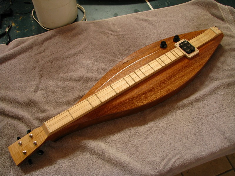

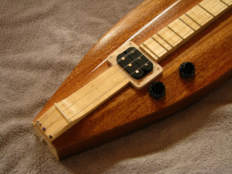

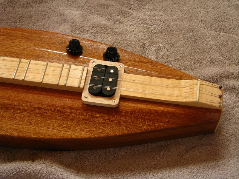

I like this one more, though. I just finished it a week or so ago. It uses a single magnetic pickup, and no piezos. I made the pickup myself. It's all mahogany and maple.
