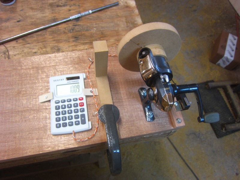

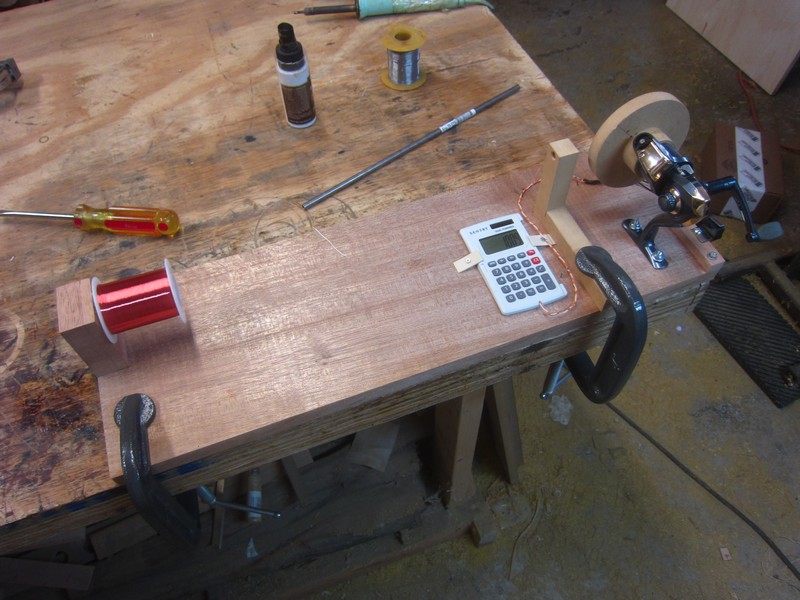

Here's some pics of my setup:
I got the calculator at Menards for $3.50. It has the "real" circuit board, so was easy to solder.

I saw a simple set up once, similar to the photos but with a single cog on the edge of the wheel. The cog would hit the = key on the calculator each revolution. Just enter "+1" and start the wheel. Each time the cog hit = it would keep adding 1. Pretty simple tech but it worked.
