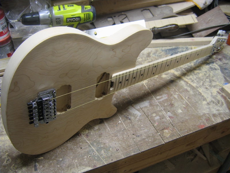

Hello all. I'm new here and just getting my feet wet in building. I've completed a carved Tele and I have 2 carves under way and thought I would share the process I use. I use an overhead router to step the edges and then I carve using a curved sole Ibex plane. There are faster ways, but I like the control of the small plane. I can rough carve a top in about an hour...depending on the carve.
Here are some pics and links to the build threads. I'll be moving these threads to OLF soon.
