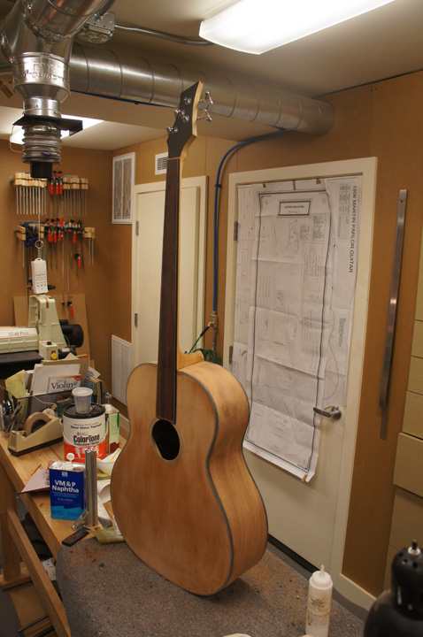

I building an acoustic bass with a fretless finger board that I sloted and filled the slots with black fiber. Given that it is fretless, are the side dots still placed in the middle between the slots like a fretted guitar or are the side dots placed closer to where the notes should be. I just want to make sure that a player will find them where they are expected.
My first thought is to put them right on the harmonic line. Where the 3, 5, 7 9 12 ... frets will go.
Thanks for any insight.

I ended up with small side markers just where the frets would go for 3, 5, 7, 9, 12. That will at least help me.

I have not played a guitar fretless. The guitar I am building is a very large acoustic bass from Mark Stanley plans.

Most people put the side dots on the fretlines at 1-3-5-7-9-12-15-17-19-21 etc. I put fretlines for every fret and dots in the listed sequence, or triangular markers depending on the build and the customer. BTW this acoustic looks awesome
