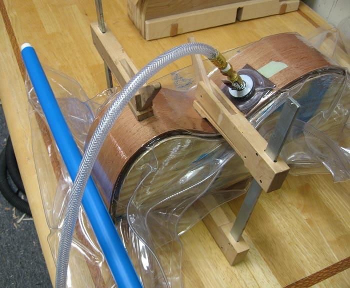

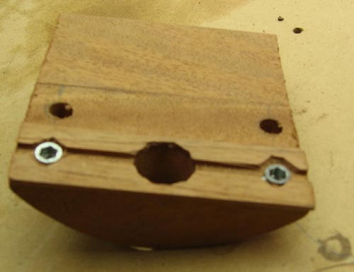

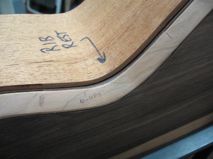

First off I made the side template, which is made of two pieces of mahogany bent in the side bender and then laminated together on a mold in a vacuum bag. The template actually sits atop the actual sides on the mold. I laminate my sides using vacuum as well; this makes everything nice and stiff and everything fits together quite well which is absolutely key. Here is the side template being glued up:

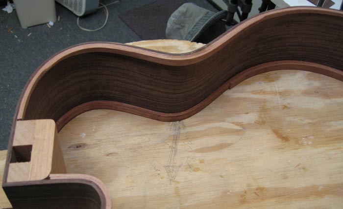

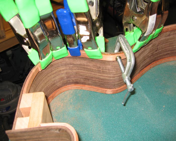

Next up I added an extra strip of lining to the sides where the bevel and ribrest would be. I just bent a couple extras when I bent the linings in the first place.

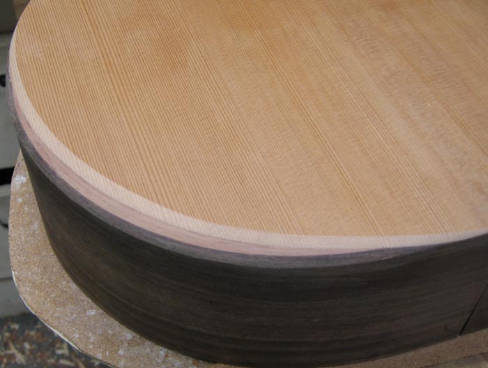

Once the top/back were attached, I dug right in and rough cut the bevel with chisels and a rasp, going a little deeper than the final bevel to make room for a veneer overlay which will match the bindings.

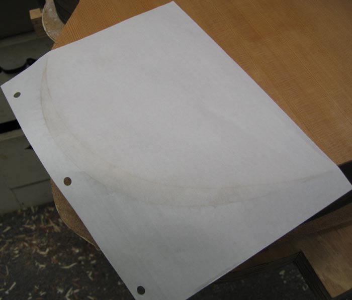

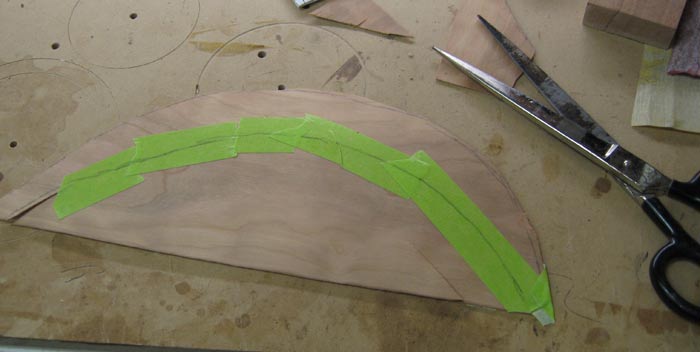

Once roughed out, I rubbed a piece of paper on the bevel to get a flat representation of the 3-D shape of the overlay (it helps to have dirty hands for this job):

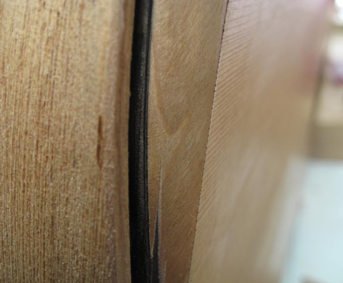

Next I transferred the shape to my veneer and cut it with scissors. I put tape over the cut line for support to keep the veneer from splitting down the grain. Ask me how I know to do that... :oops:

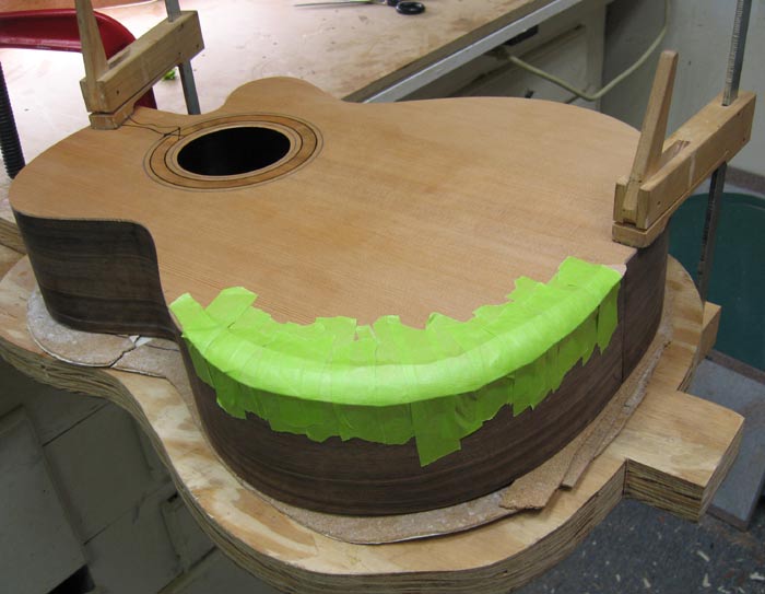

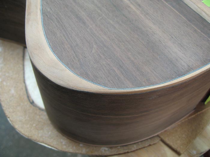

Next I glued the overlay, taped it on, and cleaned it up:

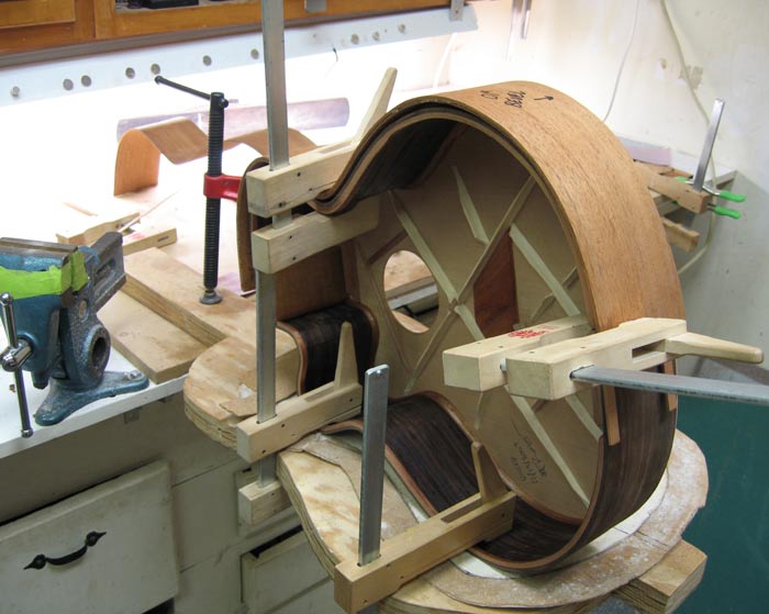

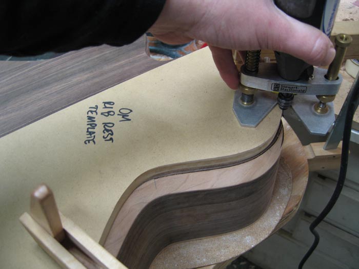

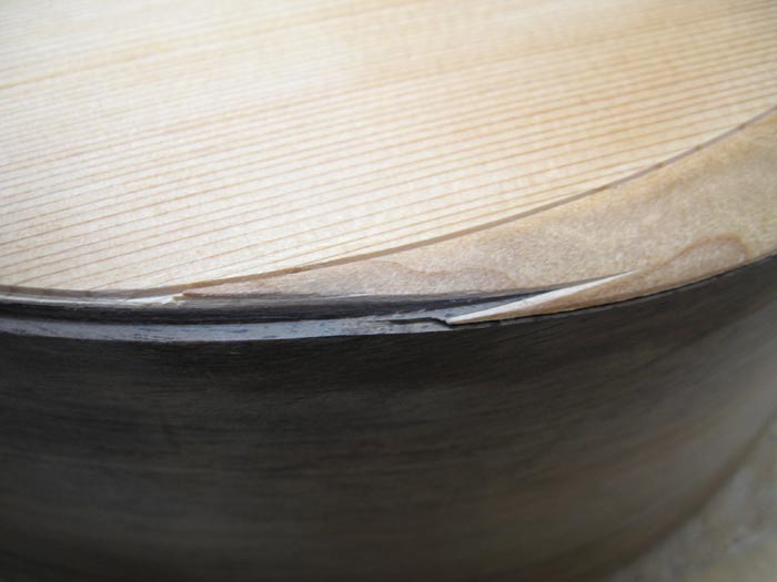

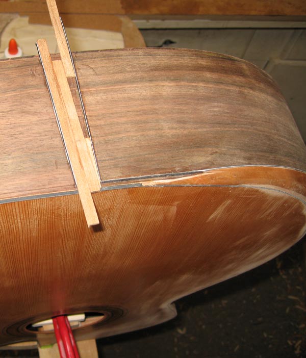

Next comes the heart of the system. I clamp on the templates as best as I can and route the purfling channels. I used a dremel with a 1/32" spiral bit, using the shank to register against the template. You have to keep the tool moving at a reasonable speed or you will burn the template. On the dry run I used a laminate trimmer with a guide which should also work if you're concerned about using the bit shank as a bearing. I was really wanting a Cochran plunge base for this operation!

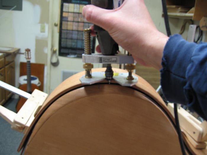

For the middle of the ribrest, I cut as much as I could with the stewmac base:
and made a custom base to cut the convex portion:

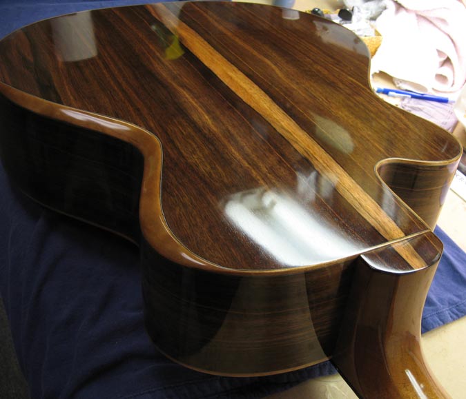

Once the bindings are glued in everything is cleaned up and it's finished:
Here's the finished guitar:
