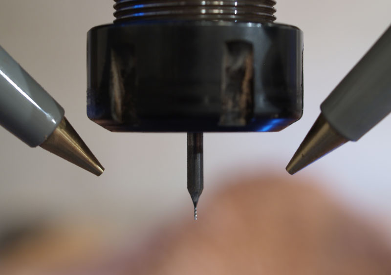

I've been doing some fret slotting in ebony and rosewood and I'm also writing a short article about the process with RM Mottola. I just wanted to see if anyone else was slotting, and whether they'd be willing to share info about feed rates, etc.
My machine is a sturdy DIY machine with a heavy aluminum frame and a 2.25 HP PC 892 on it. Steppers, ballscrews, linear rails, vacuum holding for parts.
Based on the Onsrud datasheets and the RobbJack Calculator, I've been working in the feed rate range of 12-25 IPM, taking about .015"-.020" depth of cut, with a .023" endmill spinning at 23K RPM. This gives a chip load/tooth of about .0006" at the higher speeds. No problems at these speeds.
I've seen references to taking full depth (.080"+) cuts at equivalent speeds (25 IPM), but I'm nervous to try this and the forumlas don't seem to support this kind of aggressive work with a small cutter.
Any thoughts or practical numbers for me to work with before I start breaking bits?

Steve I use the .020 and .023 bits for inlay and for fretting, what helps the most I've found is to take shallow passes. There's a trade off on how long something like this takes, I keep my IPM pretty low (down in the 8 -14 range). The big trick John taught me was to try and keep the slot clear so the bit does not overheat, I run a huge dust collection system and have a full dust shield built into my CNC machine to help as much as it can.
Regardless... I still break them more than I would like, I think it just comes with the territory :)

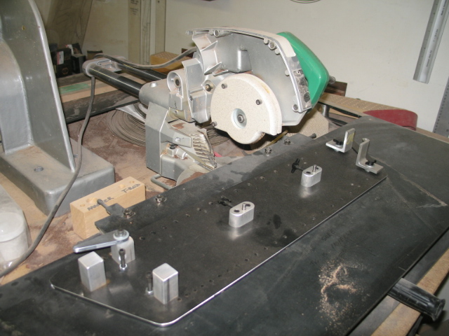

I've cut slots manually and on the CNC.  For production I've gone back to manual. Total time on the manual machine is about 1 minute.  On the CNC 15 minutes or so.
It sounds like my setup is similar in concept to Rick's Alembic machine.  Although I bet Rick's was a lot more robust.
Mine's made from a Hitachi sliding compound miter saw.  The blade's a HSS hollow ground screw slotting blade.  It's probably done 500 necks or so and still has lots of life.  I machined a corian blade guard that doubles as a depth stop, tracking over the pre-radiused fingerboard.  The sub table and neck fixtures are made from laser-cut 1/4" steel.  On the sub table there are two indexing pins directly under and inline with the blade.  The neck fixture has a hole and a slot for each fret slot that locate on the table pins.
The neck fixture holds the neck during 3 processes, radiusing the fingerboard on an edge sander, cutting fret slots on this rig and routing the nut slot on a pin router.  The cost of the last fixture was about $50.00 for the laser work plus a day's labor on the bits and pieces.
