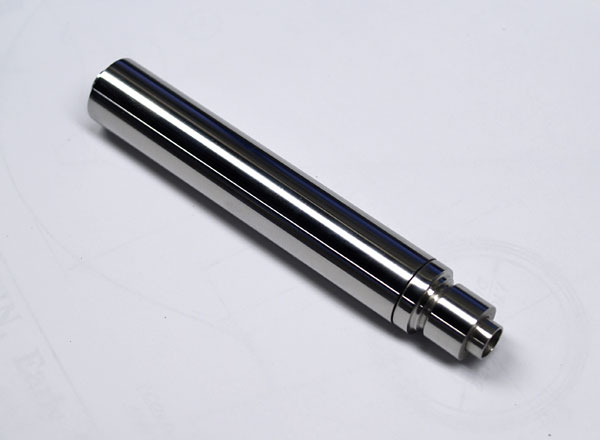

I heard back from Richard. Apparently, I received the right spindle, but with the wrong finish. It had the palm sander type finish of his aluminum models. From his response; "The batch of stainless I received had scratches too deep to bring the body to a high finish"
So, I just polished it up myself. Here it is.

Looks good. Nice polishing job.
So how easy is it to change cutters?

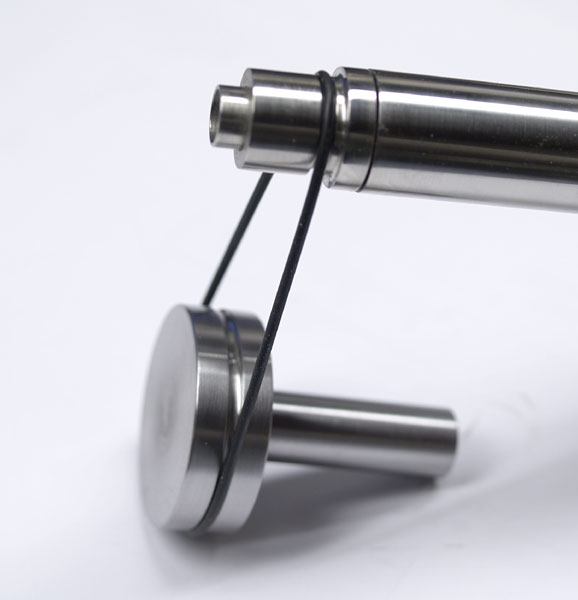

I finished my pulley. The ratio is 1:2.777 giving me 50K rpm from 18k rpm. It'll be a while before I have time to try this thing out, but I borrow time at my buddy's machine shop for stuff like this, so when the machine is available, I jump on it.
Here's the pulley...

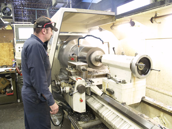

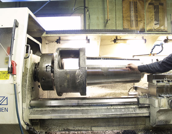

And just for fun, here's the machine we did it on....
think it might have been a little bit of overkill?

John, are you chucking that into another spindle or router? Nice work!
I think the lathe may have been a little undersized for that part though...

I got mine in the mail today. It too has that "palm sander" finish, which I will wet sand and buff out to a nice polish.
One suggestion for Richard is to include a simple piece of paper to explain the workings of it, and also include an allen wrench, which I assume is how it tightens down on a bit? Without instructions, I'm a bit clueless about how to use it.
It's a tiny little thing, but I like it. It seems perfect for inlay work, and with triple ceramic bearings, it can probably handle that task nicely.

Don, yes I'll be putting it in my spindle.
I wouldn't wet sand it. Water will destroy it.
The allen screw draws the collet inward, tightening it. It's basically a two wrench system like any router except there's only one wrench. You have to grab the housing with a pair of pliers in order to get it more than hand tight. A couple of flats on that housing and a stamped wrench would help a lot, but that's a lot more work on something that has to be well balanced. When grabbing both parts, the collet can still just spin in it's receiver, so if it's not loosening, that's why.

Yikes! No wet sanding... thanks for the head's up on that.
Won't you need some extra Z height to mount this and use your spindle to drive it? Then again, it's not that much with this being so small. I guess you would just re-adjust your Z-zero with this?
