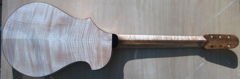

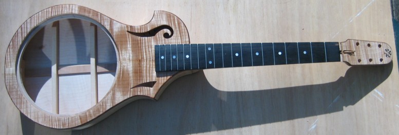

As there's not much going on here, and to celebrate the fact that the image upload has been fixed, here's that odd-shaped reso now it's a bit more together.
Pete

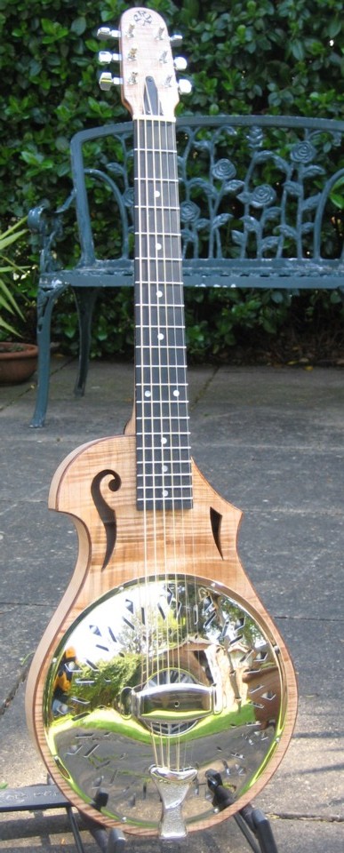

... and it's finished at last!
Pete

Brilliant as usual Pete. What a combo, a travel
'dobro' with a chicken-foot cover and Allen tailpiece!
Who's cone and spider are you using?

Sorry, guys, been a bit too budsy to do much web browsing lately. There's a sound clip at http://www.petewoodmanguitars.com/shared/BR_002.MP3, which I did as soon as I strung it up. It already sounded different the next day and that ring on the 1st string disappeared without my having to do anything. If it's like the others it will develop more depth of tone over the next couple of years.
It's a travel guitar so it uses a 9 inch dobro-style Quarterman mandolin cone - they don't sound like a full-sized dobro but it's still an interesting sound. In fact the squareneck version sounds a lot like an old tricone.
The spider is a mandolin spider from Paul Beard - they're not on the website but they still sell them. The bridge is offset so you have to think about the scale length a bit. I wish they'd make them with the bridge in the centre like the original Dobro ones.
