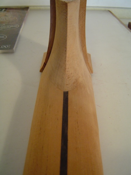

I use Spanish cedar nowadays for my classical builds. I can't always find it well quartered, but I typically insert a strip of flatsawn ebony (about 1/4" x the thickness of the neck wood) between the two pieces for additional support. Being flatsawn, when rotated 90 degrees, it becomes quartersawn, so it works well as a stiffener.
When the neck wood I use is off quarter, I do this with the two pieces (seen in cross-section):
top (fretboard)
bottom
The way I see it, having the grain oriented in this fashion actually helps with the overall stability. Thus far, it's worked well for me.
Best,
Michael
Michael McBroom39075.831412037

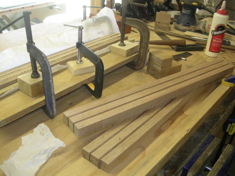

PostPosted: Mon Dec 25, 2006 10:08 am
Like this Michael?
