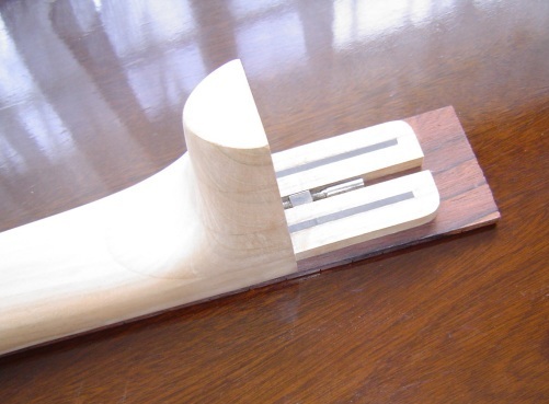

I don't glue the extension to the top, never saw the point of that on a bolt on, I glue the fretboard extension to an extension of the neck and rout a pocket in the top and neck block for the neck extension. This way the fretboard is attached to the same piece of wood along its entire length so can't develop a ridge. If I have to sand a small part of the top to get a flush fit I do but normally the 25' radius puts me right on the money.
