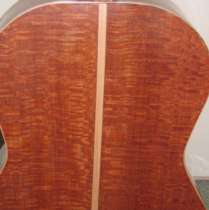

Yep I've built with it. It was splintery, but the tone was awesome!! Very
robust powerful voice.
Here are a couple pics:
