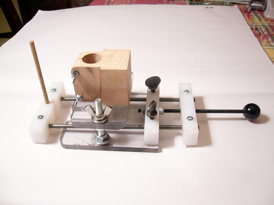

Grant, I use downcut bits in my lam trimer with this.
There has been lots of recent discussion on circle cutters. Mine is based off one that Tony Karol posted a while back.
Take a look here for several topics on circle cutters.
Sylvan Wells just posted a tutorial on how to build one of these things. It is very easy, quick and offers micro adjustments. You can't go wrong. Cost for materials is under $10, just have to have a laminate trimmer, which is sounds like you have one. So you just need the bits.

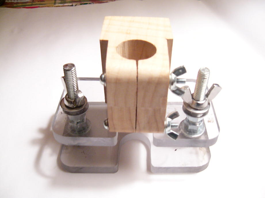

Talk about form following function! Nice design Terry. I like it. I just scavenged materials together for Sylvan's model. Now I'm not sure which way to go. Maybe some hybrid of the two.

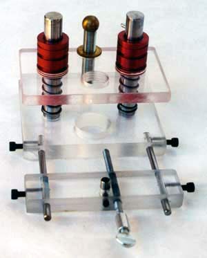

This is the one I made from a GAL Redbook article. I use it with a Foredom -- it can be made to work with a dremel.
I made a seperate base for that can used for cutting inlay pockets freehand.
PostPosted: Sun Dec 17, 2006 7:30 pm
Posts: 2711
Location: Victoria, BC
Last Name: Abercrombie
Terry-
Very elegant jig.
Which model PC laminate trimmer/router is that?
I notice it is unusual in that you can completely detach the base, and still retain the factory depth adjustment.
That's a nice feature- not common in the ones I've seen.

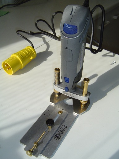

Like Hesh, I too use the Stew Mac base with a Dremel, I use the newer circle cutter base and a 400 series Dremel. The runout on the older Dremel seems to have been solved with the new one, and I'm more than happy with the results. I too use the Stew Mac downcut bits and also LMI end mills. As I'm only cutting 1.2mm deep slots in spruce or WRC I have never felt the need to use a 1hp laminate trimmer for the job, even if the dial does go up to 11.

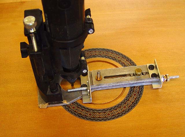

Like I said I use the StewMac base and a dremel or my Foredom, but one thing that keeps coming to my mind and has finally driven me to a new bout of NTAS (new tool acquisition syndrome), and that is not being able to see both edges of the channel clearly. I could build a new base out of lexan but have decided to enable my affliction of NTAS and buy this puppy.
This should scratch my itch for the rest of this year MichaelP39069.7153240741
