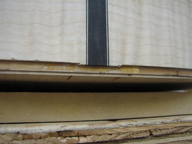

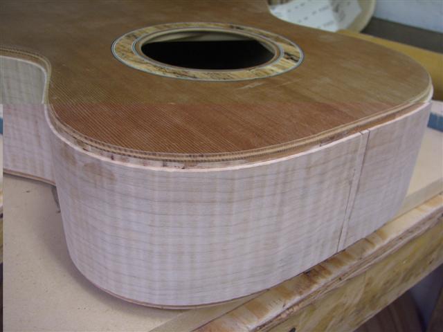

Well it's been awhile since I posted some progress pics so I thought I would take the time to take some pictures while in the shop and let you folks know where I'm at.
Finished up the top bracing, first time with hide glue (a little bit messier than I'd like but I'm ok with it)
Than glued it onto the rims, also with hide glue (ran down the inside of the head block pretty good so I had to clean that out )
It went very well. I didn't stress out about it, knowing that I could have just taken the top of and re-glued if it didn't seat all around. But it did and I'm glad to say that the hide glue worked great.

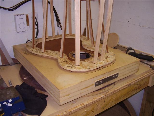

Next it's onto the binding. Now, I had already bend the ebony bindings and they came out great.

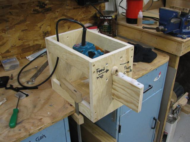

So I cut the binding channels using my rough and dirty binding jig
getting it set up sometimes takes a bit, but this is where we learn some more patients

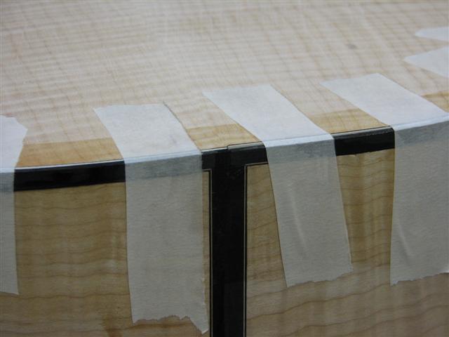

So, I got all the channels cut. This is the first time I am using side purflings and I wanted to mitre them into the end graft (butt wedge). I followed the Cumpiano method and it worked out fine.
And the mitered side purflings.

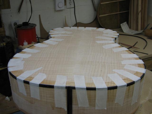

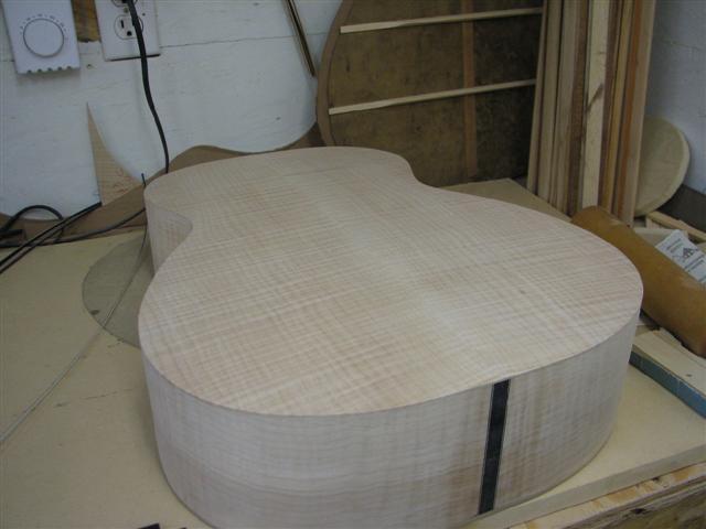

The back is all bound and setting up (I do the CA method, less messy, I like it that way)
Thanks for looking. Onto the top and than the neck.

Posts: 8558
Feed me -- poop chute!
That that you dont see every day on a tool
Lookin good Rod!

[QUOTE=LanceK] Feed me -- poop chute!
Lookin good Rod![/QUOTE]
This is so I run the body through the right way

Rod I too chuckled at the labeling of the feed direction on your binding channel jig.      Whatever works right!

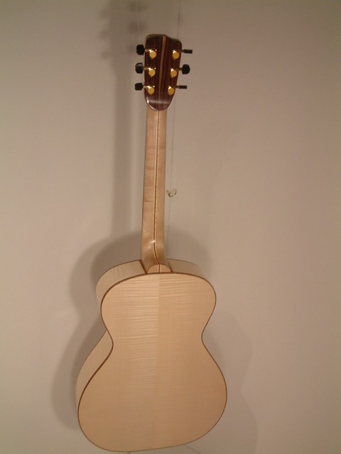

On my cedar/maple I used English sycamore for the neck which weighs about the same as mahogany:
Thr ebony binding on Rod's looks great. Curly koa works very well too.Dave White39073.5469675926

That's my inspiration right there Dave.
Can't make a total clone though

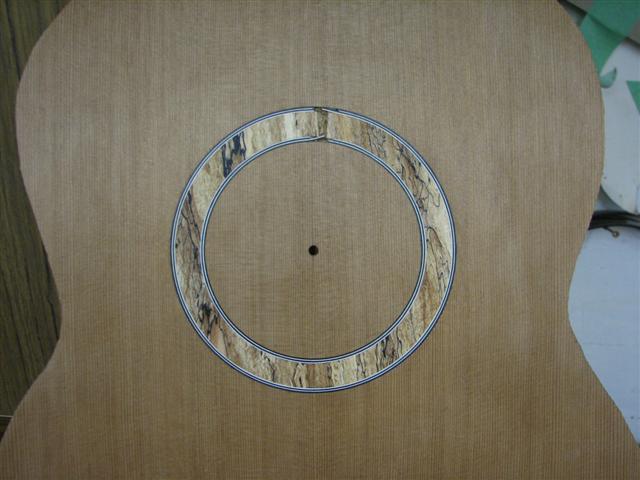

Carlton.....I sit at a computer and give descriptions of houses and reconcile why one house is different than another all day long. I better be good at being descriptive . Thanks for the compliments.
Here ya go Blake. I'm really happy with this one. It's just a ring of spalted maple with purfling lines around inside and outside. I'm using the same purfling scheme for the edge purfling as I did for the rosette, b/w/b/w or opposite depending on the wood it's going against.
